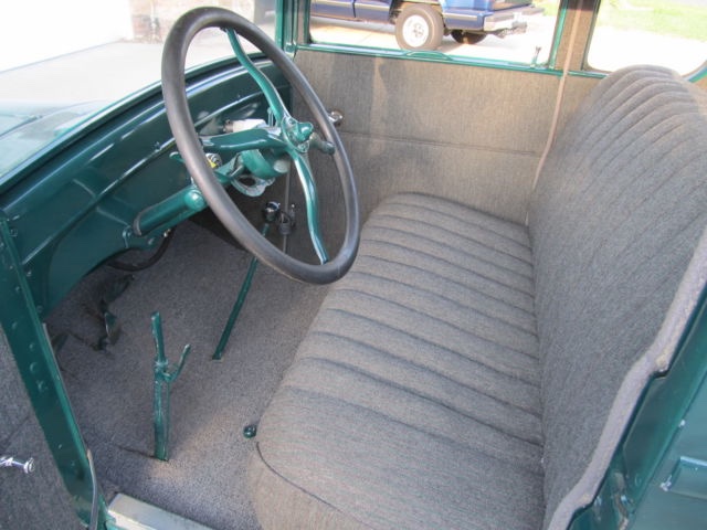

Here is a picture of my unrestored 1927 Tudor for reference to windshield frame color.

John, not sure I can tell from your photo, what color is your tudoor windshield frame?

Re: What color are the trim pieces and windshield frame supposed to be
Post by JohnM » Sun Jan 22, 2023 12:54 pm
You can see what is left of the green paint on the lower body and upper door and windshield post. The windshield frame is clearly not the same color. I believe this car has never been repainted. I don't know if other cars had body color matching windshield frames, but this one is black.
Post by JohnM » Sun Jan 22, 2023 1:34 pm
BTW, the interior trim around the Windows are black also and the dash is green.

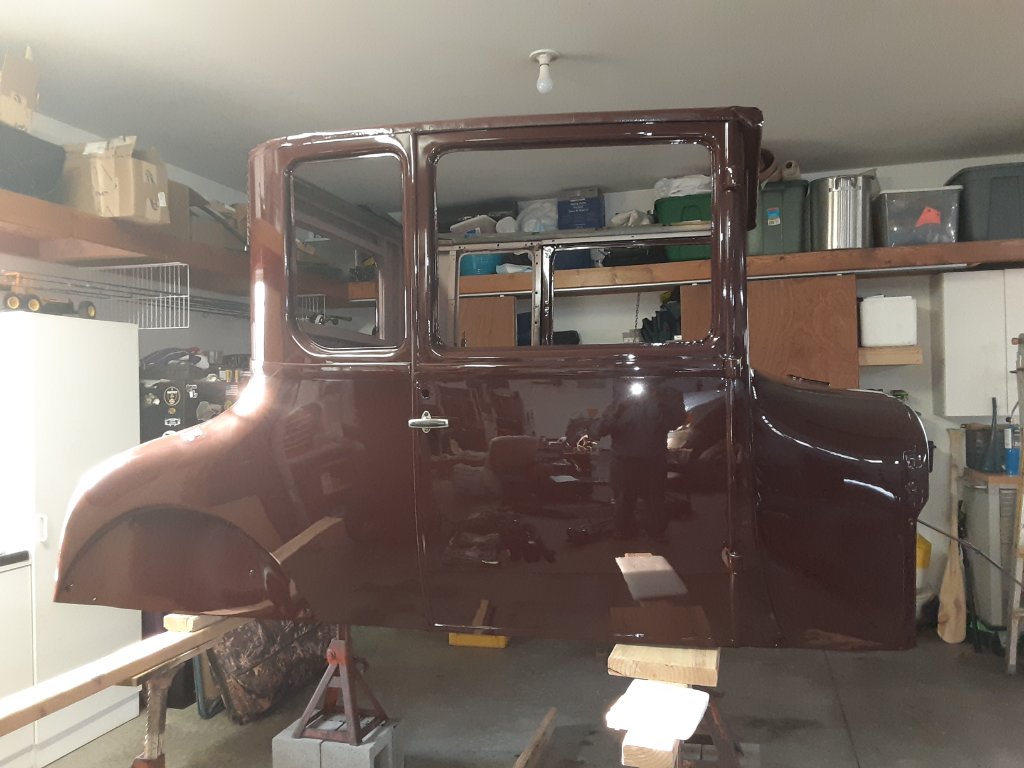

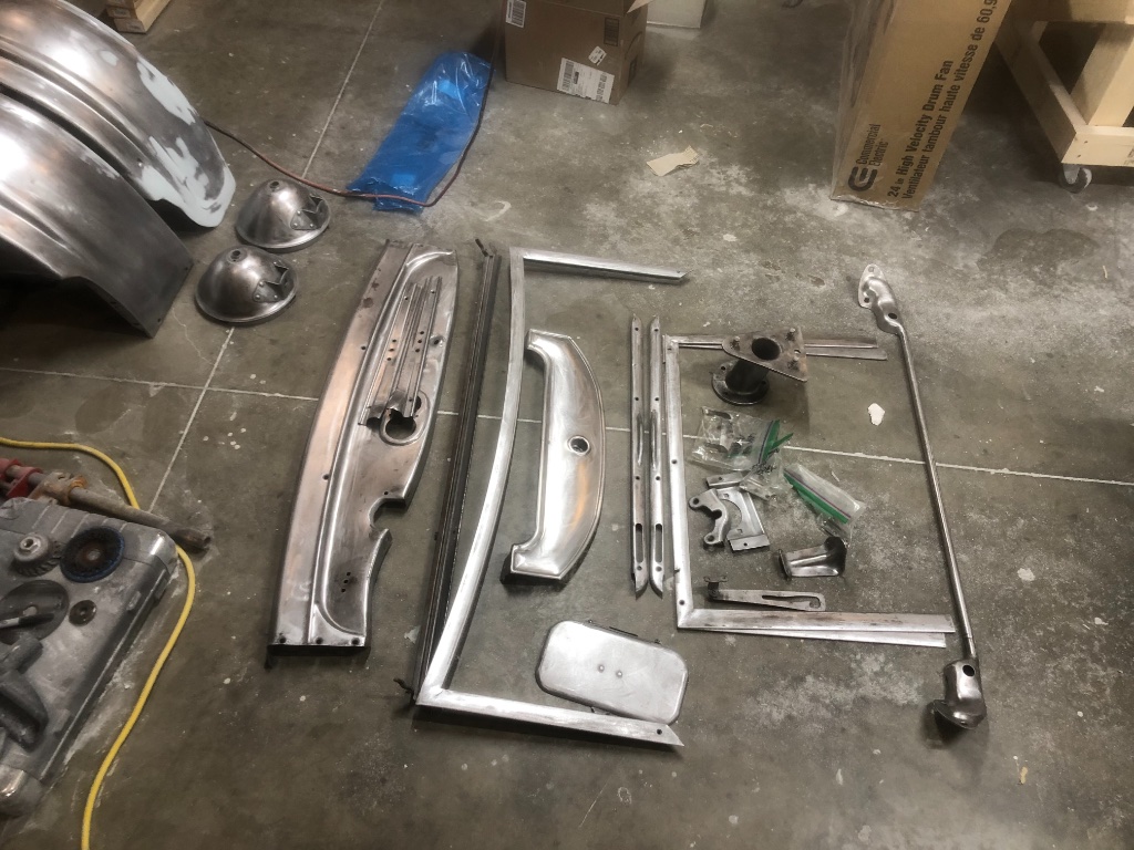

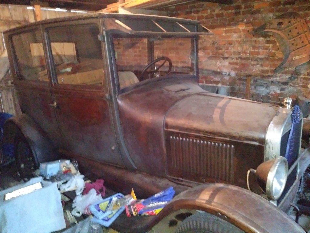

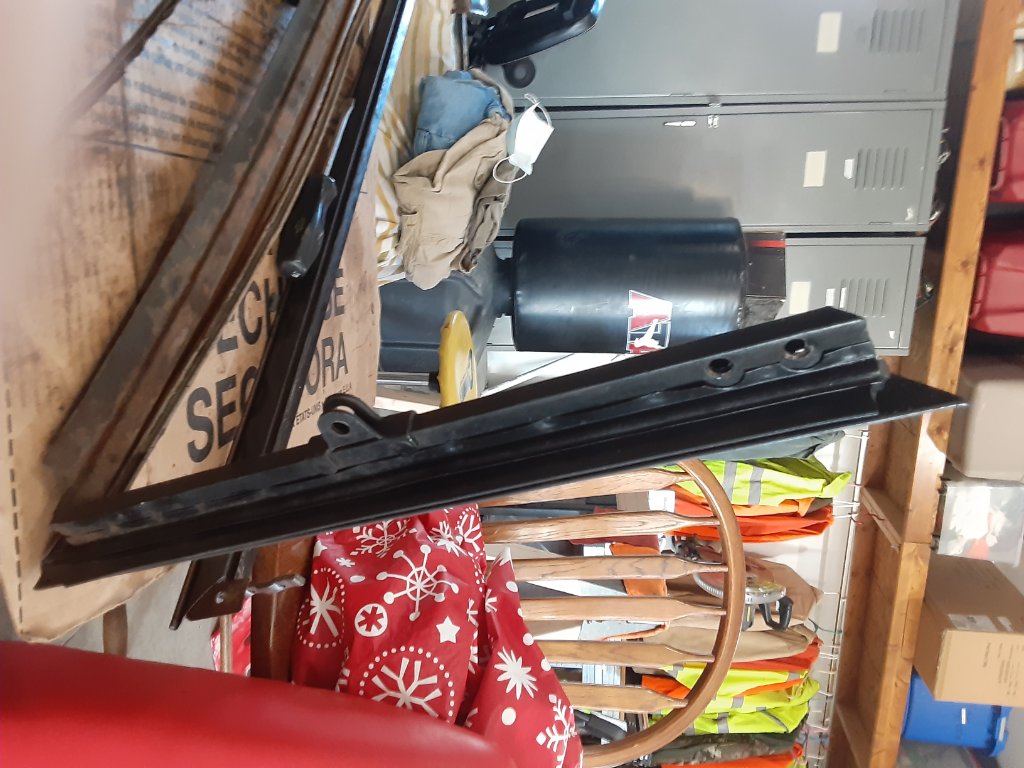

Post by BLB27 » Sun Jan 22, 2023 10:58 pm
Brent, Here are several photos that you asked for. I am not sure what color the windshield frame was originally. I think it was black. The second photo shows it same as body color, but based on the third and fourth, it appears the the back side was black. I assume we painted the front side the same as the body during the repaint.
The coupe was painted in 1954 when I was a junior in high school. Unfortunately, I do not remember much about the repaint. A young man moved from California to my home in North Dakota. He had been painting cars in California so I had him paint it. I do remember the body paint was lacquer. My 11-27-21 11:12pm post, generated discussions about my coupe's original color.
It is now maroon with the windshield frame black and interior window trim black!

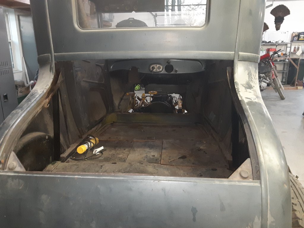

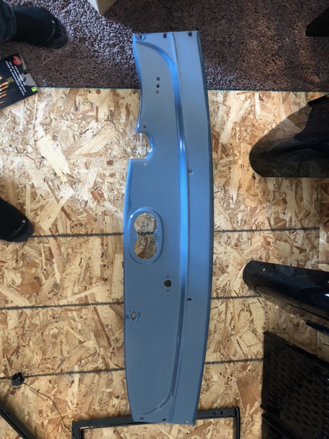

Here’s mine!
Also have a question for you experts out there what are the three holes for on the left side of the dash (see photo) the two outside are square and the middle is round.

Post by Jerry VanOoteghem » Thu Feb 09, 2023 11:50 am
Those 3 holes don't belong there. Somebody added them for an accessory of some sort.
