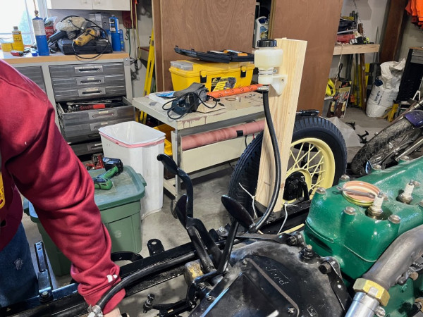

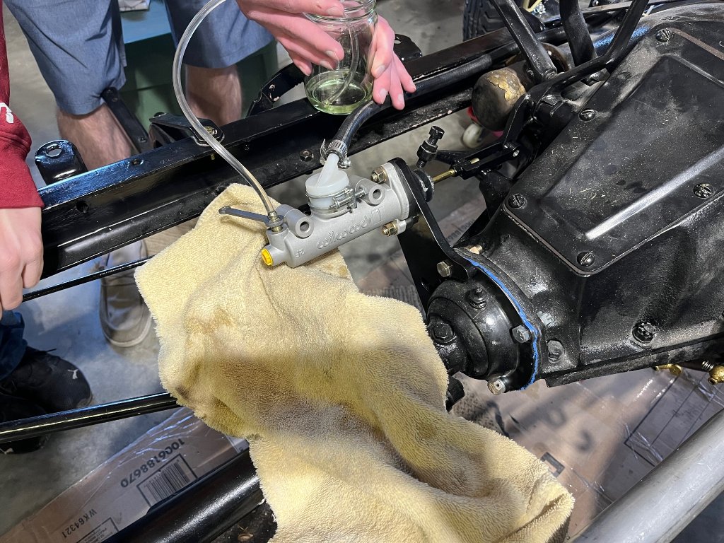

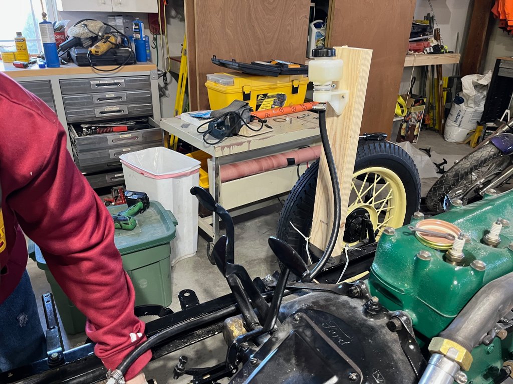

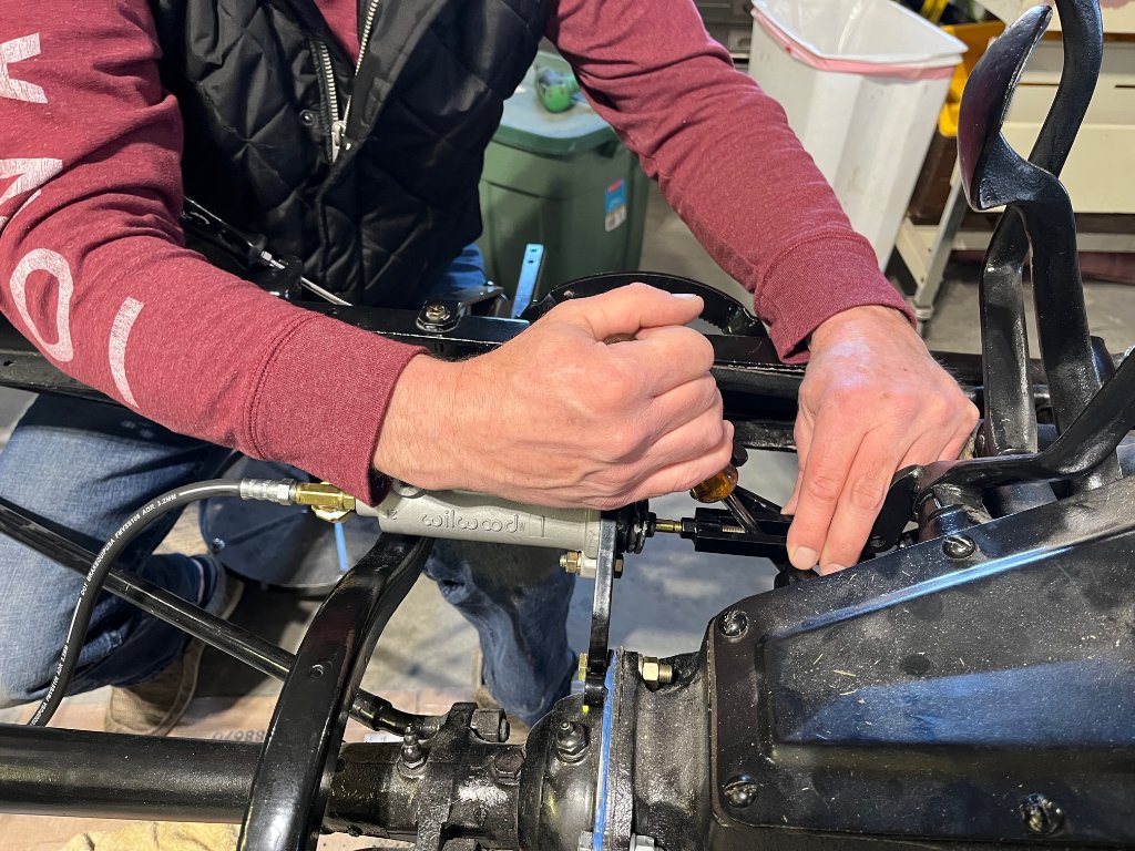

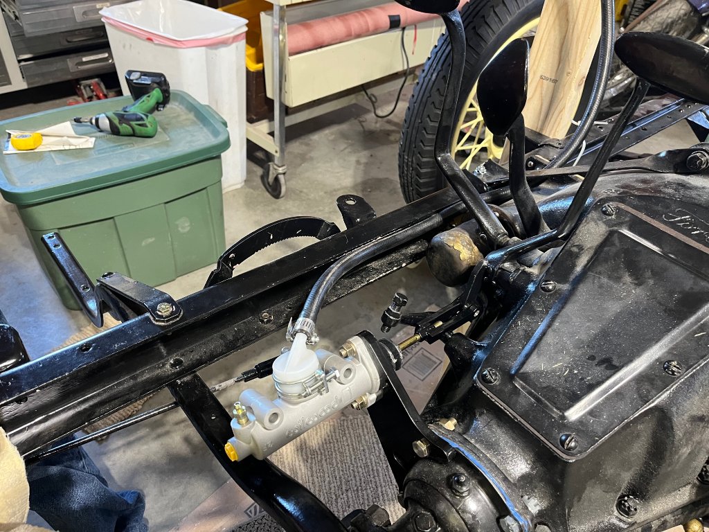

We just bled the "Sure-Stop" disc brakes on my 1927 coupe. This was a first for my son and me. It went very well with some guidance over the phone from Birdhaven (Bill Devine). He has been very helpful with the brakes and other things involved with my coupe restoration.
The first four photos show "bench" bleeding the master cylinder. The first photo shows the reservoir being temporarily supported on a 2x4. The fourth photo shows my son activating the master cylinder. Bill said to disconnect the cylinder rod from the brake pedal so that there is full movement of the plunger.
The fifth photo shows the master cylinder as the disc calipers are being bled. There was some fluid leakage from the rear of the cylinder when the yellow plug (shown in the second photo) was removed and while the main hose was being attached. The leakage was minimal. I held my finger over the vent hole in reservoir cap so that probably helped.

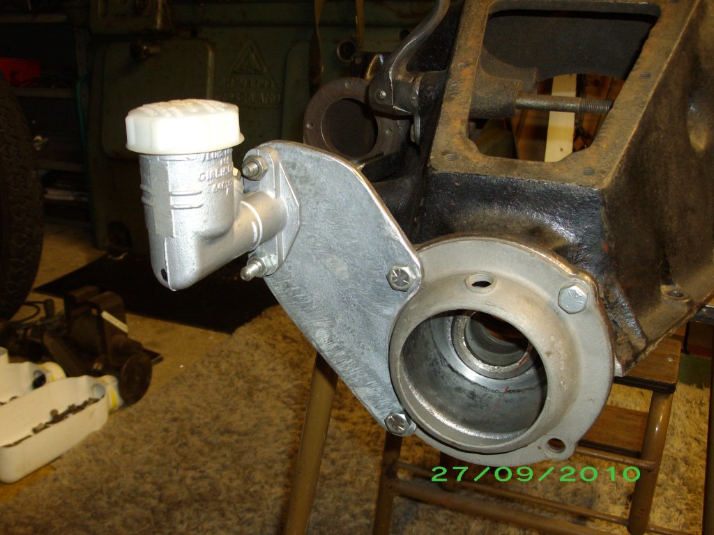

Within the bounds of available friction surface etc via the rear tyres I think improving the Model T braking action is a laudable idea. I should imagine something like this would reduce drivetrain stress as well as hopefully improve stopping distances. However I was curious about at least once aspect of the design:
In looking at the photographs I wondered about the loading on the master cylinder mounting bracket (and the engine rear flange + bolts) when a force was applied via hefty stomp on the brake pedal. There seems to be quite some lever arm there, and maybe only a couple of securing bolts?
A quick search didn't reveal any dimensions of the product, nor full fixing detail, but as I've never seen one of these units in the flesh I'd be interested to know what people thought about this, also whether there was much evident flex of the bracket in use? Not saying there's anything wrong, just the enquiring mind musing away during a wet day.

Luke, The master cylinder mounting bracket is made of 1/4" plate steel and is very ridged. Flexing is not an issue. I have needed to "slam" on my brakes a time or two but due to superior braking efficiency, excessive force is not needed to bring a Model T to a stop. Your concern is valid but I have found the Sure Stop system is extremely well designed and the quality of components to be excellent.

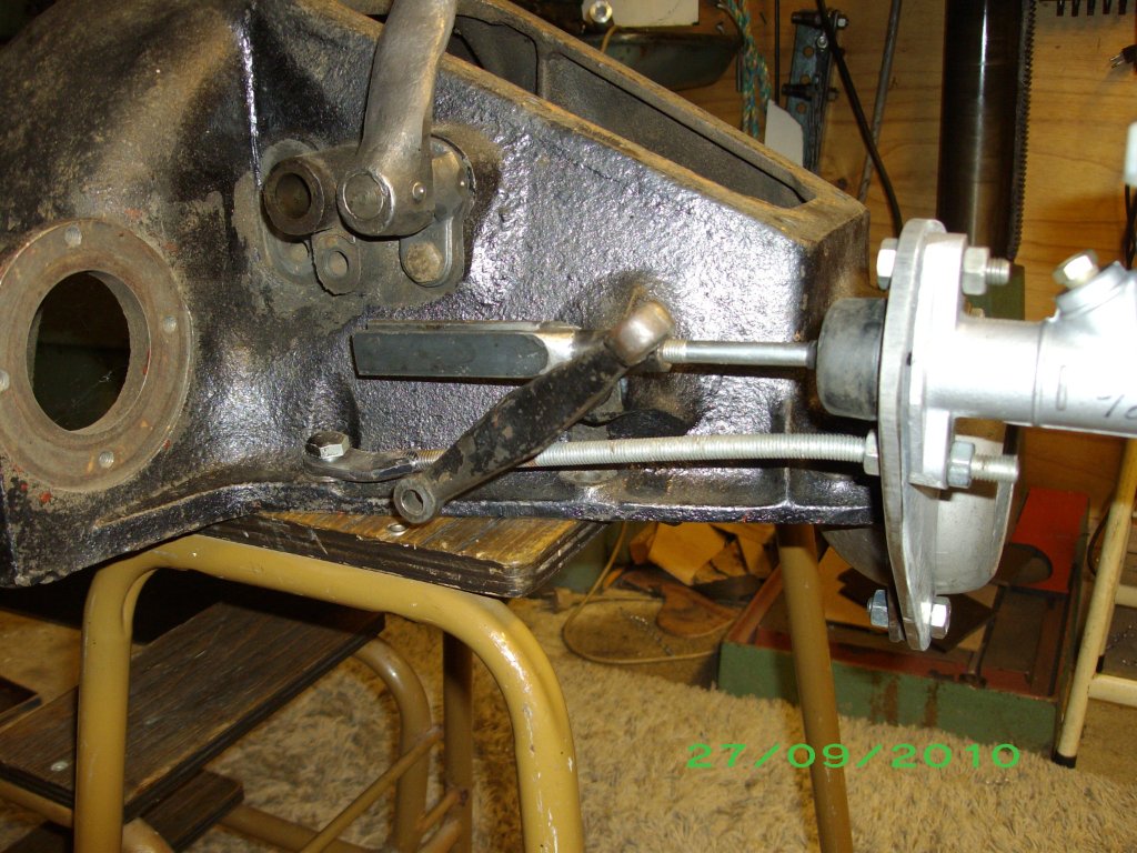

Luc P. for extra strength , I made an all thread [bolt ] there .
See Pictures .
Toon
See Pictures .
Toon

Good to hear the brakes are effective and don't require much force in the normal course of events, my curiosity was more centred around an 'emergency stop' situation where it's a natural reaction to stomp hard on brakes. A quick 'back of the fag packet' calculation suggested to me there could be as much as 500kN or more in tension applied to the two(?) securing bolts, and a significant bending moment to the bracket and hogshead flange, which is what piqued my interest.
Anthonie, those photographs are revealing, thank you. The bracket and cylinder appear different (was this an earlier model, or a unit you've made yourself?) however the photos give further insight as to how the master cylinder is secured. I originally thought the bracket might have been ~3/8" thick but from the greater detail I can see, and from John's comment that it's just 1/4", I think that reaction rod you've installed is a good thing, although I imagine where it's connected to the lower mounting bolt of the cylinder could lead to some rotation of the bracket under load.
Otherwise I want to reiterate I wasn't criticising the quality of the components, indeed they look well made, it's just that I wondered about the capacity of the system to deal with the possible force applied from a heavy boot, and from that whether the design might be improved (if needed).
