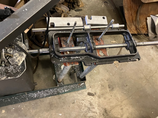

Using KR Wilson boring bar frame with adjustable cutters and thought it was seated against the false cam, it wasn't! No big deal, over cut the front main anyway so need to redo. Looks like I bored it off center and more than likely redo the center too as it is close to final cut, poo! The rear still has plenty of babbitt to get it in alignment.

The KR Wilson boring bar frame has 2 legs that stick down and are pushed against the false cam. I am working with what I have.

The KRW boring frame are made to be used with their combo machine. It has a bed plate for the block to mount on so the boring frame adjusting screw can push the boring frame against the false cam.
Most KRW stuff is worn out where it is hard to get a good job with them. If you are doing more than just one engine you may want to look at Gene’s boring frames. Mate it with a Tobin Arp feed and you have a winning combo.

Very correct on the adjustment screw and became aware of that yesterday talking to someone that knows about the KR Wilson tools. Next go around will be using clamps to pull it over tight before bolting down and check centering before putting those two caps back on. I have re-poured the caps and will do the center and front in block today.Dan Hatch wrote: ↑Mon Feb 13, 2023 7:53 pmThe KRW boring frame are made to be used with their combo machine. It has a bed plate for the block to mount on so the boring frame adjusting screw can push the boring frame against the false cam.

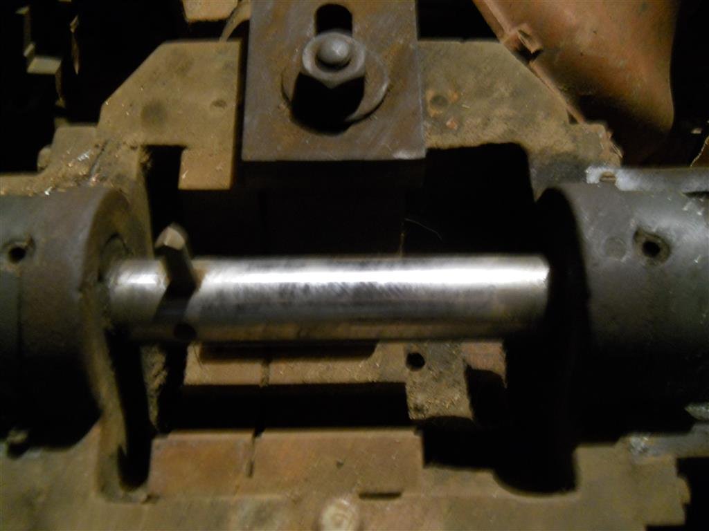

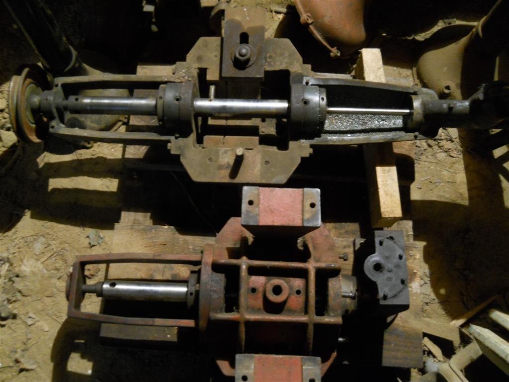

The line bore machine that I have used for 20 years or more. The “link” system assures me of correct gear fit.
Topic author - Posts: 5545
Re: Note to self: Make sure the boring bar is center in bearing...
Thanks for the photo, I see and understand now what you were talking about and how it works.

Les, what other engines are you using that frame on? I see a number of extra holes drilled for mounting.
