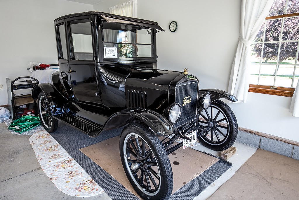

Re: Getting a little more out of your T
This is Elizabeth my soon to be...... new to me 1924 Coupe.

- Posts: 6712
Ron
that is a lovely car
I would not be in a huge hurry to "upgrade" anything until you had several long trips or tours under your belt and really discovered if it truly lacked for anything.
The reality is, Model Ts have never been known to charge up hills. Folks who expect otherwise sadly may have simply gotten the wrong era car.
like I said, it's a lovely car...congratulations and enjoy the ride

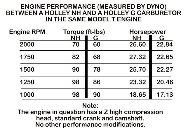

- Posts: 2319
- Last Name: Juhl
- Location: Thumb of Michigan
My engine has been rebuilt and is in good shape. I have aluminum pistons and a Z head. I also replaced the Holley G carb with a swayback NH. As posted in other threads, the NH made a surprising difference in performance as documented in side by side dyno tests on my engine with the different carbs. I've since installed one of Scott Conger's full-flow valves in the carb which helps on hills or when fuel is low in the tank resulting in lower fuel pressure. I also installed a ten-tooth pinion gear which provides a little better performance on hills and less stumble between low and high without sacrificing overall performance.
- Posts: 8438
That looks very good to me. Torque, HP, and the speeds all look very good.
