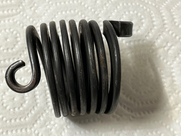

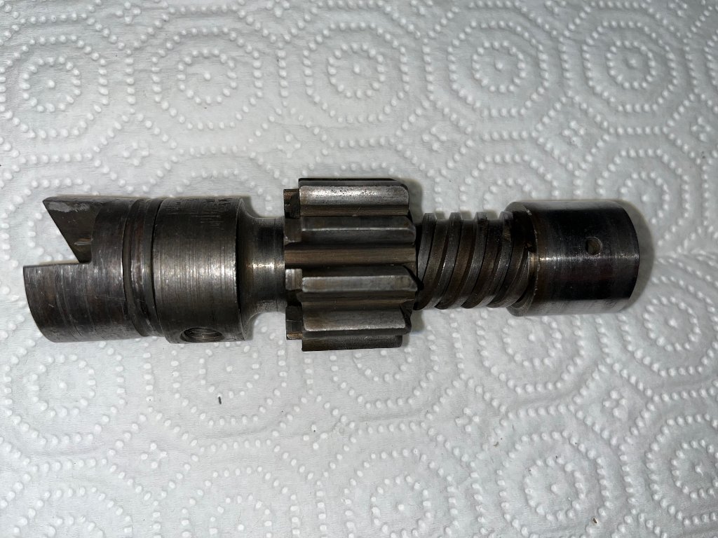

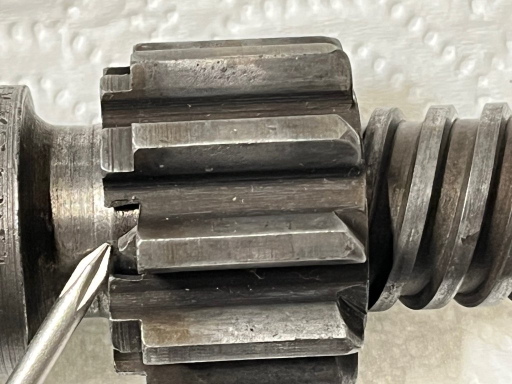

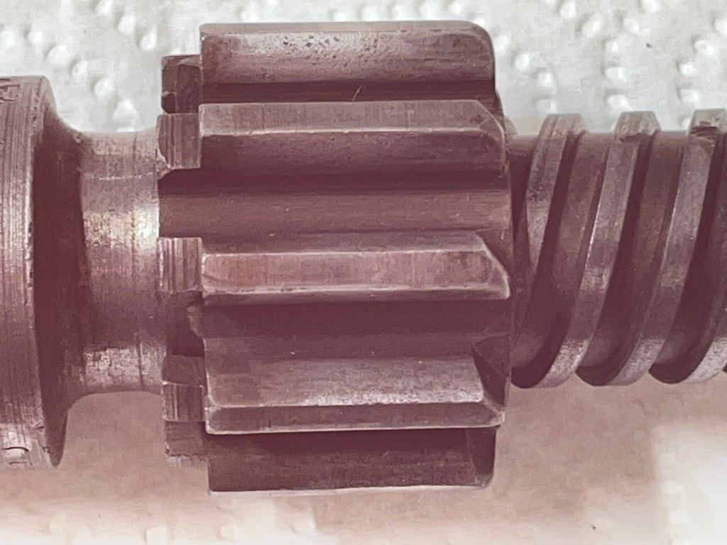

I am getting ready to install a rebuilt starter in my 1927 coupe. Attached are photos of my original bendix. I would appreciate opinions on whether or not it is useable, or if I should purchase a new one.
I assume what is shown on left end of the teeth is normal wear. Is this a problem?
The end of the tooth, where the screw driver points in the fourth photo, is different than the ends of all of the other teeth. Is this a problem?

Your bendix is missing a shield where the teeth step down. Yes it is a problem. Your spring is no good also. Look for another bendix.

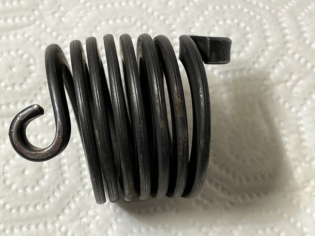

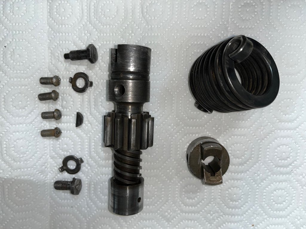

Here are two more photos.

Its totally fubar.
The counterweight is missing. Where did it go??
Spring is sprung.
Cant tell for sure if the drive collar is in tact, but, it looks a bit off.

The shield that is missing holds a pin and spring that stops the gear from working it's way into the flywheel ring gear when not being used.

You can tell the spring is bad since the two ends no longer align with one another. It means that it's been over-torqued and it's bent out of shape.

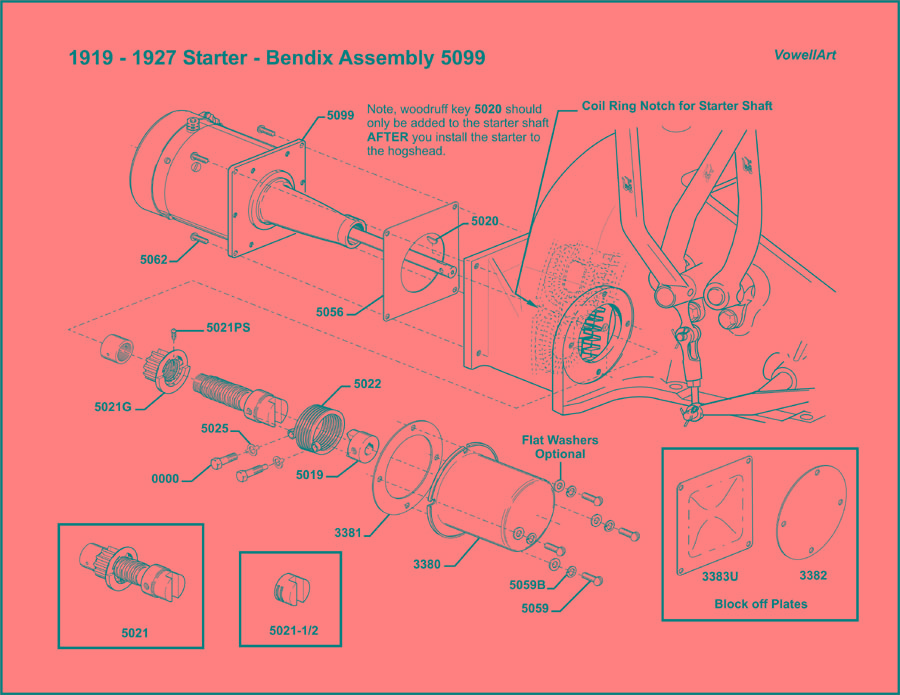

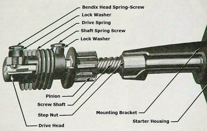

I am trying to understand the bendix. In the Lang's diagram, where is the "shield" and the "counter balance"?

5021G is it.

I meant to say "counterweight" not "counterbalance"!

Another diagram with labels:

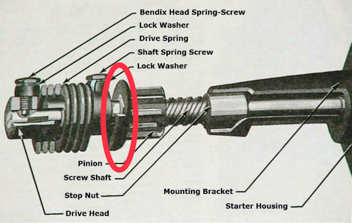

Where is the "counterweight"

The parts you see in both diagrams are all there are. If you have all of the parts, regardless of what others call them, your bendix is complete. Your spring has been subjected to excessive slamming and is bad. The two bolt holes on the spring must be on the same side and the spring spirals must be straight and not angled. I have never heard of a counterweight on a bendix. At least Ford never referred to any parts as a “counterweight”, so there is no need to obsess about it. :) Jim Patrick

The collar in the red circle. 5021G

That collar has the counterweight built into it, all in one piece. It has three tabs on the onside diameter, which engage in three slots on the back of the gear. These slots are upset to fix the collar to the gear. These upsets frequently fail, and many times the collar is then bronze welded to the gear. This is a perfectly satisfactory fix. I wonder where yours went?
Part of the collar assembly is a tiny spring and plunger which helps to stop the gear drifting into mesh when the engine is running. the plunger and spring are also available from the vendors.

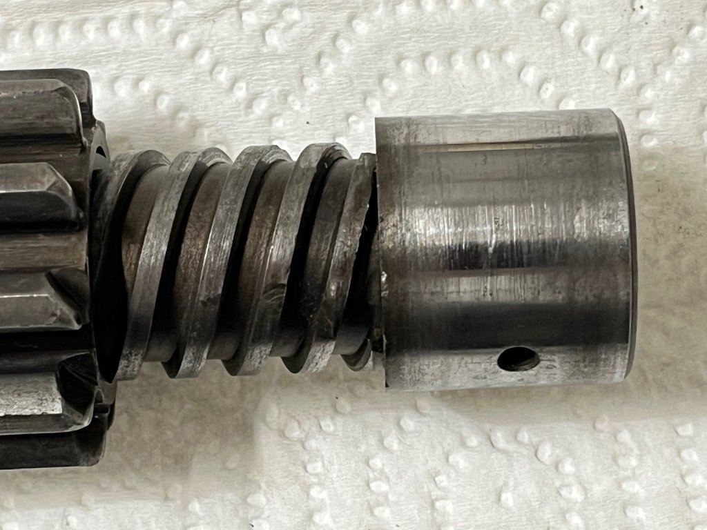

Getting the bearing sleeve off the end of the spiral is the tricky bit. I do it by cutting two bullet head nails off just under the head, and putting the last bit of the nail shaft into the holes in the sleeve. The sleeve is then held in a vice with some soft jaws, and turned enough so that the protruding nail heads will stop it rotating in the vice jaws. With the bolt screwed in at the other end of the spiral, I use a large adjustable wrench to turn the spiral piece. It will ever-ride the upsets in the thread and allow the bearing sleeve to be wound off. Replacement is just the reverse operation.
When the bearing sleeve is replaced, it may end up stopping with the original upsets in the same place. If so, I take it off again and linish a bit off the end so it can be threaded on just a bit further. Loctie and stake it in the new place.
