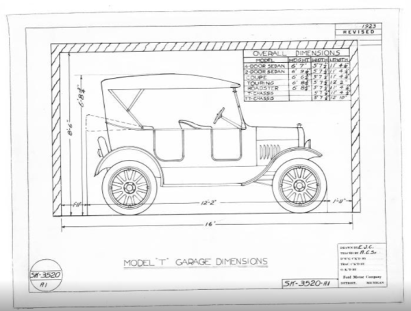

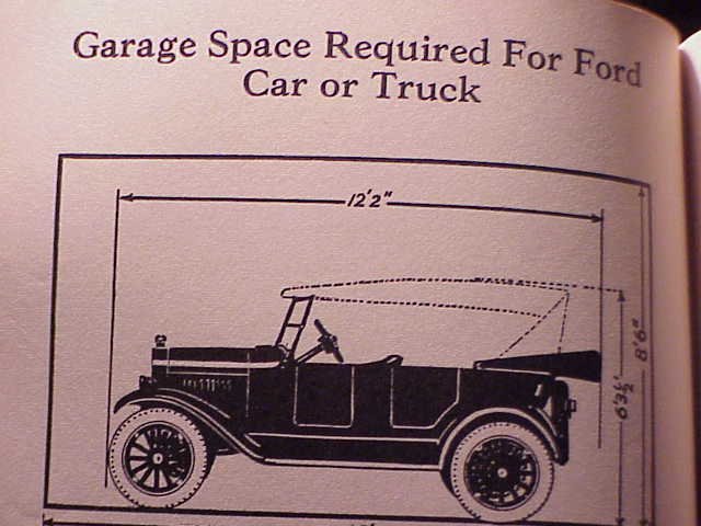

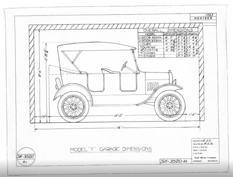

Some interesting images
This is for a 1926/7 and are lower than the early models --
Model T heights of the same year & model can vary a few inches depending on spring stiffness.
