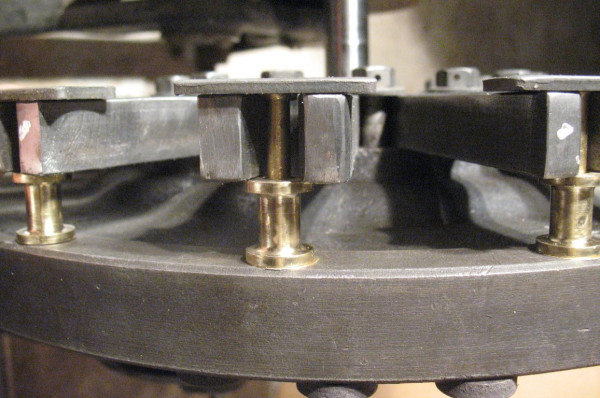

You can adjust magnet height by grinding some of the spools shorter as Norm described, or you can raise the short ones with shims. I use shims of .003" and/or .005". I call a gap of .025" to .028" close enough for gummint work.
I know some people do it, but the idea of beating the magnets down with any kind of hammer makes me cringe.
