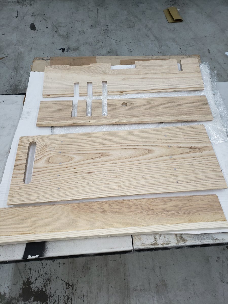

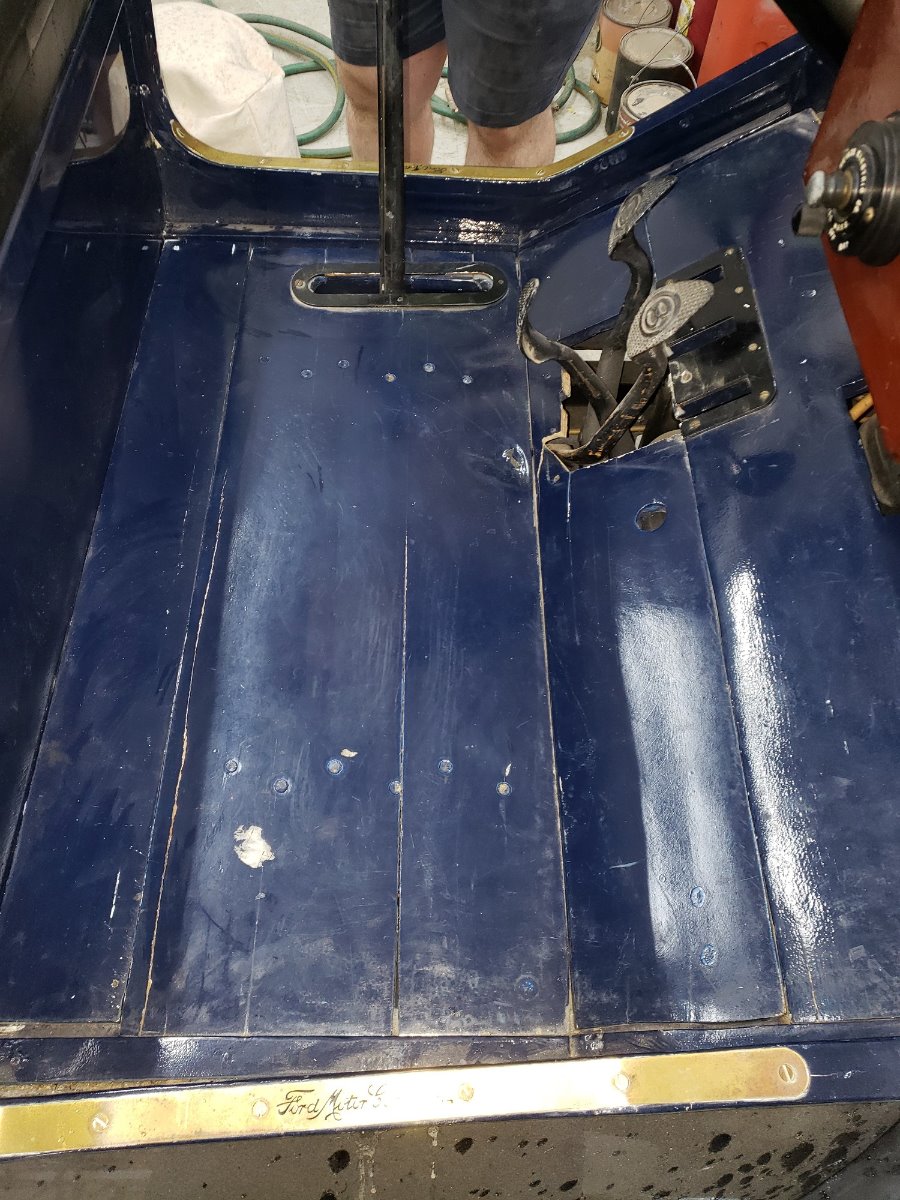

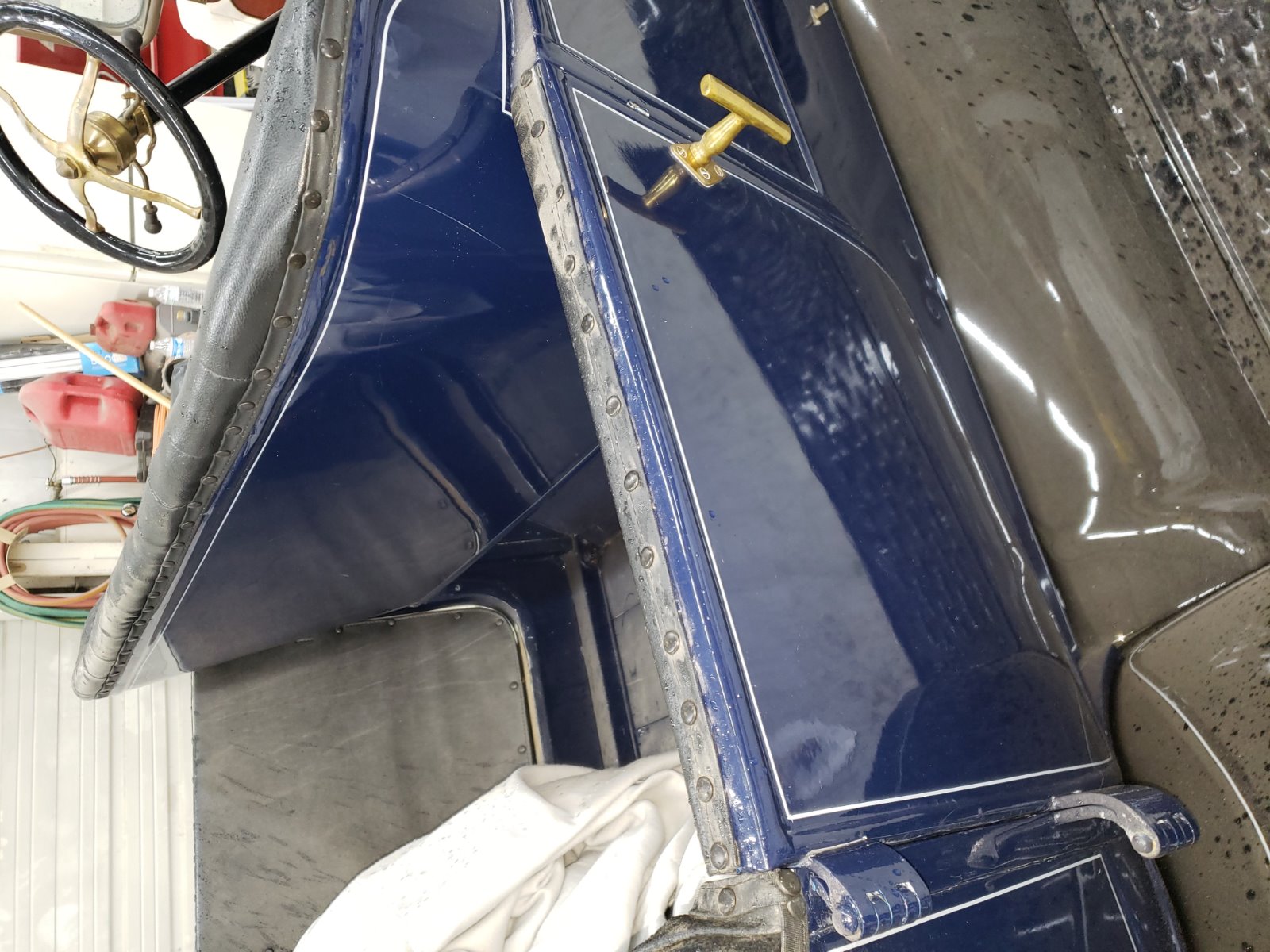

Pictured are the old, blue floorboards as well as the body of the '11 Touring.
Also pictured are the new floorboards.
I don't know what type paint to use, what process (brush, roll, or spray), or the color's part number.
Any input is appreciated.
Thanks.
Thanks.

Bill, I am curious as to why you would discard original floorboards for new ones? My oldest car is a '13. I would never in a million years substitute a new part for an old one if it was safe and serviceable, and floorboards are not a safety item like a spindle pin. Additionally, I have a survivor '15 which was bought from the original owner in 1960 and stored in an air-conditioned garage until I bought it a few years ago. The last owner replaced the top which frankly was a crime, in my opinion. This car is a near-perfect survivor with great original paint and everything else...except for a nice tight shiny top and that is really too bad.

To each is own, but I am with Scott unless they were reproduced incorrectly.

If you look close the middle board, the pieces that make up the slots are missing, the fingers. Along with a bad cut under the brake pedal.

I like to brush urethane on the bare wood. Let it dry, scuff it and brush over it with a slow drying enamel or spray with acrylic enamel or a favorite type you use on steel but not a lacquer base or anything that would lift the urethane. The urethane likes the wood and lets other paints stick to it. This has worked for me for 50 some years.
Others have their favorite methods and will surely post them here.

Which is repairable with little effort and still retain the original part.
I am by nature a conservator and caretaker of my cars and my furniture. The next generation is free to chop/channel my cars and Shabby Chic our antique furniture. I just won't do it for them! And if they actually do, I plan to come back to haunt them.

I suspect a search of the archives would show that the factory 'washed' all floorboards with black something-or-other.
If I'm wrong about that, others will quickly correct me. If I'm right, the blue floorboards would have been a later change, and you could go either way.
If you want to absolutely copy the old ones, take one to a paint store (I prefer Sherwin-Williams), and their computer can read the color and mix you an absolute match in new paint.
Since you're starting with new wood, be sure to use an oil-based primer first. Primer is different from paint, and its purpose is to sink into the wood and form a seal with it, and then present a good surface for adhesion of the final coat. It can be tinted to match. It's a good idea to make it a shade lighter than the finish coat, so you can tell if you miss a place.
Also use an oil-based final coat (or two). The "sheen" is your choice. It comes from flat to glossy, or you can go with what is commonly known as "refrigerator gloss," which is a harder and shinier finish.
You've noticed that I specify oil-based paint. I won't bore you with all the details, but 25 years as a General Contractor taught me that Latex paint is NOT paint - it's akin to your wife's makeup, and cannot protect the wood or provide a surface that can withstand what a floorboard must withstand. Don't let any paint salesman tell you otherwise.
It's a good idea to do something to insulate part of the underside of the floorboards, where they pass quite close to the exhaust pipe. I've seen boards that were quite heavily charred in that area, and only by chance did they not catch fire and destroy the vehicle. As you pass by an A/C service truck parked in front of a house, stop and ask them if they have any scraps of foil-faced insulation lying around, You only need a couple of square feet. You can staple it in place after painting.
On the other hand, why not cover the floorboards with a period-correct floor mat?

The floorboards in my 11 touring which I believe are original are not painted.

If the other original boards are good, I think that I would only replace the one bad board--actually, knowing me, I'd patch the original board!

Bill, I just asked Jonathan Anderson, who makes them, what he recommended to replicate the original as close as practical. He suggested one coat of black epoxy primer, matt finish brushed on to get the original translucent type finish. That is for my 1924, so would guess black was used for earlier models also?
