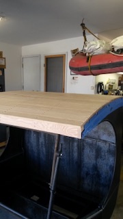

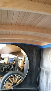

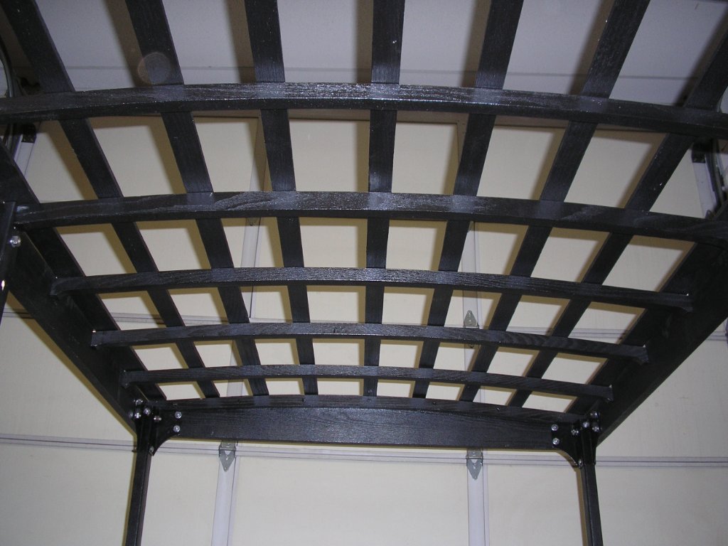

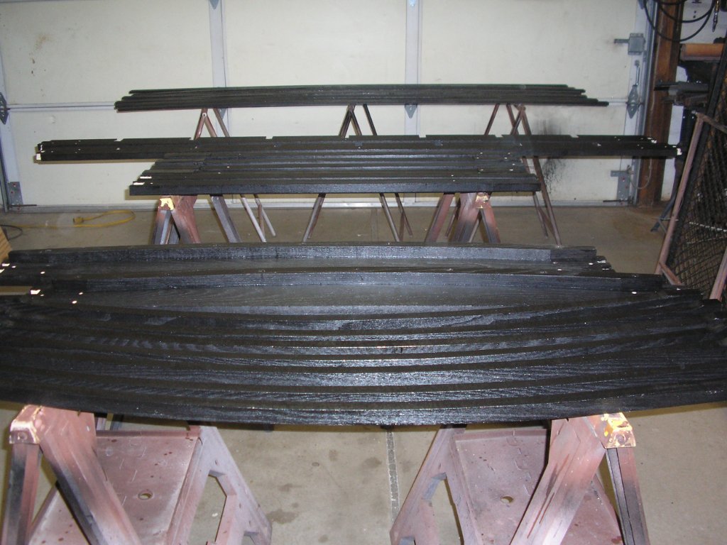

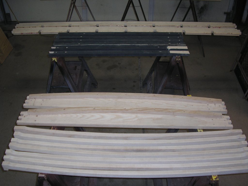

Purchased wood several weeks ago, White Ash, as what is used for the C Cab roof. Followed same pattern as the cab for the Canopy Top, as what little wood I did get with the screen sides, not enough for patterns.

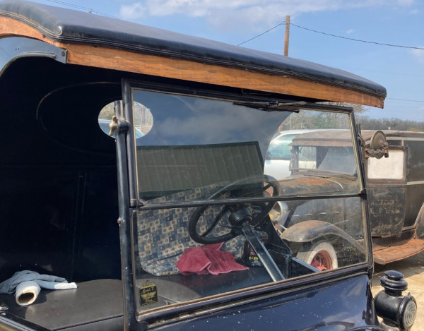

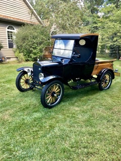

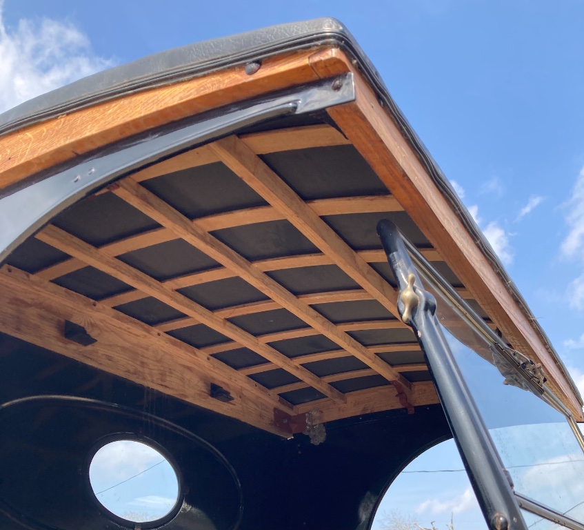

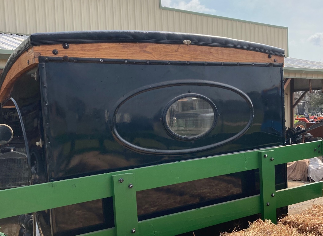

Here is pictures of my C Cab roof before & after installation. It was built from scratch with white oak.

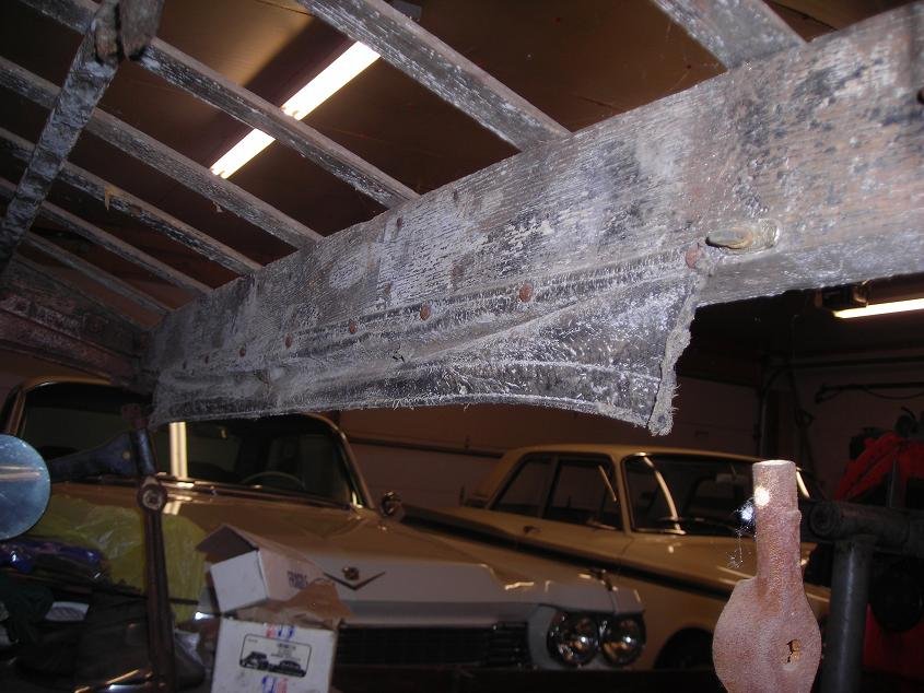

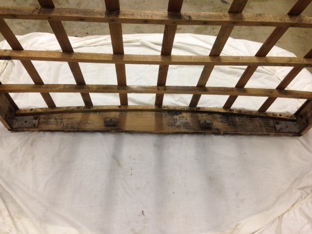

Don - I'll get you a couple photos of my Gramps' 1924 C-Cab Covered Express - all original wood in cab & canopy.

I learned something new today. That is the first time I have ever seen curved top timbers running north and south, with the laths set across the vehicle. I guess it works OK on such a small cab

That top seems to work and is expertly done, but that is not the way Ford did it.

Thanks Jeff, my top works good and the spacing of the north/south ribs align with our heads, you have probably seen me at the Michigan Jamboree.

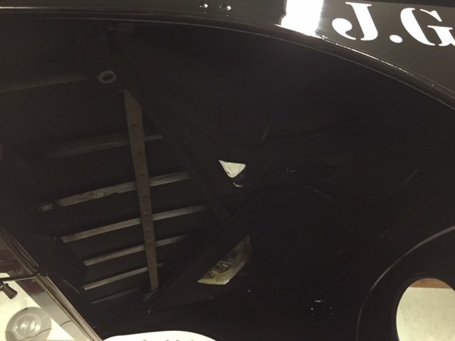

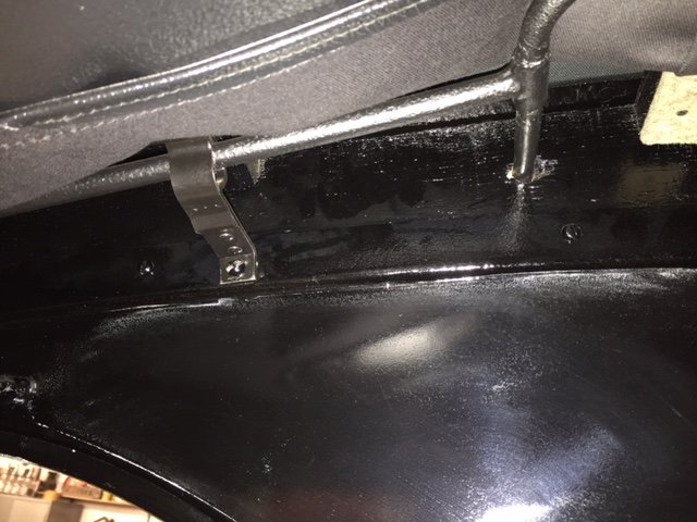

Post by George House » Wed Feb 22, 2023 12:35 pm

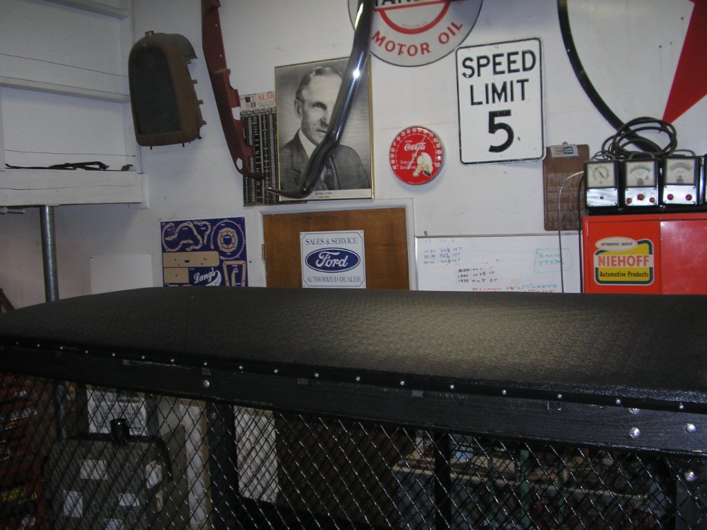

Here you go Don. This is how Ford did it

Thanks Geo., that's exactly like mine. I see you have the stowage clips, Do you have the curtain irons and drawing ???

No, I don’t have the curtain irons. Think that’d make it look too cluttered. Same reason I don’t want a carbide generator on the ‘14. OK purists; so Ford didn’t shellac the C Cab wood.

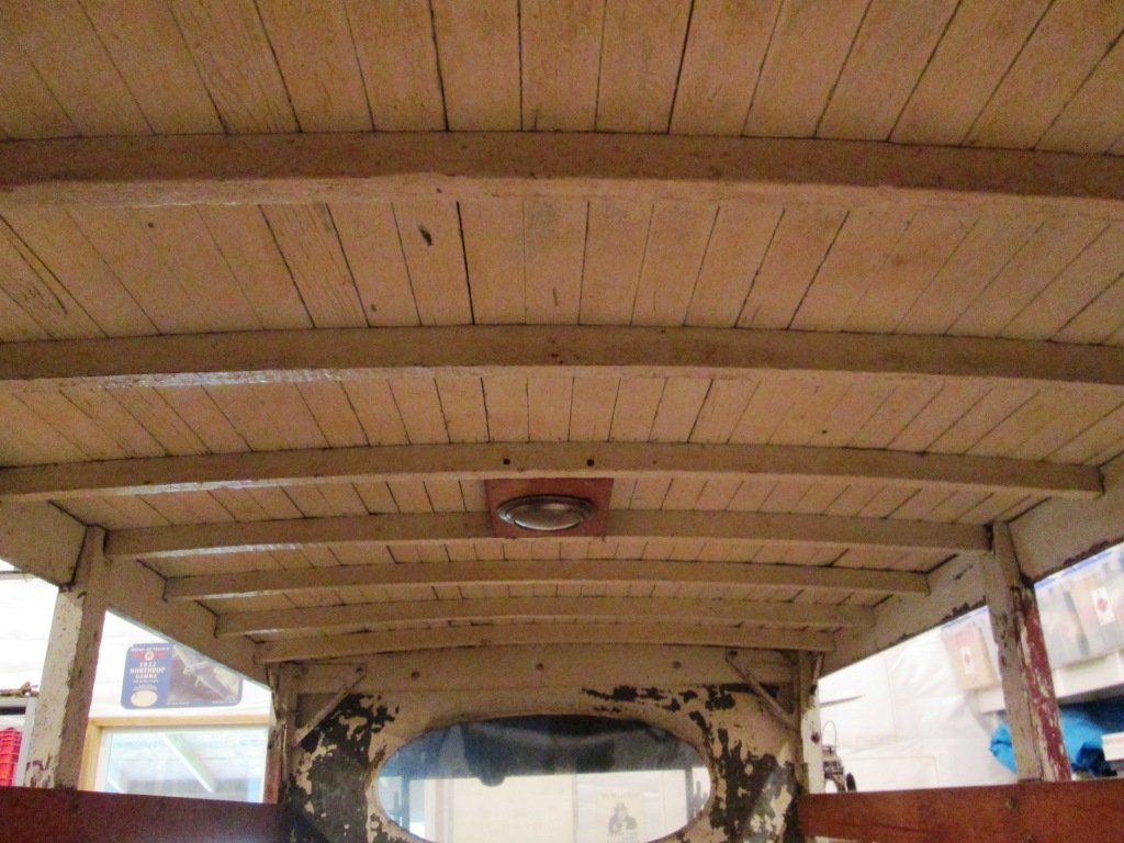

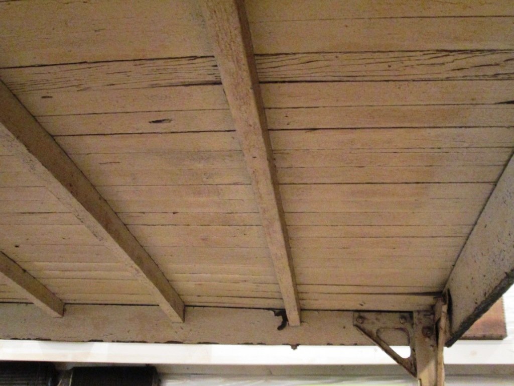

Here's inside the cab roof & canopy of my Gramps' '24 TT - the rear window was whacked out in the 60's as my siblings & I rode in the back quite often & with six kids in the back, my Mom & dad could keep an eye on us !!! Other than the paint job done in the 60's , the truck was original - Gramps bought it new in Seattle at Wm. O. McKay Ford. I believe my Dad installed the dome light.

Thanks Steve, quite a variation in the wood work, I have seen those corner brackets before, and the hacked out rear window, definitely needed to back up.
Wood all painted, ready to install.

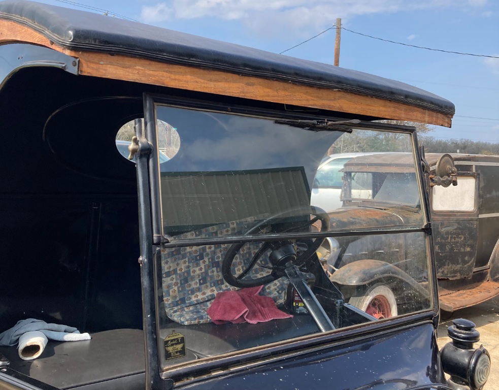

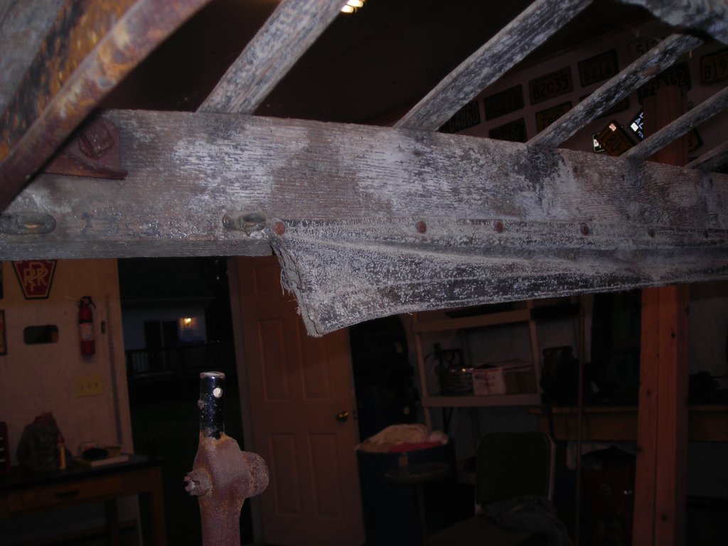

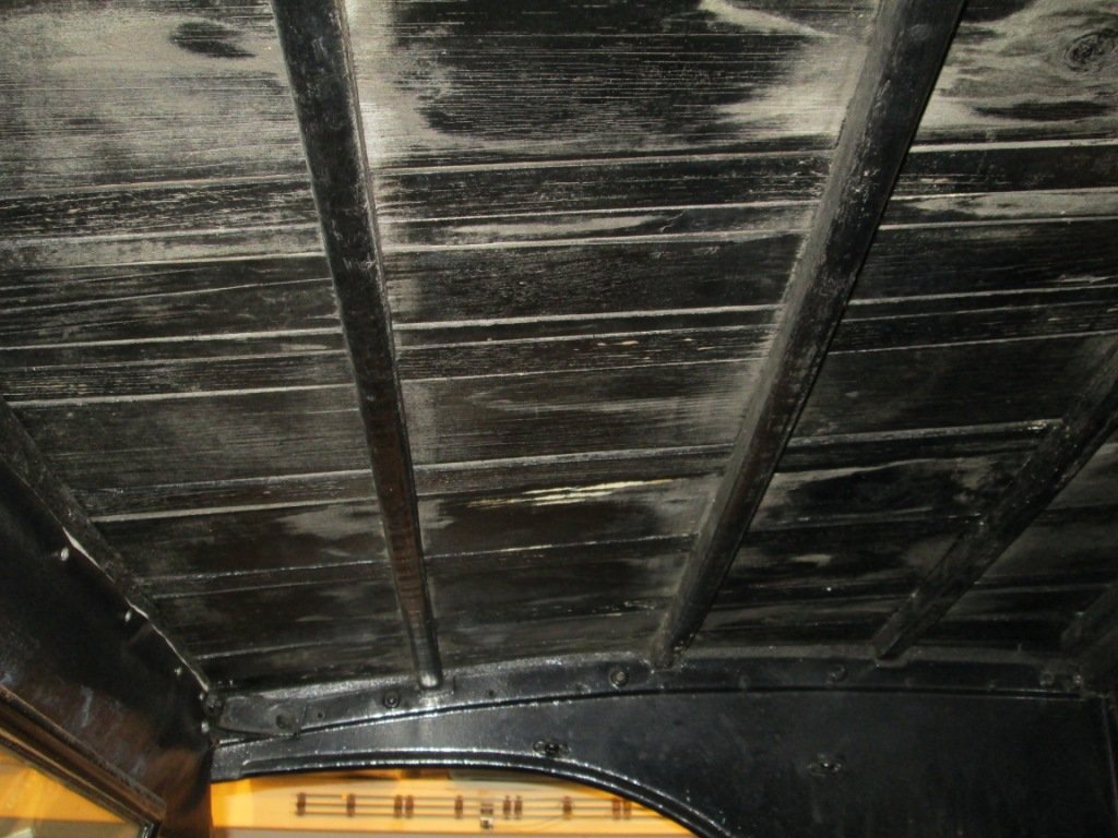

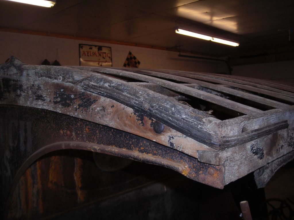

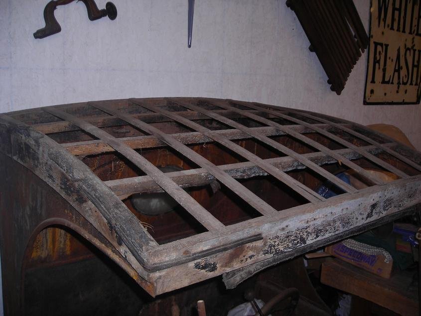

Here are some photos of my original roof that may help you with details.
Justin in Western PA

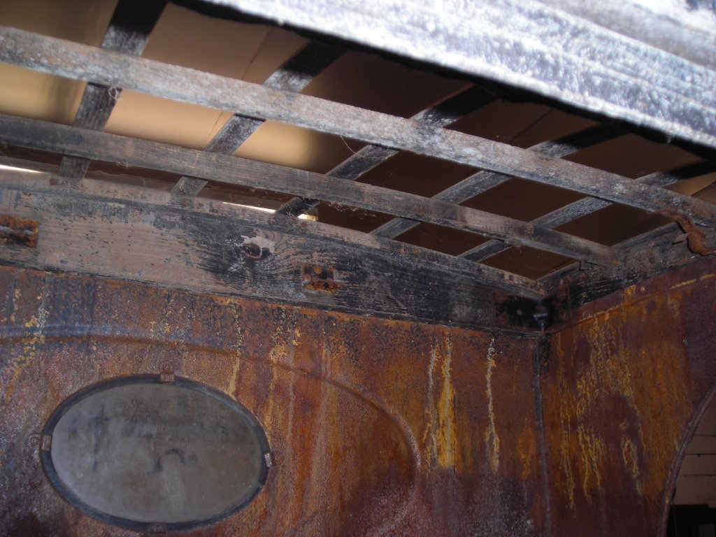

And a few more...

I've noticed differences in the side header on other C-Cabs - my Gramps' has a 12/23 serial number & has the narrow side headers (if that's the proper name ?) and note the others here have the wider side header - can anyone verify why ?

The “low” roof was the earliest design and not made to stow side curtains. I believe this low roof was discontinued in early ‘24. The “high” roof had storage holes and clips for the side curtains. The steel side panels were also notched at the top to accept the cross bows for the low roof. These sides were installed also on later high roof trucks until the inventory of them was used up.

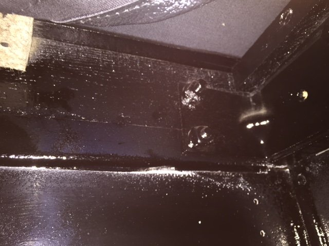

Finished install of roof wood.

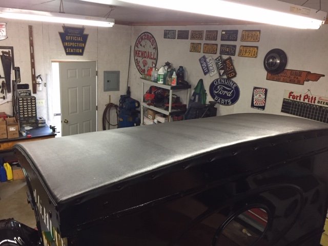

Post by AandTman » Thu Mar 09, 2023 1:29 pm
Top installed, ready for phase 2.

Post by RajoRacer » Thu Mar 09, 2023 1:42 pm
Superb job there, Don !
