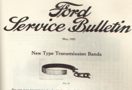

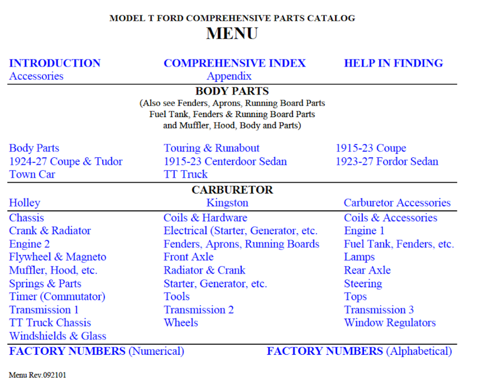

The detachable band ears first appear in the parts book of May, 1925, and are listed as used 1925-1927. This is in the CD/flash drive version of the encyclopedia. I don't believe it's in the abridged online version.

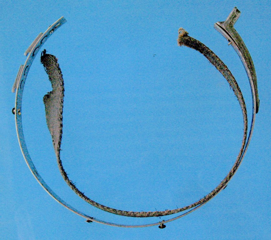

Removed a band to inspect and the lining fell apart.
Yep, cotton rots. That's why I went to Kevlar.
