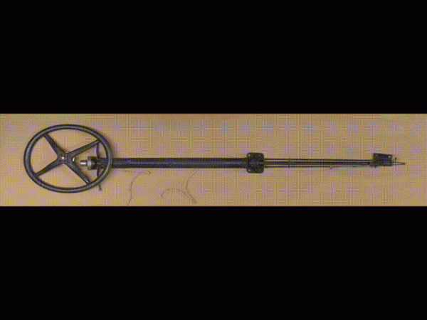

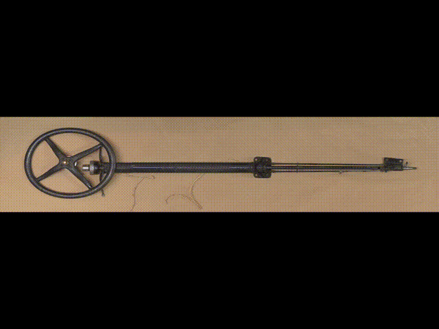

Here are some of the steps I took just to rebuild the steering column. There are more potential points with backlash downstream too - all the way to the wheels.
Flivver, Paris Ontario CANADA
