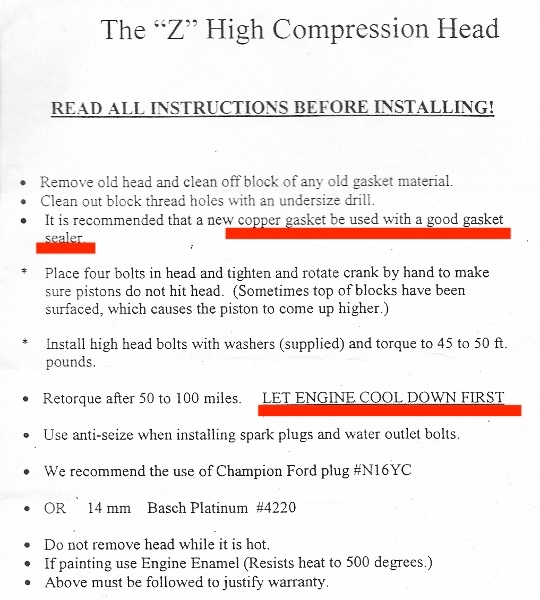

I was just wondering what would be the best sealant for a copper clad head gasket. I would think putting it in dry would not be a good idea. Also I am installing a Z head so do not know if that makes any difference.

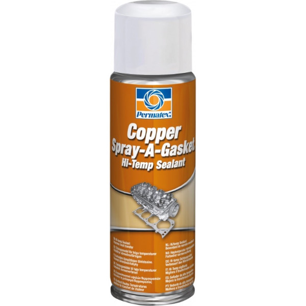

Copper spray sealer, available in the gasket section of the auto parts store. It looks like a can of copper spray paint, and probably is.

I've had excellent results using KW Coppercoat gasket sealer on old style copper or steel-clad head gaskets. Apply according to directions.
With newer, teflon coated gaskets, or other "high tech" gasket products, follow the manufacturer's directions. I think Coppercoat is fine for aluminum heads, but I would follow the manufacturer's advice, if any is available, as to what type gasket and what sealer, if any, to use.
Some gaskets are not to be used with any type of sealer, and are not to be retorqued when used with iron heads. I doubt that the "no retorquing" directive applies when installing an aluminum head, but it would be advisable to seek advice from the manufacturer.

Good stuff. Have used it for years. Spray both sides of gasket. Jim Patrick
