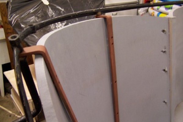

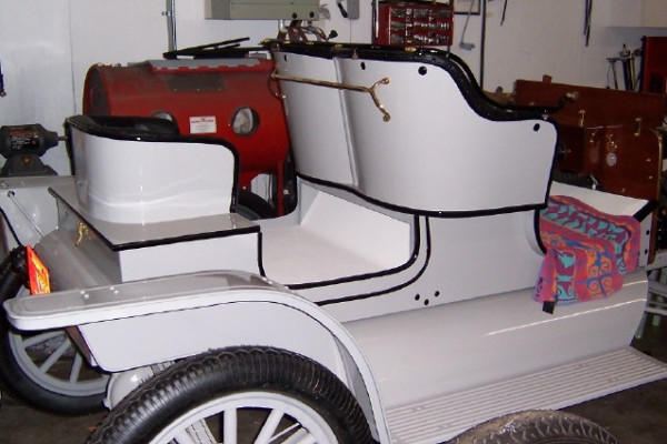

This runabout is likely early, and likely prior to JUNE 1909, as the paint is gray, the nice Dove gray. Note the body does have the black painted carriage bolts securing the bracket for a buggy rail, as those brackets are part of the body, under the upholstery, but the buggy rail for the top fitting is missing.
And fitted with oil lamps, (side and tail).

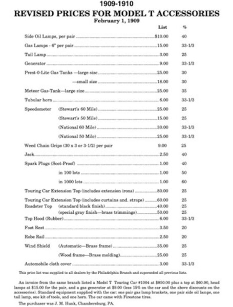

According to info from Bruce, the factory accessories were extra cost on the early cars. Base equipment is noted at the bottom of this list, which are the one tool kit, one pair of headlamp brackets, tail and two side oil lamps, and one horn.
As for your build sheet, could be items left off or hard to read as these were microfiche, only faint initials show for the brands of accessories, you might inspect it closely, seems odd to have gas generator and not have brand of gas lamps listed. But if generator was fitted, seems logical that gas lines were piped to the standard head lamp brackets for later install of head lamps. Typical initials below:
