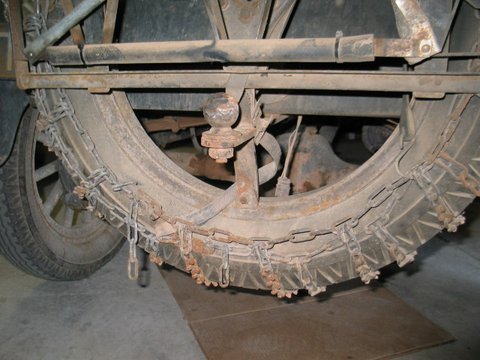

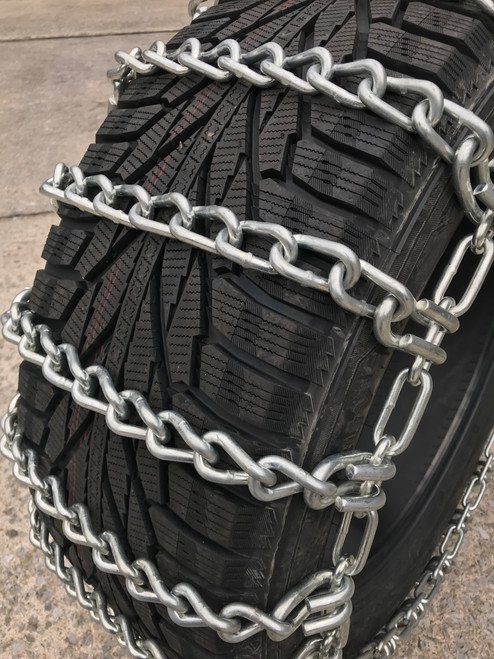

About 15 years ago I ran into the same issue and decided to make my own tire chains by buying a few components online and chain locally.
You can get the "cross chain hooks" and "side chain fasteners" online from places like Harriscos.
When I made the set for my speedster the cross chains were short enough so that the chain going around the side sat on the sidewall of the tire and didn't hit the rim.
I used a twisted chain going across the tire and straight link chain to go along the side link in the photo.
I did not use the chain for the snow as much as I did for off roading in gravel.
It made a few places I couldn't climb before the chains passable once they were installed, and made a big difference on steep down hills grades where the car would just skid instead of stop.

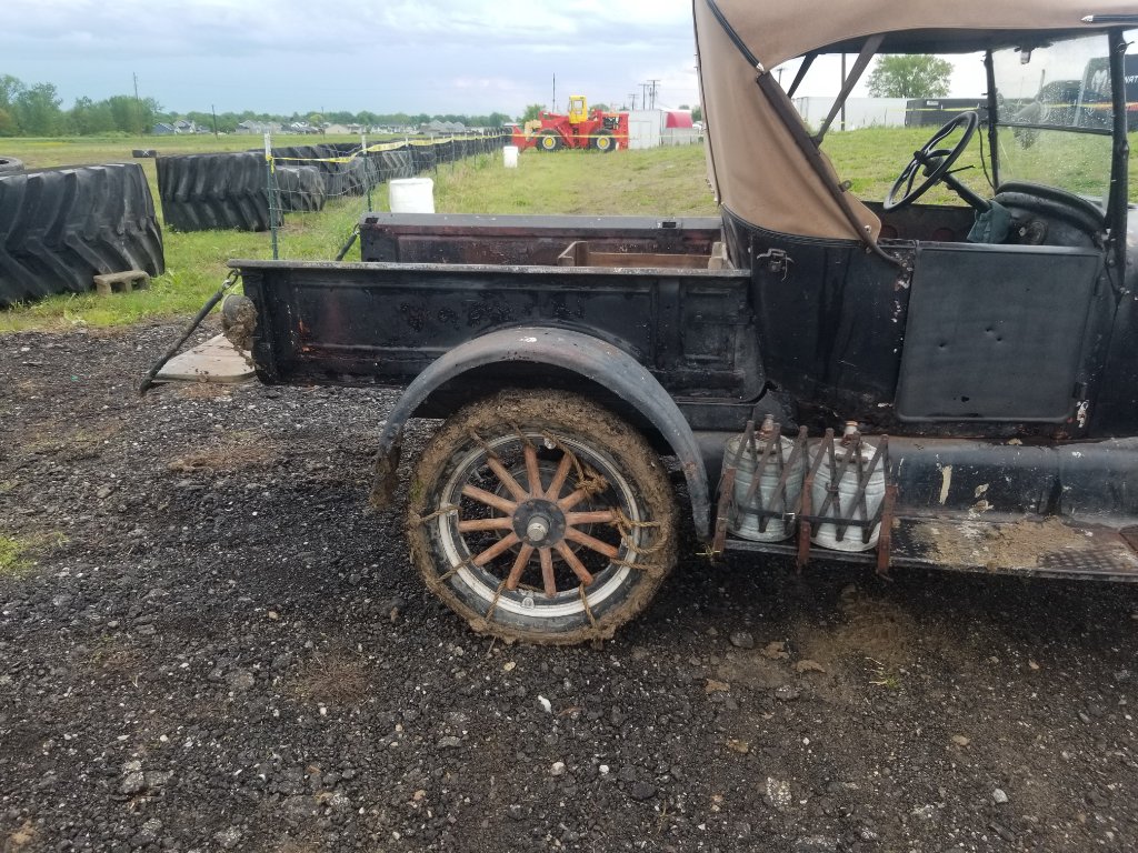

I use 5/8 rope wraped around tire through wood spokes and tied off to a spoke. No damage to wood or paint. Works in mud and snow.
This was last summer at a monster truck show. Yup the T was part of the show on field.

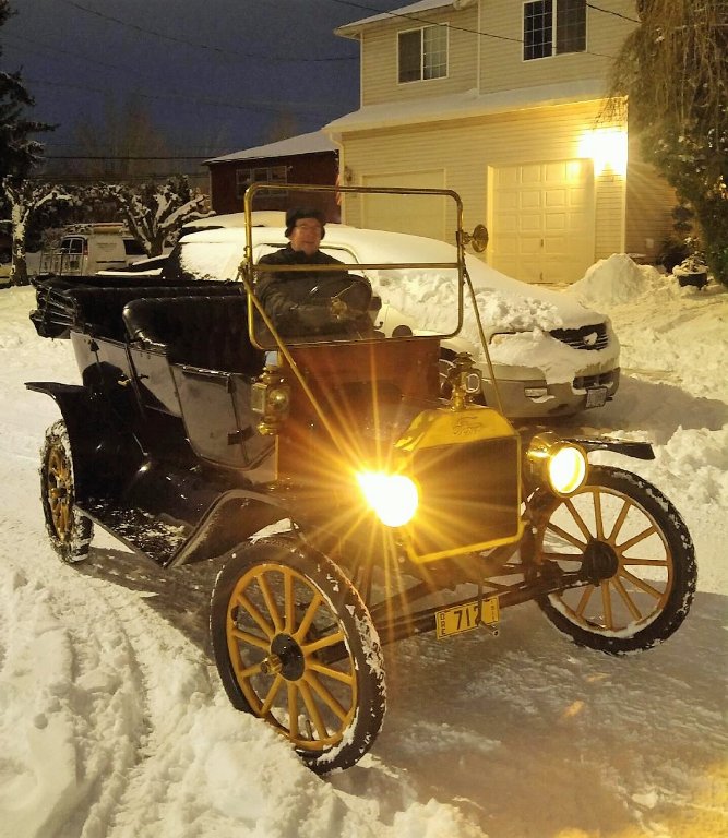

Stan Howe and I having fun in the December snow.

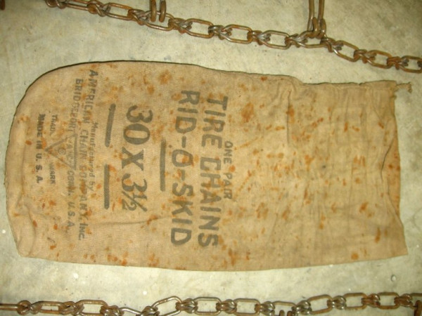

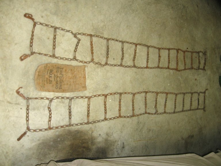

I used to have an original set of "Rid-O-Skid" 30x3.5 tire chains in the original burlap bag, but I sent them to Strong's Garage in Canada (check out their Youtube channel).
If you do manage to find an original set of chains for 30x3.5 tires, be aware that they may be too small to fit on the currently available "oversize" tires, which are nominally 31x4.0 size.

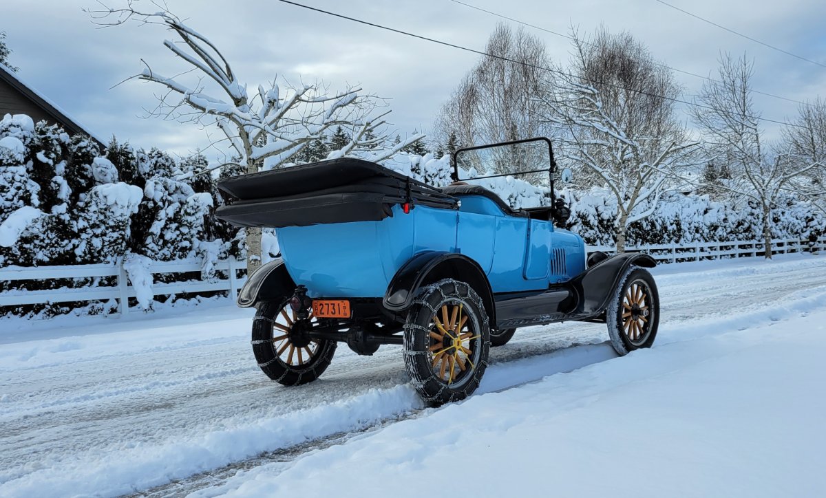

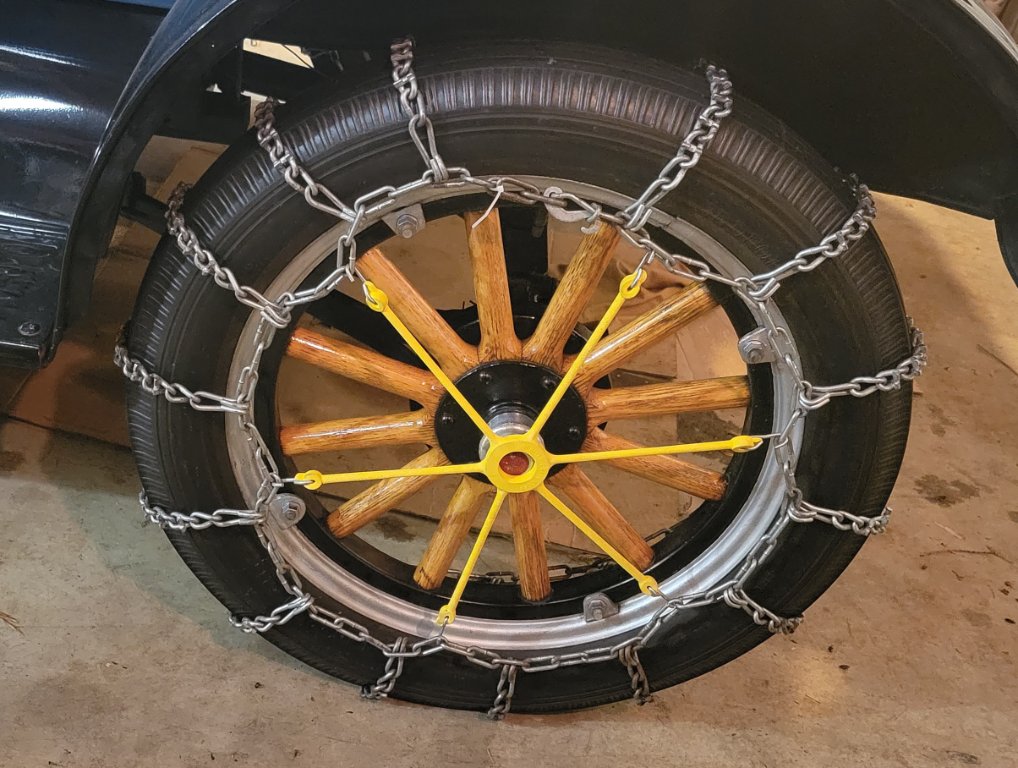

I made my chains 40+ years ago. I modified two sets of chains using pieces on one to lengthen the other. I have no idea what size I used. I was just a kid!
I usually use rubber straps for tension, but use these yellow modern chain tighteners last week.
My chains work fine with either 30x3-1/2 or 21/440.

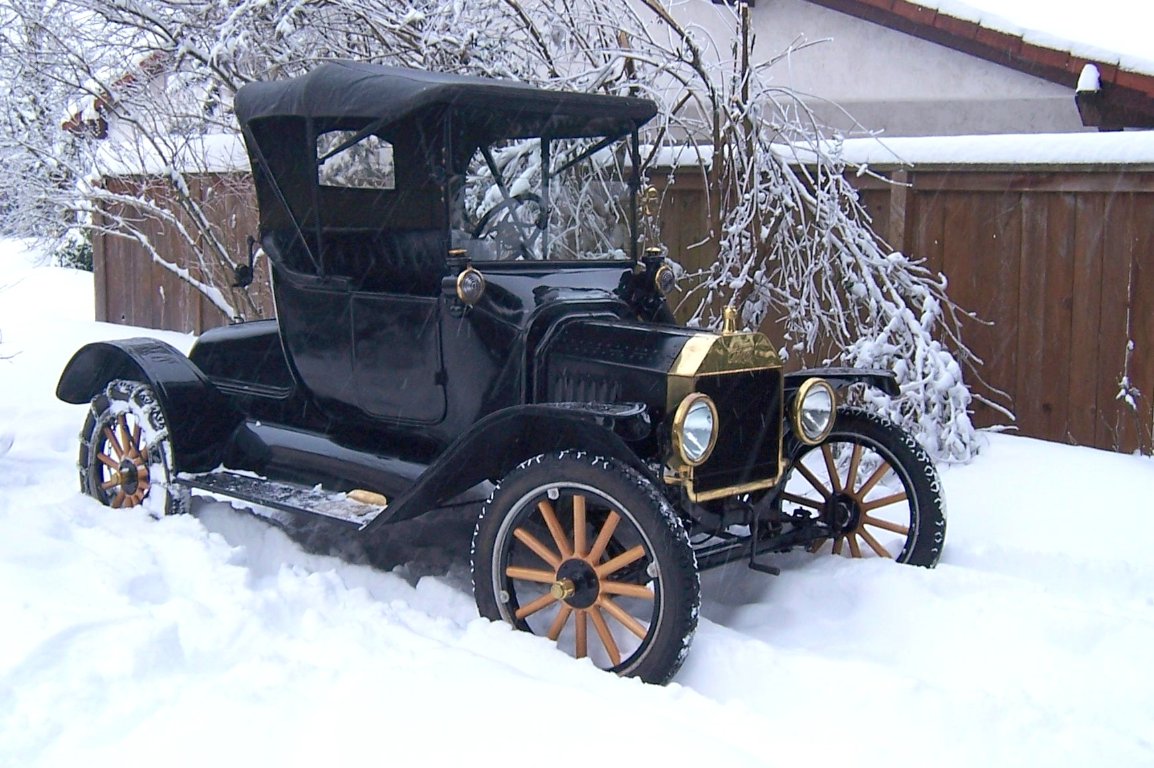

Steve, I really like your chains!
Drving a Model T with chains on is the most fun you can have with your clothes on!
