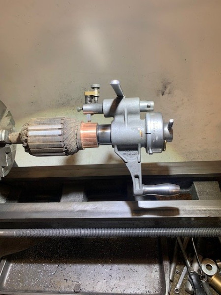

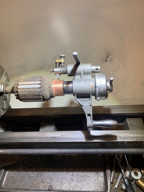

I was able to use my mica cutter for my South Bend lathe. Owned it forever and was able to put it to good use.
Posts: 7903
Re: Cutting Mica on generator
Post by TXGOAT2 » Sat Mar 04, 2023 6:45 pm
Commutator looks good.... windings look well-done.

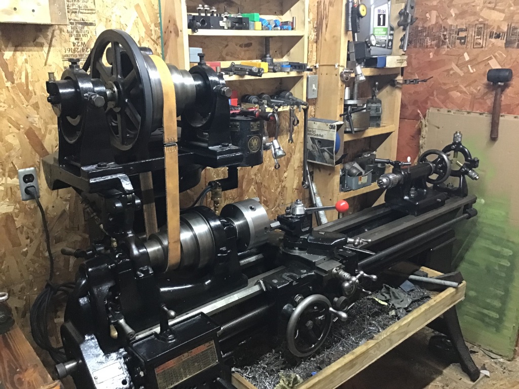

Here is my restored lathe. South Bend 13” Model O.
Posts: 6596
Post by Scott_Conger » Sun Mar 05, 2023 10:20 am
Wonderful machine!

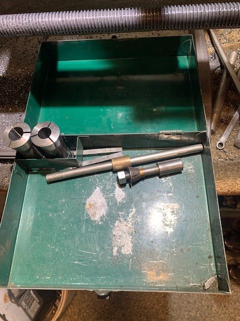

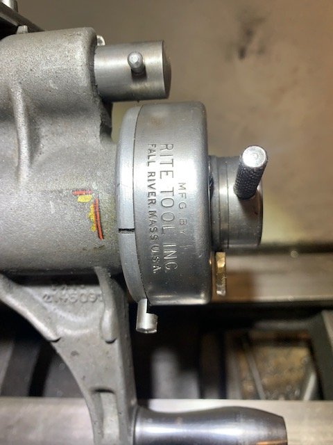

I got this from a 95 year old gent who used this on Model T generators in the day. He kept it in pristine condition.
It is a wonderful tool that is easy to use and I am grateful.

Interesting setup...never seen one before...and it is indeed in gorgeous shape. Nice acquisition!
