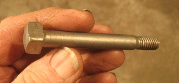

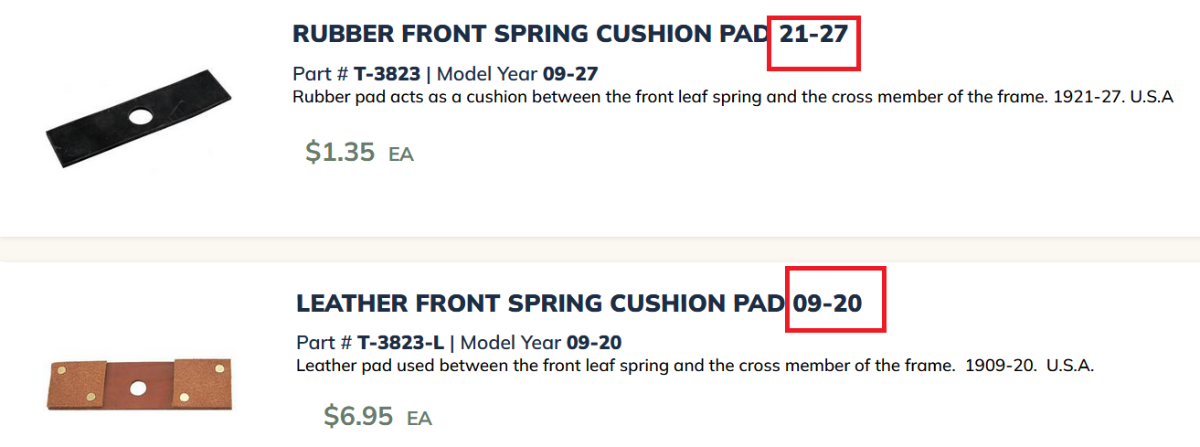

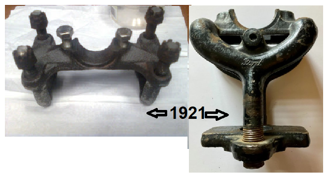

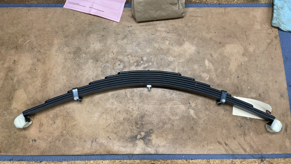

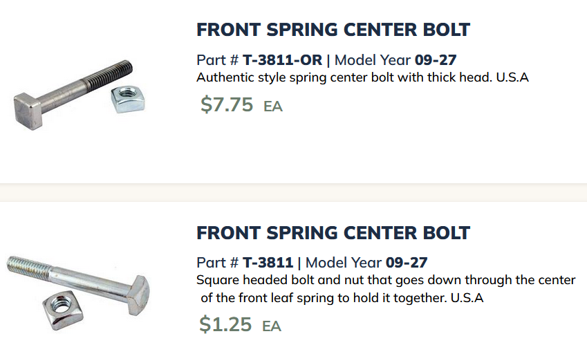

Just looking at the parts involved - not sure what else was or is supposed to be used on a '26 Depot Hack. I have the large head bolt (got from Bob's) and that does seem to make a difference. Also why the pad change for the front spring clips?

TRDxB2 wrote:
Sun Mar 05, 2023 12:12 am
Frank thank you for pointing this out. I just assumed the missing pad was fabricated from Leather since we recently worked on a '14 and used Leather, however since it is missing at this point I have no idea what material was used during the restoration was it Rubber (-as it should have been), or Leather. I would like to think we would have used what was authentic, but maybe not. :o Nonetheless, it lasted well over a decade on many, many tours before it failed.
Although I have not seen the head of that tie-bolt in over a decade, my instinct is to say the head is the proper thick head simply because the leather/rubber pad would have prevented a thin head from indexing into the crossmember. I feel certain the spring would have shifted way before now if it were not indexed sufficiently. Again, we will tear into it in the upcoming weeks and know for certain.

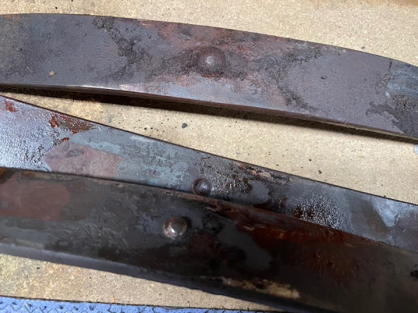

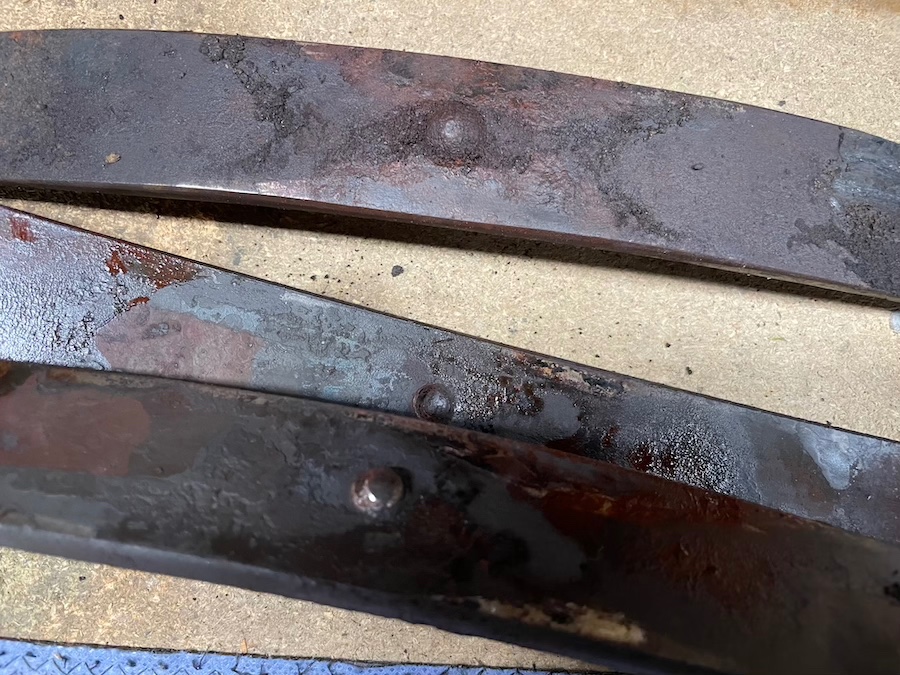

Glad you're ok. When I got my 1925 roadster last year the front spring was the first thing I replaced as it was off center. Taking it apart I found mine just had dimples that fit into each other rather than a bolt. It had to have been a replacement from a long time ago as the car hadn't run since the 60's. I did use the rubber pad on the new spring.
Ford didn't produce depot hacks. I expect the chassis would have the same bolts and pads as any other.
Those pictures appear to be from Snyder's.

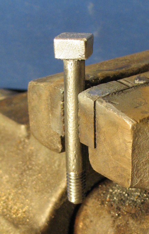

This NOS rear spring bolt has a much taller head.
Unfortunately the Ford parts book doesn't have a picture, so I assumed the front spring bolt would match the rear, and made this one.

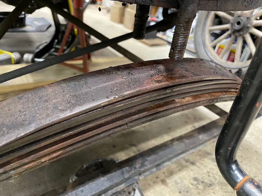

What a great story on your find. I was overhauling the front axle on my ‘24 touring and took the front spring assembly apart only to find the center bolt wore out with no nut on the bottom to tighten the bundle of springs together. Being it is a special bolt, I have one coming. The rubber pad is still there and appears to be in good shape. Also found the leaves really rusty, so I buffed off all the rust and lubed the leaves. I should eliminate a lot of squeaks once it is back together.

It will ride better with cleaned and lubricated springs.
