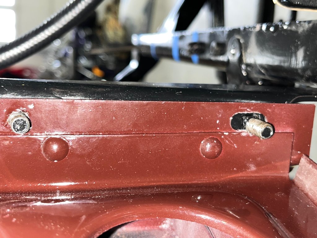

I am in the process of installing the front body brackets to the frame. As shown in the attached photos, the top holes in the body to not completely line up with top hole in the bracket. The bottom hole in the the body is slotted so the holes line up.
All of the eight bottom body to frame connections fit very well, including the front two (one on each side). These two do not have wood blocks, so they are metal to metal. They will separate if I raise the body.
I have no idea why those top holes do not line up. I could raise the body and place washers under the front bottom body to frame connections. However, I am leaning toward enlarging the holes because every thing else seems to fit so good.
What are your opinions?

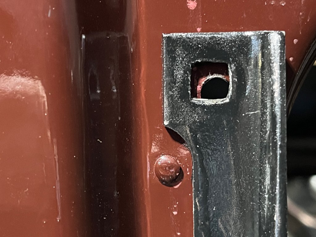

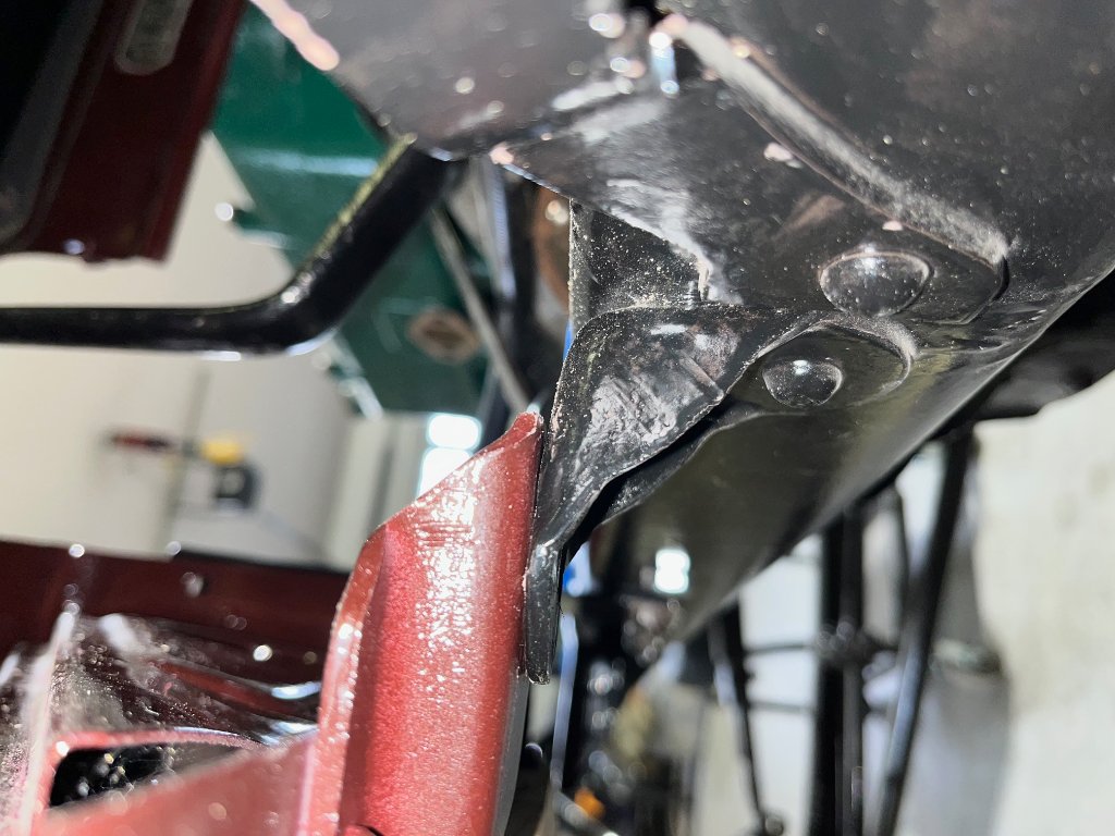

I'm not too convinced that this is caused by a sagged frame. The front body mount brackets are not far back from the firewall. In order for the holes to be that far off, the frame would have to be sagged a fairly large amount in a fairly short distance. I'd look closely at the body mount brackets for any bending or distortion.
Looking at just the one bracket, it appears to be bent upwards. A little harder to see on the other side. I think this may be the cause of your trouble.

Good Eye, Jerry!
I missed that entirely. Both forward body brackets look significantly bent and am shocked at how puny/lightweight they appear.
For those that know these later cars, is that correct???
Those look like mere tabs sticking out with little heft to them relative to earlier cars. Most certainly modifying the front brackets now will lead to a cracked firewall shortly if that much weight is borne by them. Though I'm not a student of late model T's, I do know that firewall cracking can be a problem.
All of which goes back to my earlier point to solve the PROBLEM, not salve over a symptom

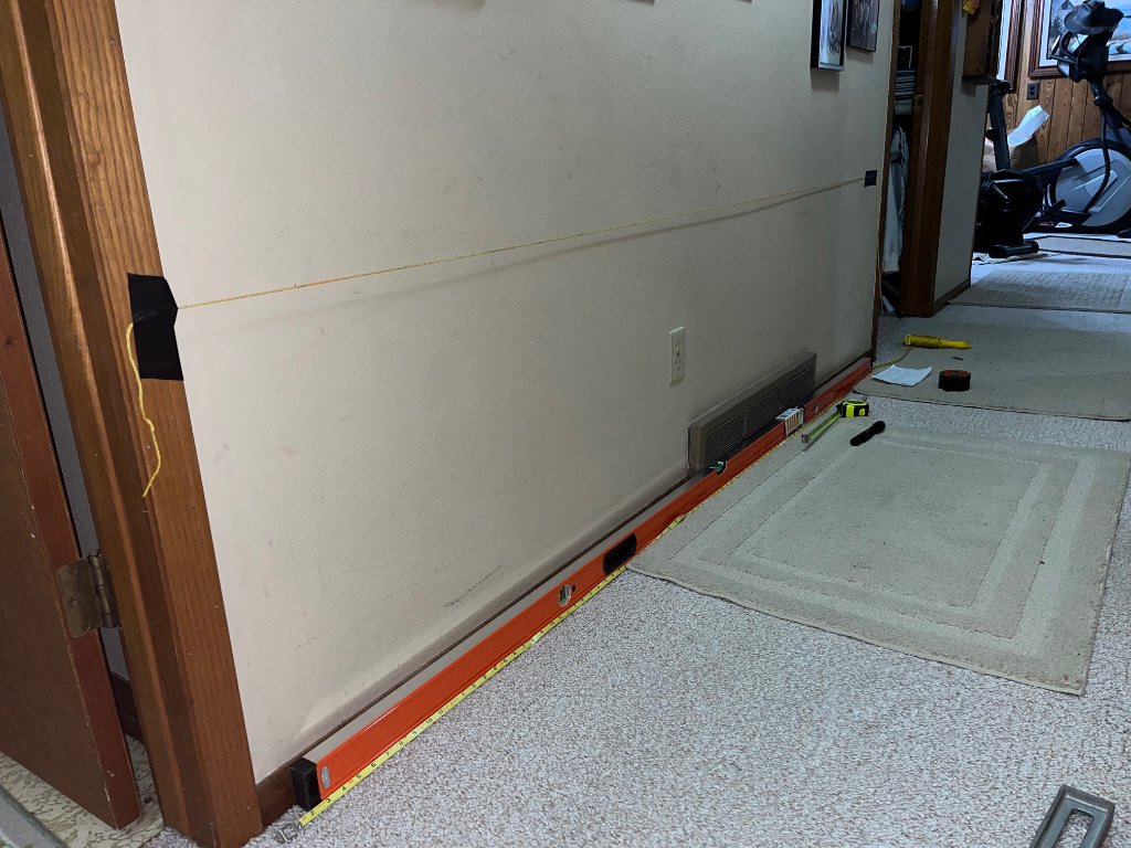

3) I have now made measurements to determine if the rails are straight. We did this by placing a 8' long level on the garage floor and took measurements from it to the top of both rails. The measurements were taken every 9", starting 3" from the front end of the rail. The total number of measurements on each rail was 11. The photos show this procedure.
4) I reproduced the measurements on a wall in my house and used a string line to determine if the frame rails are straight. Both of the rails are straight, no sag.
5) I placed a level on the garage floor, perpendicular to the frame, to determine if the rails were level. They are. This procedure will be shown in the next post.

First photo shows how I determined that the frame rails were straight.
Second photo shows the procedure to determine if the rails are level.
Third and fourth photos show the front "body" and "frame" brackets on the passenger side. The third is looking toward the front. The fourth is looking toward the rear and shows the very small gap.
The fifth photo shows the front "body" and "frame" brackets on the driver side, looking toward the front.

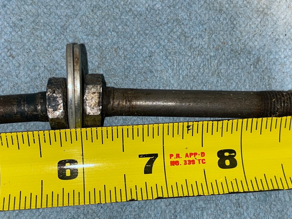

I raised the body enough to get the bolts into the bracket (photos 1 and 2). This has required two washers on the left front frame support bracket (photos 3 and 4), and one washer on the adjacent body block (photo 5). In my next post, I will show how the body is setting now.
