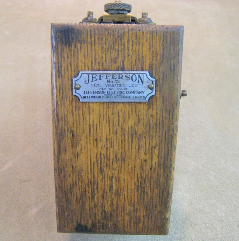

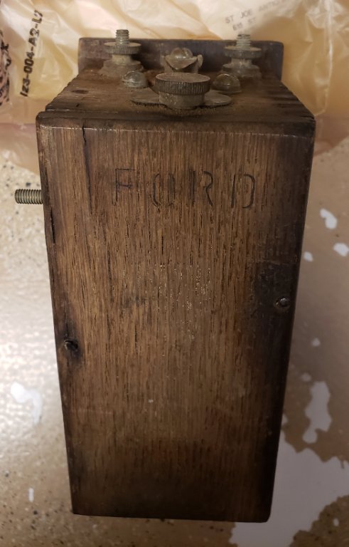

Just picked this up. The shop called it a Model T Ford magneto. :roll: I am a bit ignorant on how it would work with a standard coil box.

If it's an ignition coil, it's probably pre-T.
A master vibrator looks very similar to the device in the picture.

I believe that’s a Jefferson type coil similar in construction to the JEFFERSON No.51 coil.

That's a typical single cylinder ignition coil, used for cars and stationary engines. There were possibly dozens, if not hundreds, of different manufacturers of them. Yours is not for a Model T, or even a pre-Model T, or so I believe, since Ford never made a single cylinder car. I suspect that someone has scratched in the FORD name to "create" a more interesting example, or who knows, maybe there was a coil manufacturer named FORD.

I thought it was maybe for a hit and miss motor. I was suspect of the Ford on the front. Did not think Ford ever used that script. It did have a gold painted emblem at one point, but it is unreadable.

2 cycle marine single cylinder engines used to be common, and many used a buzz coil and timer arrangement that allowed the engine to run in either direction. The operator could, with a little finesse, reverse the engine without stopping it.
