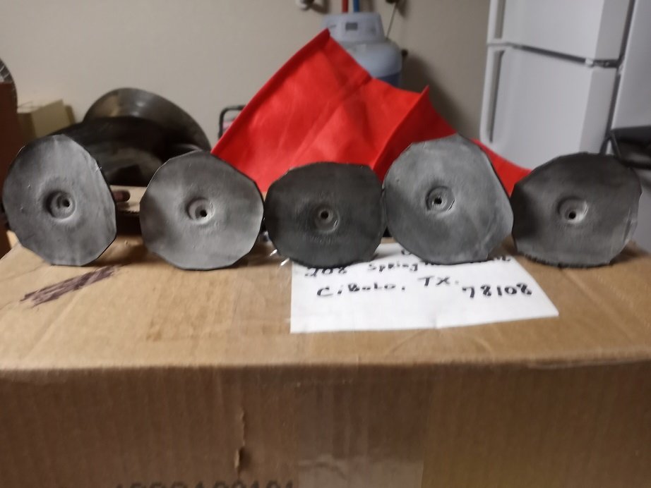

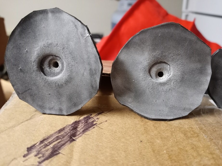

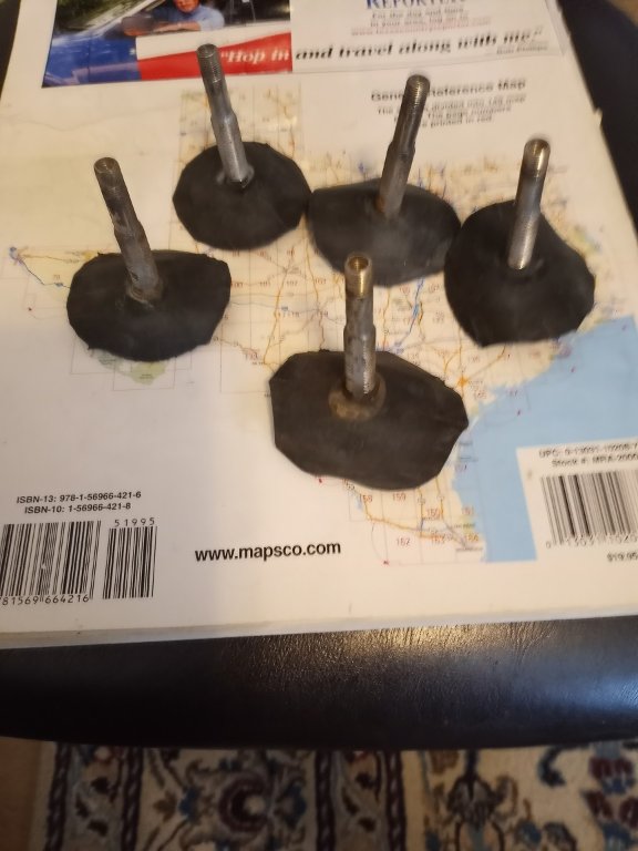

Terry, it would help a lot if you could show a picture of the underside of those stems. Are they the old clamp on type or the newer vulcanized type. Is there rubber under them or an exposed metal flange?
Here you go.
Posts: 2057
First Name: Jeff
Last Name: Humble
Location: Charlevoix, Mi
Board Member Since: 2006
Re: Used Metal and Rubber Stemmed Tubes; Worth Anything?
Post by Humblej » Thu Mar 16, 2023 10:28 am
Those are modern stems. Never tried to reuse them.
