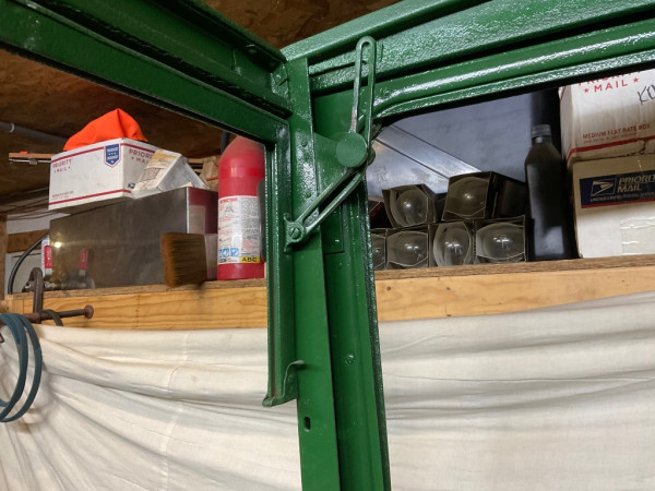

The 26 upper windscreen and adjustment is completely different than the ‘25 (the green one).

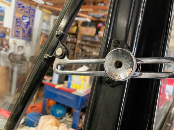

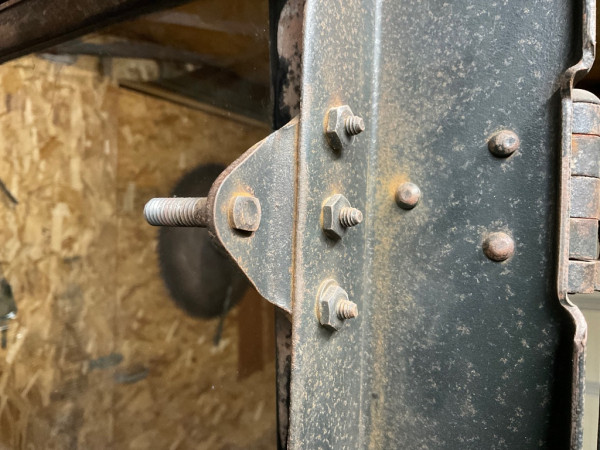

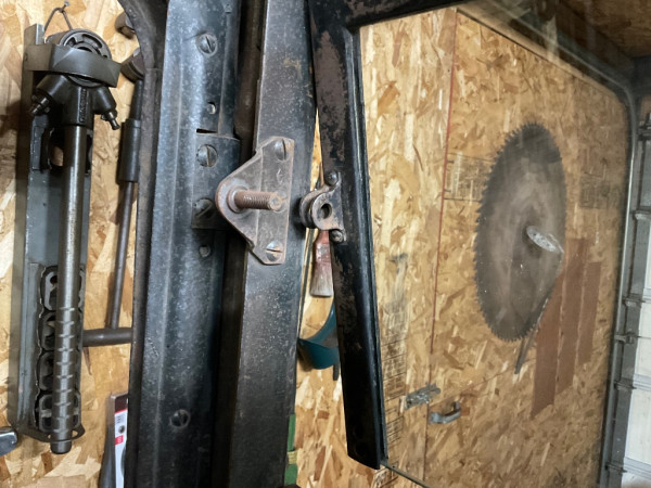

Thank you James. To further add to my confusion, both trucks( by serial number) are Oct of 1926 builds. I was told the green one was a ‘25, its not. So here are two supposed 1926 cabs built the same month with completely different screen adjusters. My green truck, like yours James, has the adjusting knob with male threads, the mating female threads being in the bracket that is riveted to the frame pillar. My black ‘26 has the bracket that is bolted to the frame pillar and utilizes a male stud. Having been restoring for nearly 40 years, I would argue that the attached pic shows a bolted up bracket that has likely never been removed or molested. The shown pic comes from the later build of the two trucks.

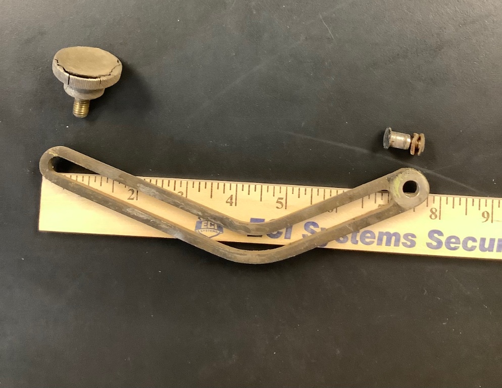

With the locking stud and the arm bracket at about the same elevation, I expect the arm to be straight or slightly curved and NOT the Angled type. Just my thoughts.

Terry, thank you for the research! I too would expect the slotted arm to be straight as shown in John’s pic. The offset lug would insure a tight closure with just a slight lift of the arm before locking. Maybe John can confirm the actual use. It looks to me that the TT windscreen was changed for the ‘27 model year. Maybe these same parts were used for early A’s?

On the 27 style as I close the window a slight upward push on the slide arm pulls the window tight. To help hold it open, I have filled a round Knoch at the wide open position on each arm so it drops over the tightner stud.
