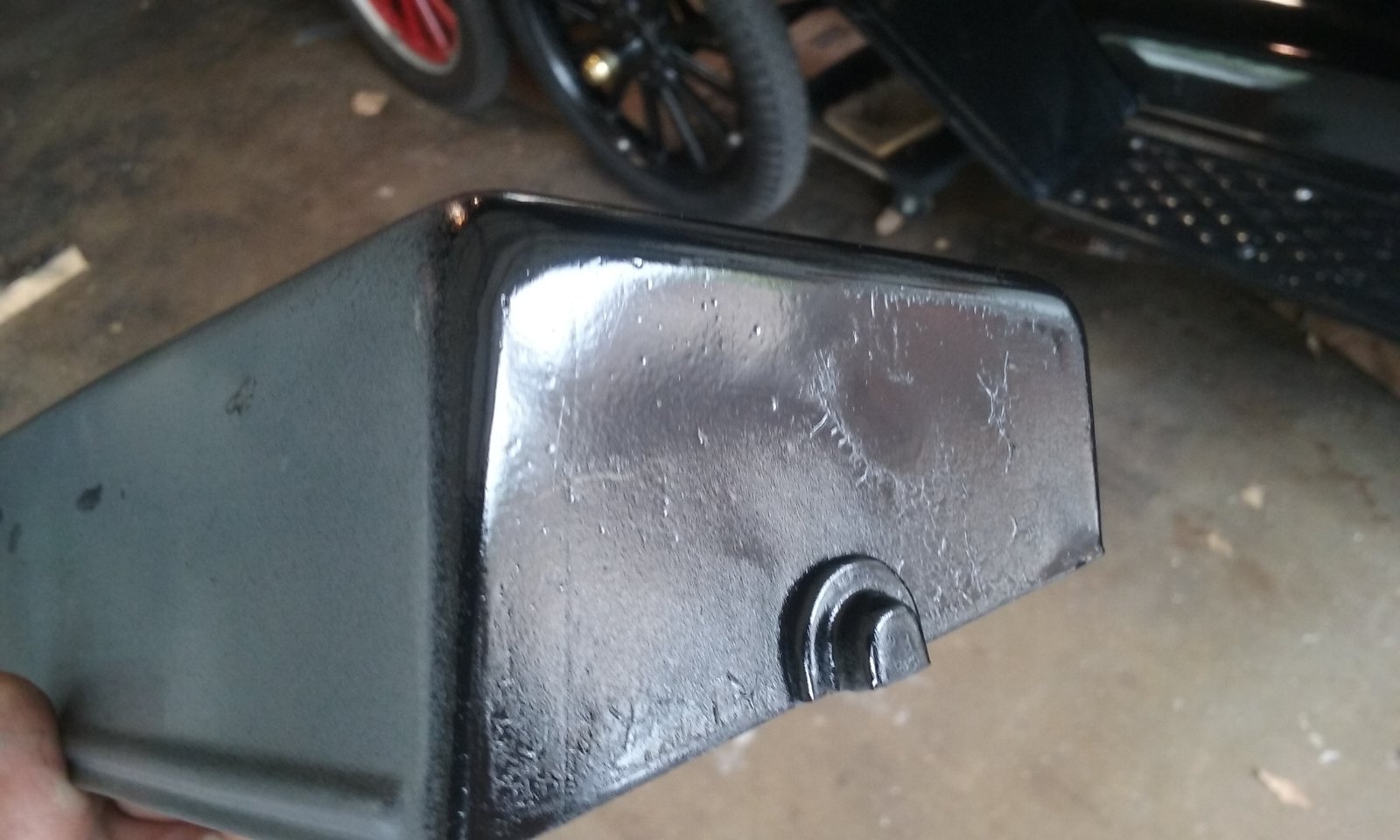

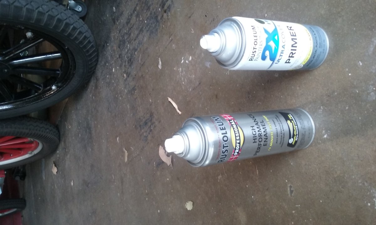

I recently primed and sanded a coil box lid in preparation for a new coat of black paint. Seconds after the black paint hit the primer it started to react with a cracking and spidering of the paint. I stopped immediately to reduce the amount I now have to sand of. I typically have good results with rattle can paint on small parts but this is also not the first time I have encountered this problem. My question is does anybody know what causes this and how to avoid it in the future? Both the primer and paint were Rust-Oleum products but I believe I have had the same problem with other brands in the past.

However. I also bought a can just like the one you show, the "High Performance Enamel". Written by me in big bold felt pen on the can is "LOUSY WRINKLES". I will use it up on things that do not show. I suspect it might be better protection than their other paints. And I don't know what sort of thinners they are using in it. But it does not give a good finish.

I have had good luck with the Rust-oleum High Performance Enamel. You have to closely follow the instructions on the can. If it says wait 10 minutes to recoat, watch the time and spray in 10 minutes. If it says wait a few minutes, I usually wait about five. If you can’t recoat in the specified time, you will have to wait at least seven days. If you don’t, it will wrinkle. Temperature matters, too. I usually don’t use primer under it, but if I do, I use the High Performance Primer. I wouldn’t try mixing different products even if they are the same brand.

A lot has to do with primer-less paints in they use an aggressive solvent of natural organic base. This “junk” is a nightmare. If you require using a spray can, try using a good quality such as Dupli-color etching primer first with very light coats. Let cure for about 2-4 hours and then overcoat with their gloss black or what ever color.
Try staying away from big box paints that state, “no primer needed, or for all surfaces” big red flag to a paint guy. Just like one size fits all.

Hi Chris. One of the two, primer or top coat, contains something like xylene or toluene, etc which will react with enamel paints. We used to get this interaction if you sprayed Lacquer on an enamel primer. One of the reasons they say to wait for a full dry cycle. I try to stick with the same brand of rattle can paint and primer. I have had good results with ACE Hardware rattle can paints for those misc small parts. So let it dry good, sand it down and use the same brand of primer as the top coat and you should be good. If your not sure, do at test on a piece of scrap metal.

Thanks to everyone with for the input. It sounds like the types of primer and paint along with letting them cure seem to be the keys points. I'll make some changes and give it another go.
