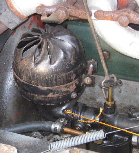

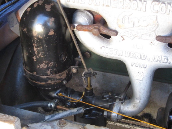

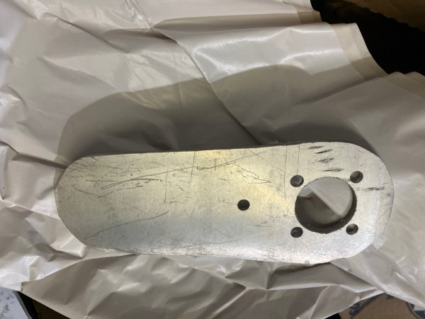

Dennis Prince
Posts: 413
Last Name: Prince
Location: Madras Oregon
Re: Air Filter
Post by Dennis Prince » Mon Mar 13, 2023 10:12 pm
This has been discussed before and I have ask if the people who say that a filter will change the way your T runs have ever run a filter? So far I have never gotten an answer. I have run filters on all of my T and it doesn't change the way they run at all (as long as they are clean, just like any other motor)and I feel better knowing that my motor is not ingesting a bunch of dirt. My filters are designed to preheat the air as well.

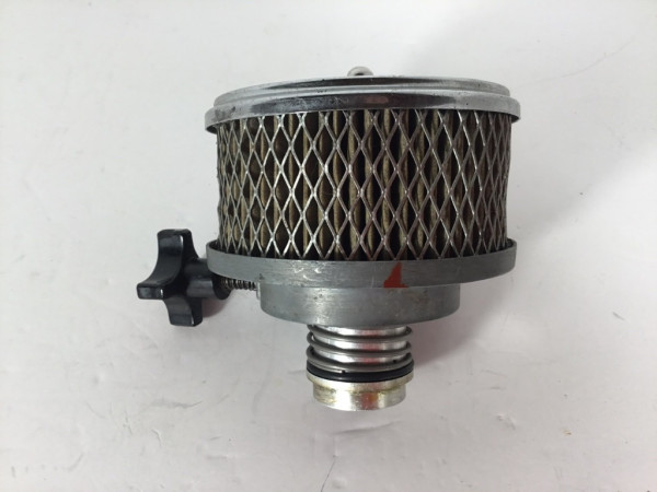

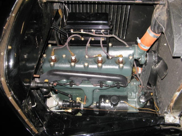

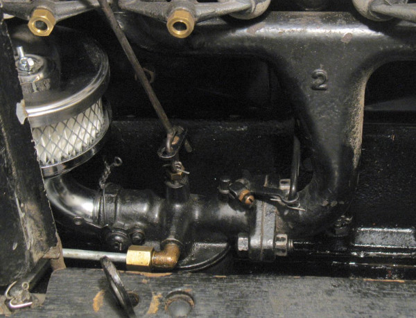

Post by Steve Jelf » Mon Mar 13, 2023 10:37 pm
Rather than speculate about how many fairies can dance on the head of a pin, I decided to try a filter and see what it would do. I bought a generic filter at O'Reilly for about $20, stuck it on a piece of sink drain, and wired it to my NH. Why? Because I do a lot of driving on unpaved country roads. I also use engine pans for the same reason.
I haven't detected any choke-like effect. Sometimes I've seen sweat on the carb and intake, but so far no "freezing up". As Dude Lester said, "It don't hurt the runnin' of it none."

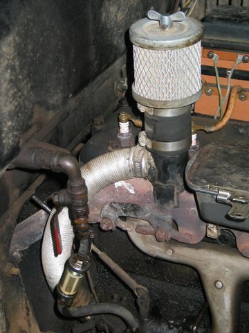

Since that initial installation six years ago, I've replaced the baling wire with some DIY mounting hardware.
I hope I haven't voided the Ford warranty.

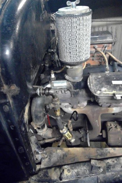

Post by jiminbartow » Mon Mar 13, 2023 11:13 pm

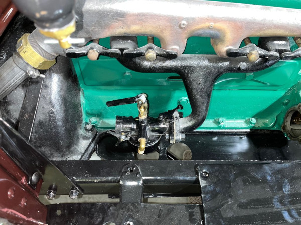

I would say No! I have had my 1926 Coupe for 53 years and have always sought ways to make it run better from experimenting with all types of timers to using a filter in the hope it would keep impurities out of the engine. For several years, I experimented with a very well made filter on my 1926 coupe. While it looked good and probably kept the engine cleaner, my T never ever ran as good with a filter as it did with the hot air pipe, so I went back to the hot air pipe with no ill effects. Apparently, it has something to do with preheated air entering the carburetor. Ford engineers always knew what was best for the T, so I have stopped trying to second guess them. Now my engine is the way it was when it left the factory. No filter and the original roller type timer and it now runs great!
Second photo is my engine with a filter. Last photo is my engine now, with the hot air pipe reinstalled. I will never use a filter again. Jim Patrick

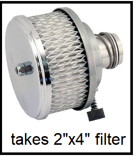

Thought I see if there was a way to calculate proper air filter size and came across this site https://www.onallcylinders.com/2013/11/ ... ze-engine/
Just using these values for a Model T engine in their calculations to see what might be suggested
Displacement 176.7 cu” Brake H.P. 22 at 1600 R.P.M.
Two factors dictate the filter size (area of the element): the engine’s cubic inch displacement and RPM at maximum horsepower.
A = (C.I.D. x RPM) / 25,500
A=(176.7cu x 1600 RPM) /25,500 = 11.087
With the effective filtering area established, the required element height (including the rubber sealing edges), where H equals height and D the estimated maximum element diameter that will fit in the engine bay. The .75 figure is to account for the element’s rubber sealing edges: Going to assume a 4" diameter. The H value will indicate
H = A / (D x 3.14) + .75
H = (11.087 / (4" x 3.14)) +.75 = 1.63 inches height for a 4" diameter filter see attached
H = (11.087 / (2" x 3.14)) +.75 = 2.515 inches height for a 2" diameter filter
The issue with carburetor freezing is a very valid one and should not be ignored.
Now these values do not take into account the porosity of the filter element.
These dimensions are close (minimum) to what suppliers are selling and what people are using. So if you use one, bigger is better and use the least restrictive element possible.
filter 2x4.png (83.43 KiB) Viewed 5100 times

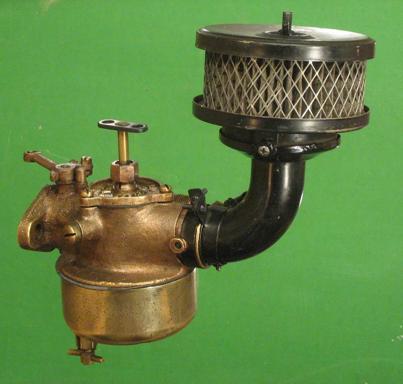

Ask yourself: what happens when I flood my carb and how flammable is a fuel-soaked paper or foam element if my car backfires after flooding?
Look at every ad for a period "T" air cleaner...every one I've ever seen is mounted on an elbow and is well above any point where raw gas could collect. If I was EVER inclined to run an air cleaner, it would be a period "cyclone" type that was mounted vertically and above the carb's bowl...I sure would not put a Briggs and Stratton foam or paper element hanging off of it to collect the inevitable fuel overflow.

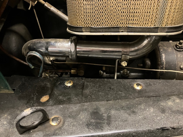

Post by Les Schubert » Tue Mar 14, 2023 10:06 am
The problem I see with most of the air cleaners pictured is they aren’t big enough. I will post pics of what I use. Quite available and doesn’t get in the way.

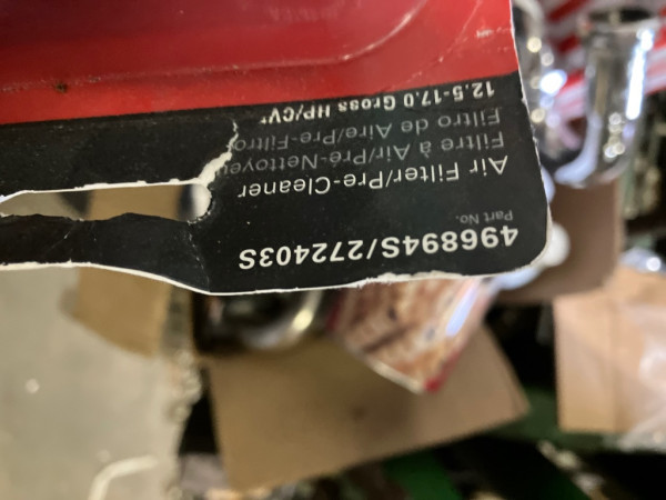

Re: Air Filter
Post by Dennis Prince » Tue Mar 14, 2023 3:45 pm
The picture I posted earlier was my first design, I have since changed to a larger more durable design. I have had this on the car from below sea level to over 13,000ft elevation and on some of the dustiest roads you can imagine and it has never hampered my performance at all. As a retired auto mechanic I can't bring myself to run any engine without filtering the air.
