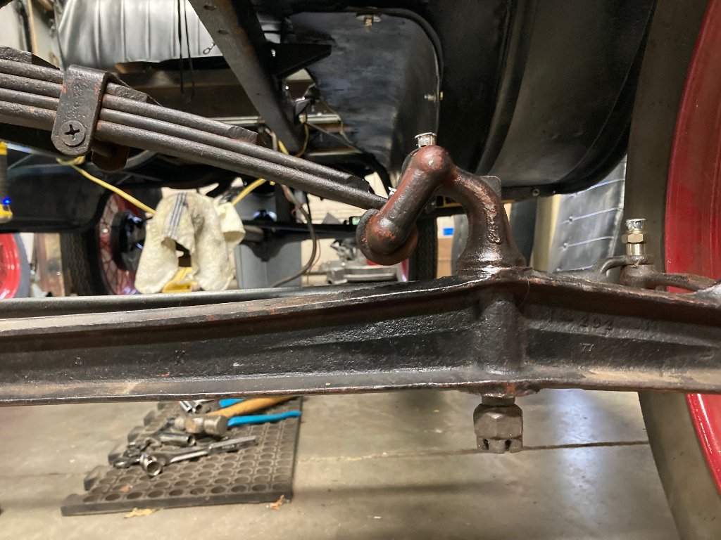

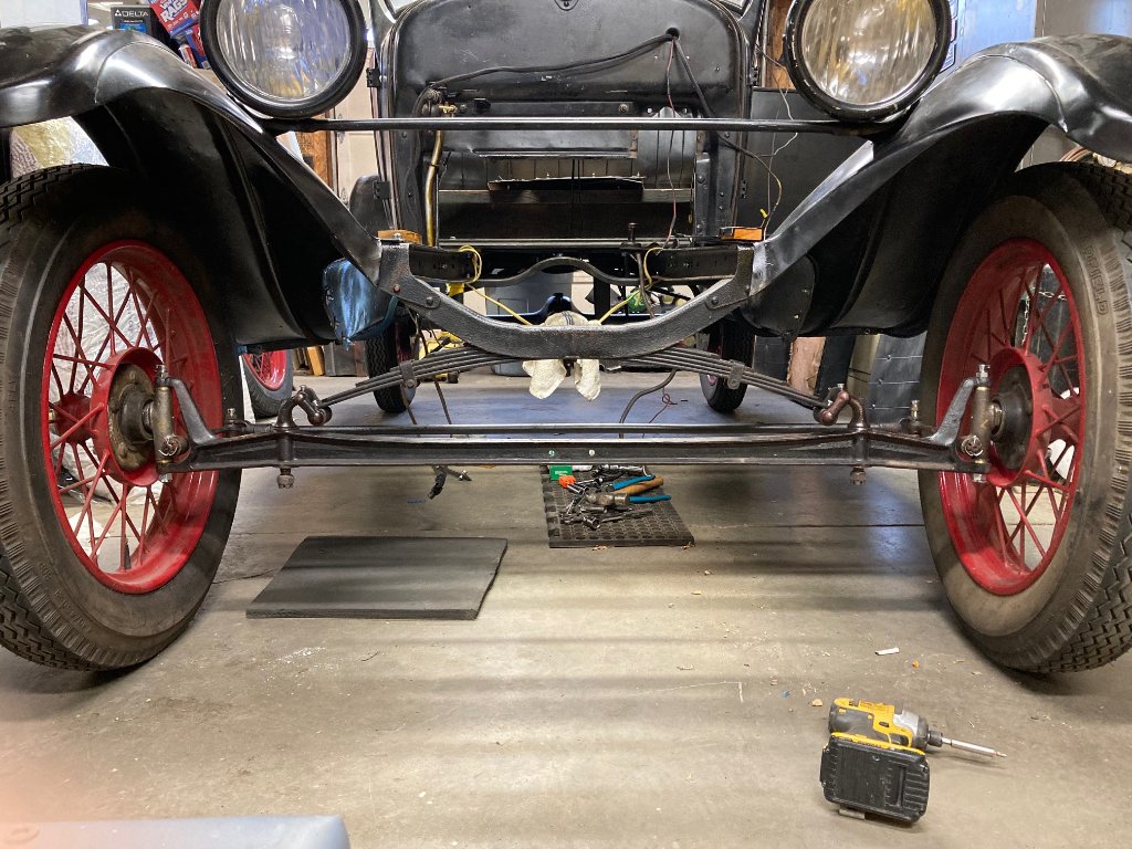

take a picture of the front of the car to show the installed curvature of the spring and then one close-up of one shackle (straight on) for review
generally speaking if you don't know the trick to installing shackles, a good spring will provide quite a challenge...if the shackles went in easily or are not being very much pulled "in" by the spring, you may not have enough arch remaining for a good ride.

Don't know if this will help, the engine is not in the car.

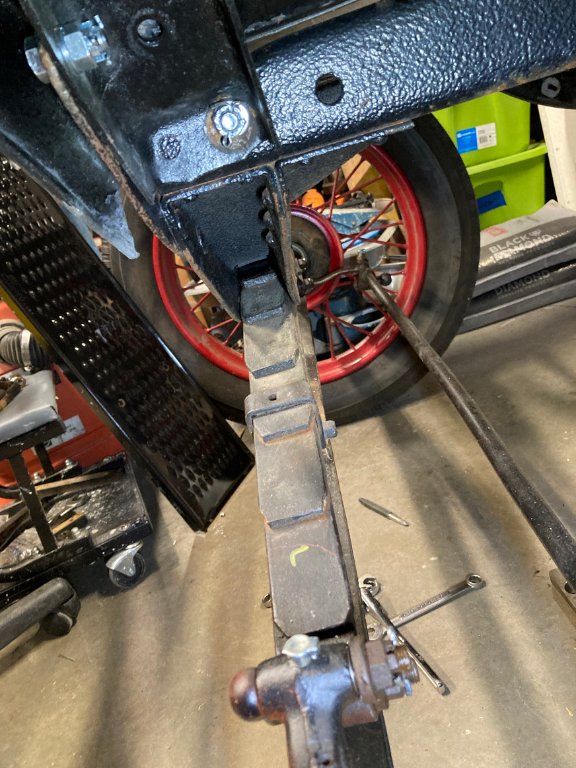

The engine needs to be in the car and the car needs to be at its road-ready weight to get any idea how much arch the spring has. What's going on with the spring perch nut?

Pictures are perfect but you're right, need engine in the car...
anyway, you can see how the spring draws the shackle "in" right now. If, when the engine is installed, the shackles go close to vertical, then that is an indication of the spring not having enough "spring" left. For now, I'll leave the rest of the discussion to folks who own your year car and can perhaps provide more and better guidance. Later cars are not my forte by a long shot.
I don't have the wishbone on.

Re: 1927 Touring, my front spring has 7 leaves, need 8
Your spring has a totally different profile than the 7 leaf spring. This design was adopted in 1925, They added one more leaf, and lowered the profile 1 inch. You need to find the correct spring.

That how it appears now, but there being no weight, I would not totally assume its an earlier incorrect spring.Original Smith wrote: ↑Sat Mar 18, 2023 10:51 amYour spring has a totally different profile than the 7 leaf spring. This design was adopted in 1925, They added one more leaf, and lowered the profile 1 inch. You need to find the correct spring.
Deal with it after the car is all together.
