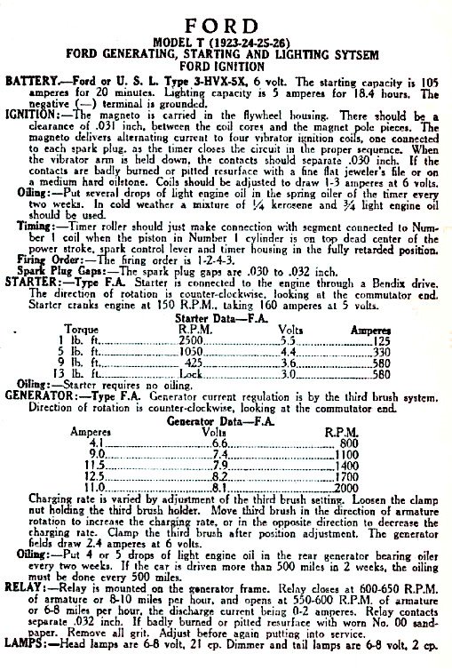

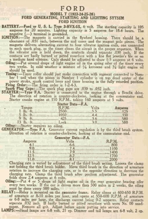

Re: Starter amperage draw?
In case anyone wants to print out Frank's sheet this may assist:
