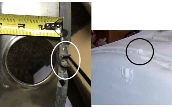

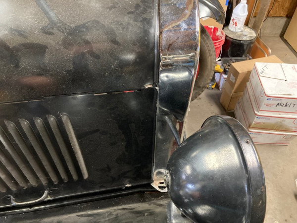

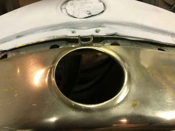

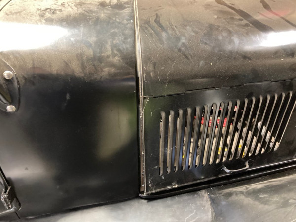

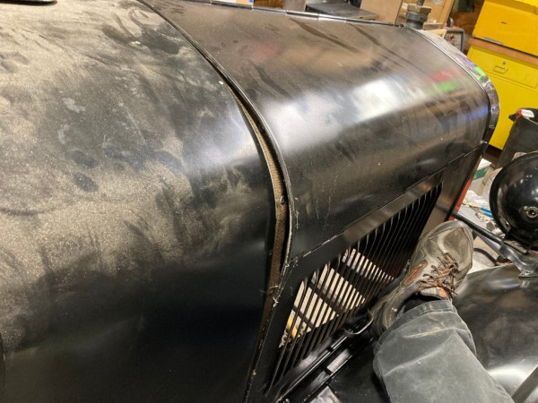

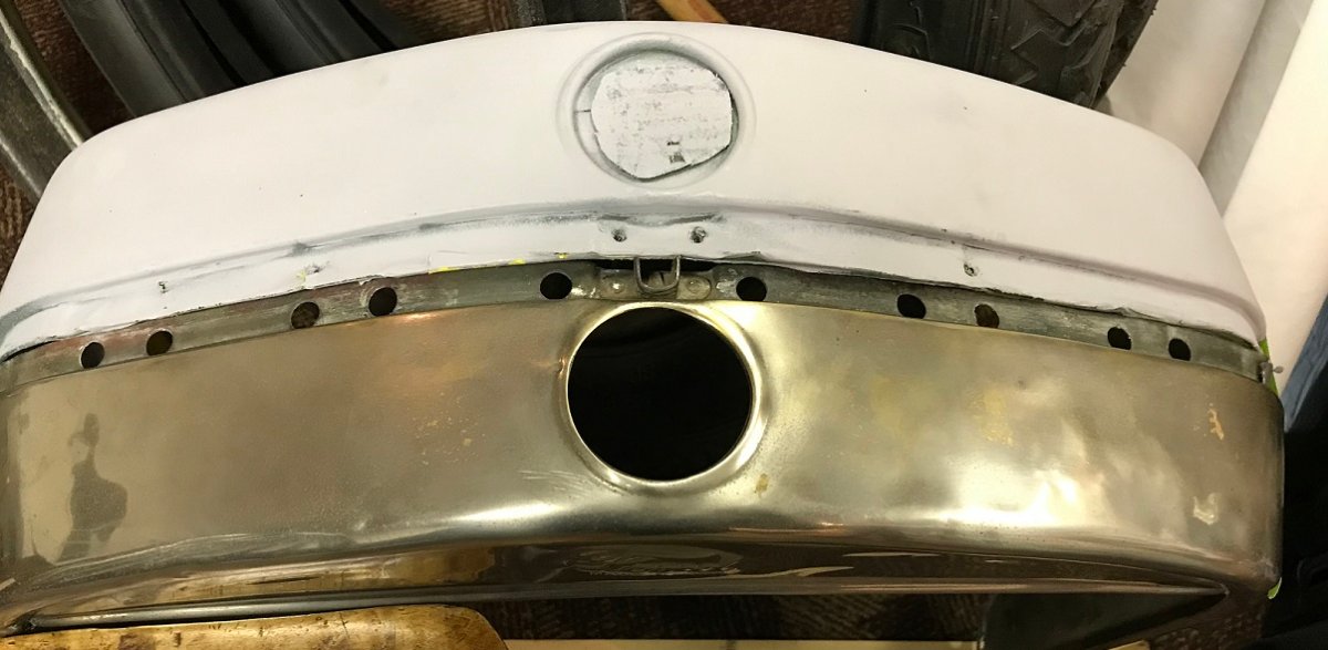

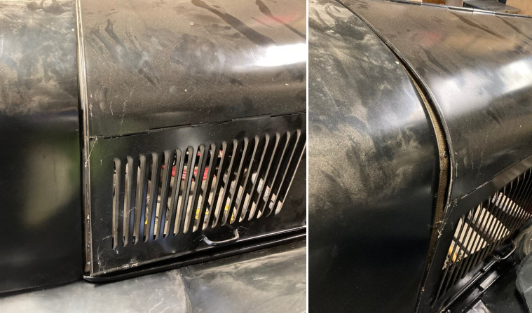

The radiator on my Touring has never fit right, I had thought it was the frame, it was bent and welded, I bought a new frame and brought it to frame shop and had them make sure it was correct per the frame drawing I have. Now that I putting it together with the new frame I am having the same problems, It's as if my radiator is to high, I can pull the bottom of the radiator shell out towards the front of the car which helps but can't pull it out far enough, the light bar is in the way, looking for guidance on what to check or do.
I can get one side or the other to fit but that moves the center of the hood on the cowl side to the left or right of center.

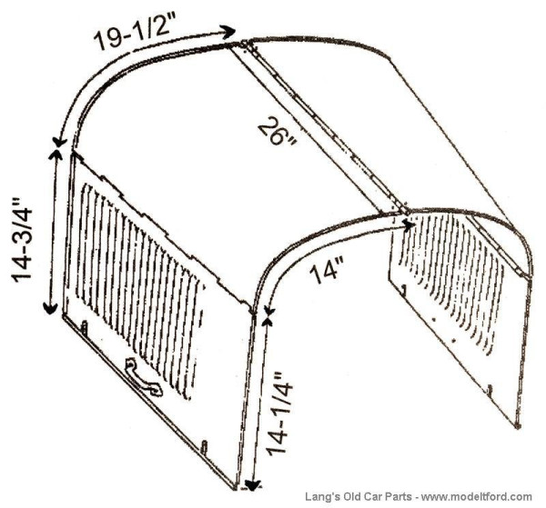

The top of the shell is 21-1/2" from the hood shelf, I've check the dimensions of the hood against the drawing on Lang's website, I'm stumped.
The 3rd picture is me holding the hood bottom edge where it should land when closed.

Before I'd mess with the hood fit I'd finish mounting the radiator shell, bottom & sides. What do the hood hinges look like, top & sides.
Pictures are needed
Next questions would be about the hood shelf and wood blocks. Then how the hood fit with the hood clips attached.
Pictures are needed

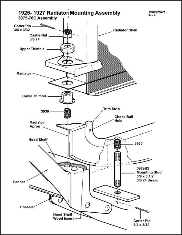

The bottom edge of the hood is not supposed to come all the way down to the hood shelf on either side. With the hood on the car and fitting the cowl and radiator shell reasonably well, and latched down, the hood sides will be about 5/8 to 3/4" above the hood shelves.
- Posts: 8479
Re: Help with radiator fit, 1927 Touring

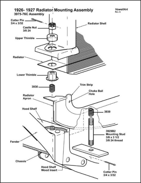

The radiator shell does not sit down flat on the frame or the hood shelves. It sits on springs a little higher than the hood shelf.

Since you have ensured that the frame is straight lets move on to the issue of getting it o fit when moving the hood left or right of center. The hood has to fit dead center so do you have a support bar from the firewall to the radiator and also these parts (hood rod clips) on the firewall & radiator that the hood hing bars rest in? This will keep it centered, The when the hood lips on the hood shelf are clipped are attached then the hodd should firbmklawt wrote: ↑Sat Mar 18, 2023 4:44 pmThe radiator on my Touring has never fit right, I had thought it was the frame, it was bent and welded, I bought a new frame and brought it to frame shop and had them make sure it was correct per the frame drawing I have. Now that I putting it together with the new frame I am having the same problems, It's as if my radiator is to high, I can pull the bottom of the radiator shell out towards the front of the car which helps but can't pull it out far enough, the light bar is in the way, looking for guidance on what to check or do.

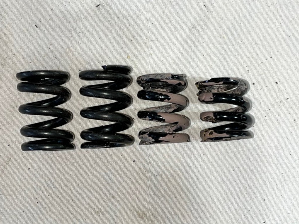

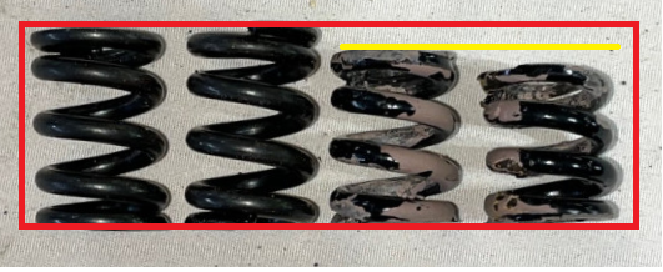

I looked at the November 8 and 9, 2019 posts, specifically the two from George N Lake Ozark and Mike Robinson. They pointed out that new springs were too long and stiff.
I am installing a new radiator on my 1927 coupe and found the same problem with my new springs (see attached photo). I have found two of the original springs. As a trial, I have put the old springs above the frame. Hopefully, I can find the other two original springs so I can use them inside the frame.
It is too bad that the suppliers don't provide springs that match the original.
Yes, it is, but suppliers sell what is available at spring manufacturers.It is too bad that the suppliers don't provide springs that match the original.
This is an Excellent example of the difference between restoring the entire car vs. simply throwing away or losing all of the original fasteners and expecting to just buy perfect equivalents off the shelf
Lee Spring offers 490 different possible springs for this type of configuration. Perhaps one off the shelf will fit: https://www.leespring.com/compression-springs-hefty
They will also custom-wind exactly what you want...just spec it out and buy a bunch of them to meet the minimum order. Order them here: https://www.leespring.com/custom-quote-request

Just thought of this, the cowl is bent up around the stanchions, sometime in it's past to looks like the car hit something at the stanchions and bent them back. Both front doors are a little hinge bound and look a smidgen higher on the striker side than the hinge side. It appears to me if I were able to bend the cowl up at the hinge that might make the hood fit better and bring the open side of the front doors down to line up with the striker better, I haven't a clue how to check that, I've been looking for a cowl for a few years now with no luck.

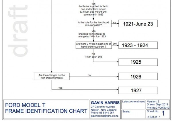

I'm assuming I have the correct frame, can't read the serial number but it does match up with the original frame, bought 3 frames before I learn the difference between the years

If the frame has a plausible number stamped on the top near where the right front door is, it's almost certainly correct.
If the body was in a rollover or heavy frontal collision, or if a tree or barn roof fell on it, it may have a number of issues. Body dimensions are available for Model As. I don't know about Model Ts. Having another touring car on hand that is straight for comparison would be helpful. I think the dimensions for a 26-27 roadster would be the same as a touring from the back of the front seat area forward.
Pictures of the body damage prior to any repairs might be helpful.

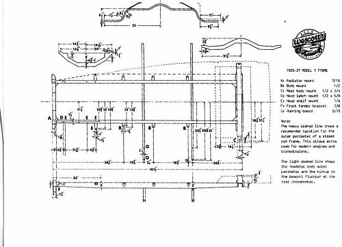

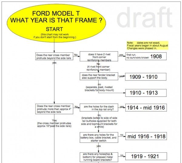

- Posts: 6553
1926-27 Frame dimensions
Frame Identification

And yes I also bought new radiator mounting springs along with some screws in my 24 Coupe rebuild and wound up using the originals I luckily saved and boy was I glad I did !
The new ones were too long! I carefully cut off a little of it but chose to use the originals. I buffed them with a wire buffing wheel, painted them and all was good. The radiator fit and was aligned just fine.
Sometimes when we get started restoring a T it’s really tempting to add all new parts as much as possible and especially the fasteners. You can find cans of nuts, bolts, radiator springs and etc in boxes on trailers and pickups at swap meets from others who gathered them up from home or wherever.
It’s best to keep all the fasteners and small parts.
