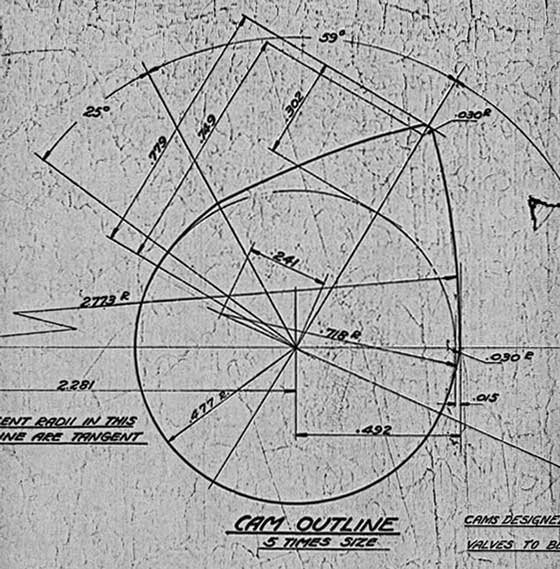

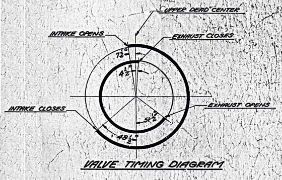

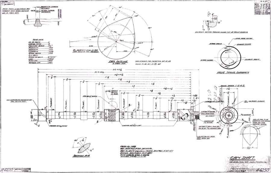

A couple of questions regarding using the 'A' camshaft;
* Will a SCAT crank turn with clearance when using a Model-A camshaft?
* What is done to to the front of an 'A' camshaft to use a T Commutator?
* Anything needed on the rear of the 'A' Camshaft journal??
I know that a stock Model-A camshaft lift is 0.287" when it has the 0.304" lobe (-with 0.015" lash), -and the Valve Duration is about 236° with a centerline of lobe separation of about 112°, the so in a time where new camshafts are unavailable, maybe this would be very similar to the lift of the 280 Stipe Cam?? TIA!
