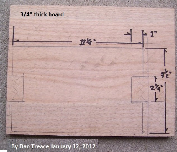

- Posts: 6581
Re: New Battery
Here is the "shim" for the underside. Also available from suppliers (maybe) . You should also shim it so it doesn't slide, just a boarder on the bottom board. The hold downs are just to hold the battery down. Thickness is what you need.
