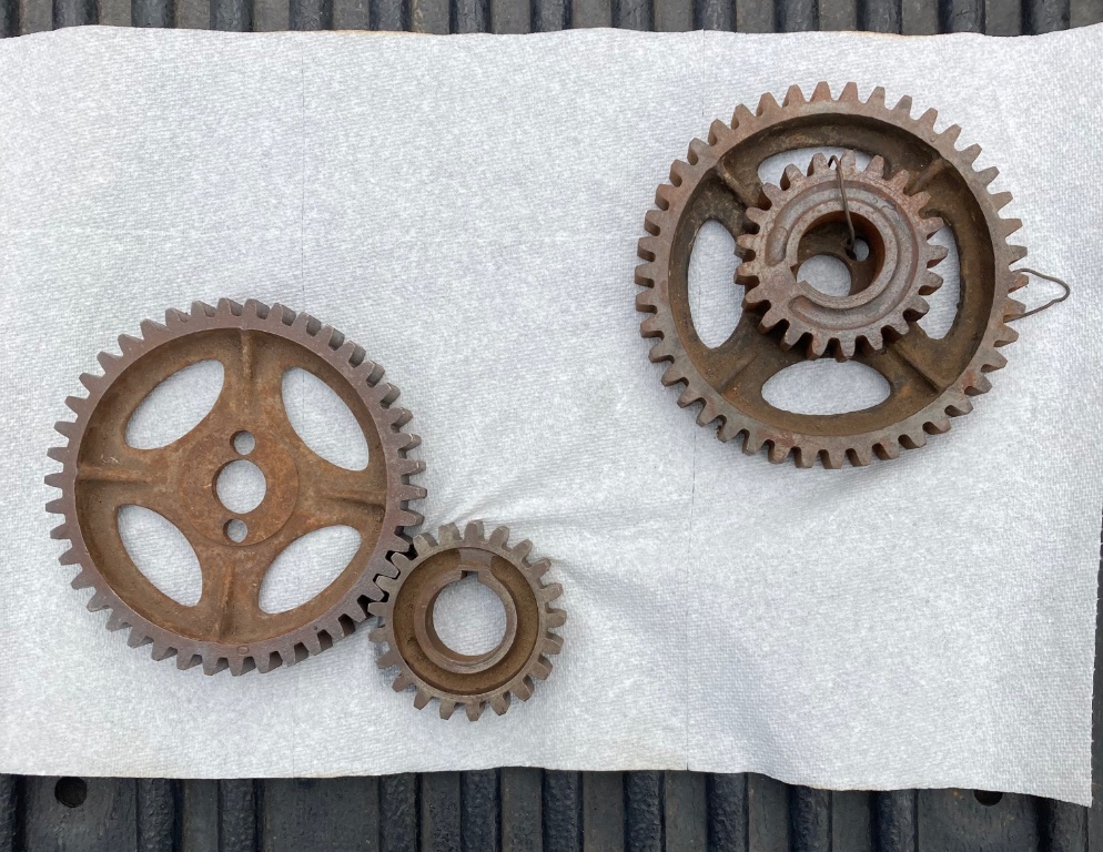

There was a good reason for Ford to change to the slanted teeth timing gears.
The slant provides a constant mesh of the teeth and a much quieter timing gear set.
