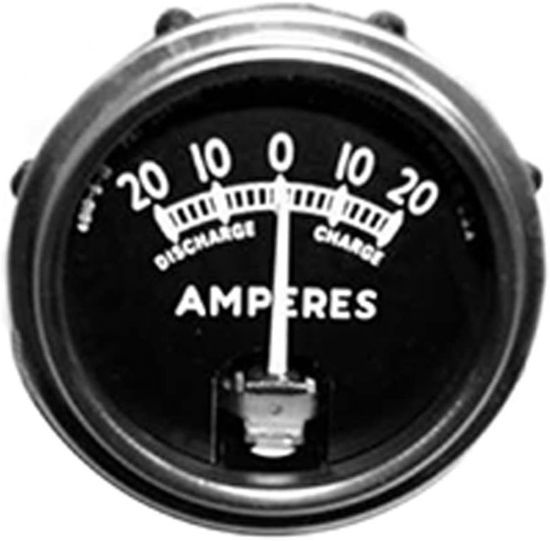

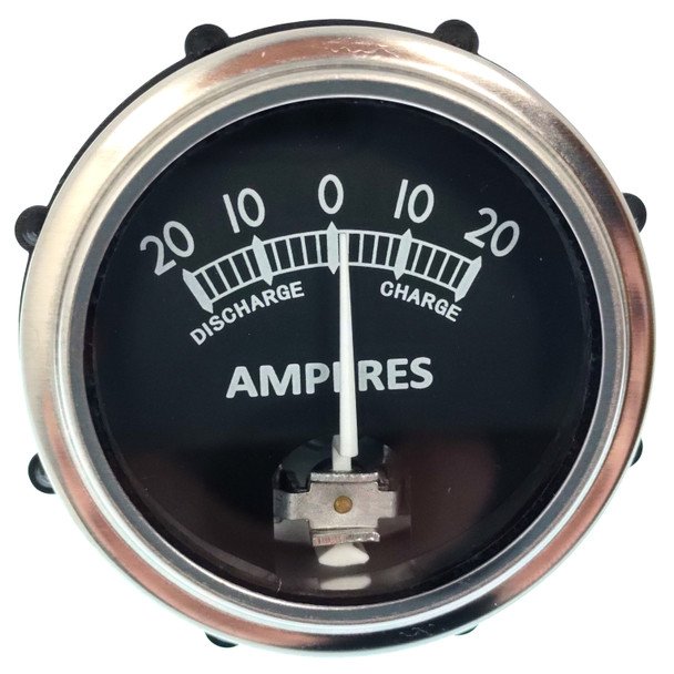

The old tractor guys may be Steiner. SteinerTractor.com 1-800-234-3280 the one pictured is for a 2" hole Order # ABC016 for Ford tractors
1939-57 but sold for most with a 2" meter. For a few dallars more you can get one with favorit tractor logo.
