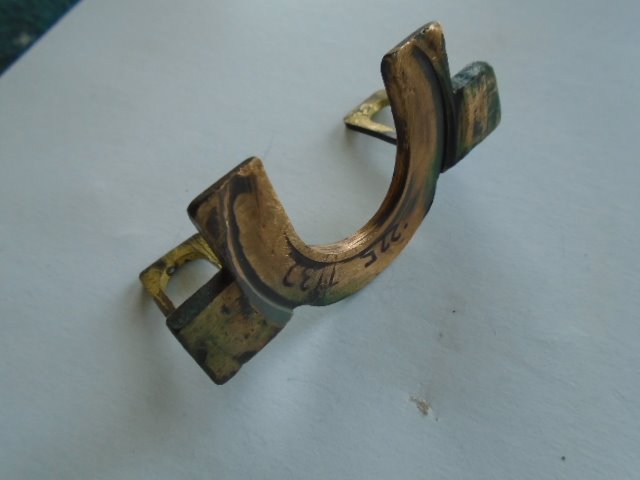

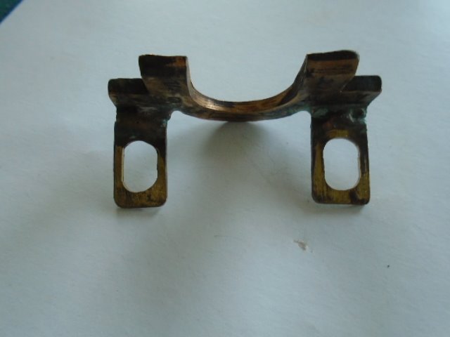

I would say he most probable is excessive end play in the crankshaft. In the day there was an accessory sleeve that fit behind the front pully (it was like a brass washer) that took up the end play slack.
