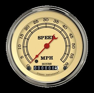

Post by Roger Byrne » Sat Mar 25, 2023 8:02 pm
Thanks for the comments but I'm not talking about a phone app. I'm wondering about the GPS units that look like a speedometer used on boats and ATVs.

Post by Junk poor » Sat Mar 25, 2023 9:49 pm
But Roger, that only goes to 60mph.

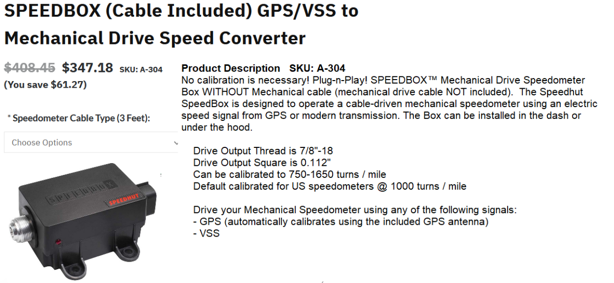

Post by TRDxB2 » Sun Mar 26, 2023 2:46 am
I was going to look into this awhile ago - might work with a period correct speedometer. The only issues may be matching up a speedometer cable and 12v.
https://speedhut.com/categories/speedbox.html
Instructions https://speedhut.com/content/instructio ... -10-16.pdf

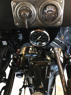

Post by Nunsio1 » Sun Mar 26, 2023 8:52 am
I have a marine GPS speedometer from Cabelas approx $90.00. It is a 12v unit, just power & ground to install. Running with dist ignition, no issues.
John
Oscoda Michigan

Post by Roger Byrne » Sun Mar 26, 2023 11:25 am
Thanks John, that was the type of installation I am interested in! By the way Dan, they make them in a 120MPH version so it could work for guys like you too! ;)
