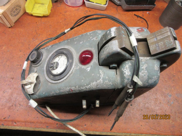

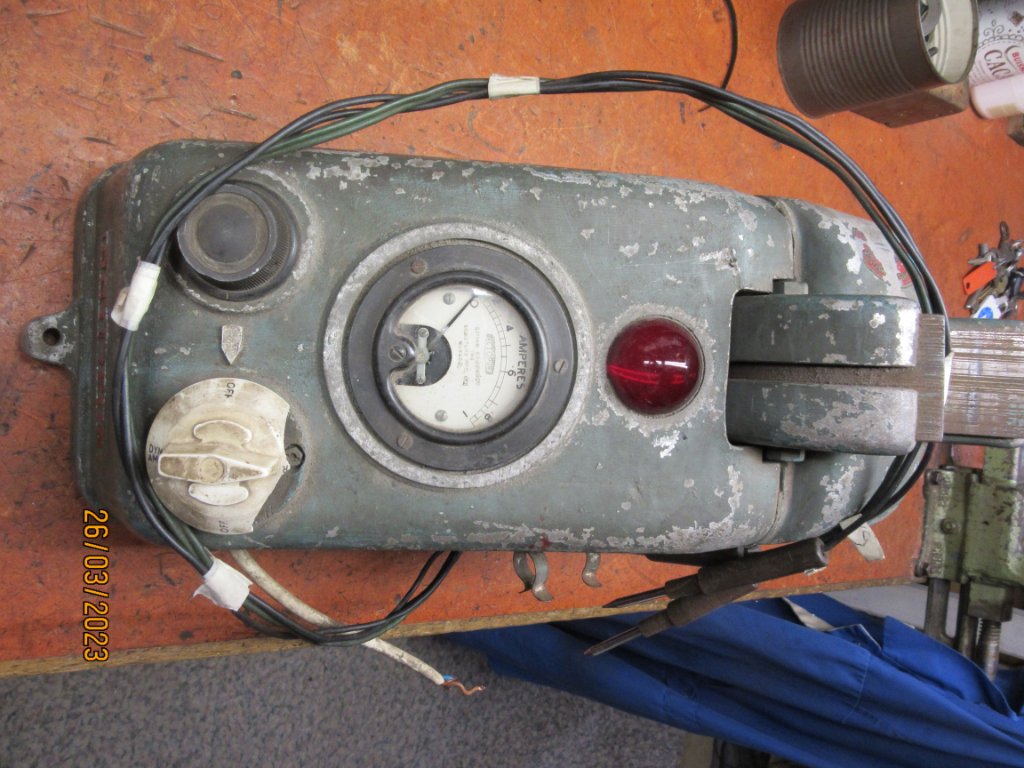

From a friend I got a Octopus Growler ,he is made in England .
Here in the Netherlands we have 240 Volt AC .
So I like to know or this growler is 110 or 220 [240] Volt .
Thanks for your answer .
Toon

I might start by pulling out a light bulb and search its voltage.

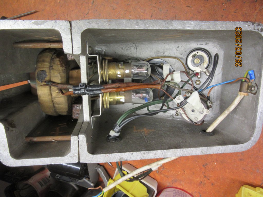

Not an expert but seeing the type of bulbs installed, I would think it 240. North America made unit would have screw in bulbs. You could take one of the bulbs out and see what is stamped on it.

Check the Voltage of the Red Bulb..
I'm thinking the two clear bulbs underneath are part of a Current Limiting Circuit.

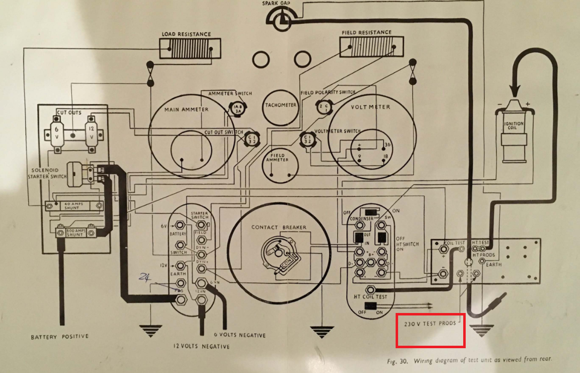

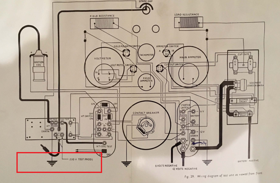

Just in case you don't have it. Found on the internet - operating instructions. Looks like its plugged into another device . I would also suggest checking the bulb for voltage

I'm think that the growler is hooked up to a main device for power leaving it up to you

Seeing that it's British, uses B22 based bayonet light bulbs, and has the European colour code for the mains cable, it can be assumed to be 240V.

Not enough information. The manual pics show an ignition and generator test machine. The growler appears to be a separate unit with its own power supply. I don't believe the test prods shown in the illustration are meant to be connected to any power supply.

See the Wikipedia article on growlers. It explains their basic function and how they're used. It has a picture of a growler similar to the one under discussion. If you look carefully at the picture, the label indicates that the unit pictured in the article is for 120 volt AC. I'd guess that the Octopus growler is intended for 240 volt 50 cycle. The basic growler is a fairly simple device. The Octopus growler appears to have more than one function. It ought to have an on-off switch and some evidence of where the power supply is , or was, connected. The test lead function probably would not need to work for the growler function to work.

Hey Toon, engels en al wat ouder dus 110V de bajonet fitting van t lampje is ook typisch engels voor 110V, hier aan onze kant van het water en in de USA gebruikten we al lang schroef fittingen voor verlichting op iets anders dan laagspanning (12/24V)
Mooie vondst, je kunt m gebruiken met een "reistrafo" voor 220 naar 110v.
