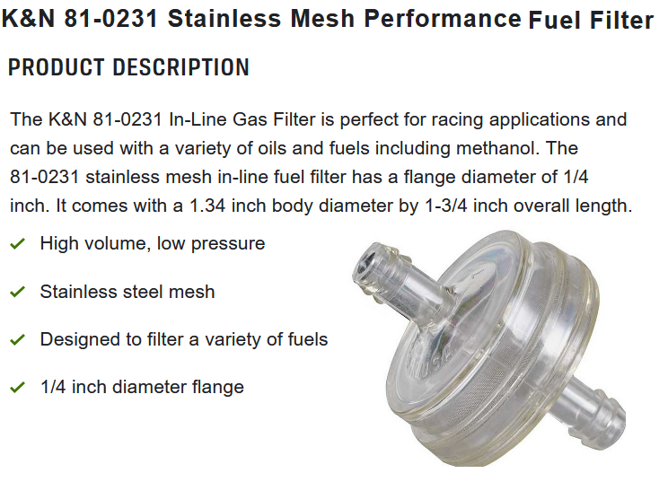

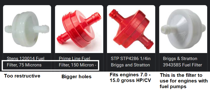

"I put a temporary fuel filter in the line. It is a riding mower filter so it is a little higher flow than some."
Likely the issue. There are several riding mower filters (some looking alike) but rated for different HP engines.
These have a simple round mesh much like what's in the sediment bulb but a finer mesh and in some cases requiring a fuel pump. Any of the cylinder types are likely requiring a fuel pump
As an example of similar ones --
Then there's this - but what is "low pressure"?Atmospheric with gravity assist?

Physically small filters have a very limited capacity to collect debris or moisture without becoming restricted or outright plugged. Any added filter will add restriction.
An added filter is not necessary, nor is it a good idea on a gravity feed system, and it's an especially bad idea on a Model T with an under the seat gas tank.
