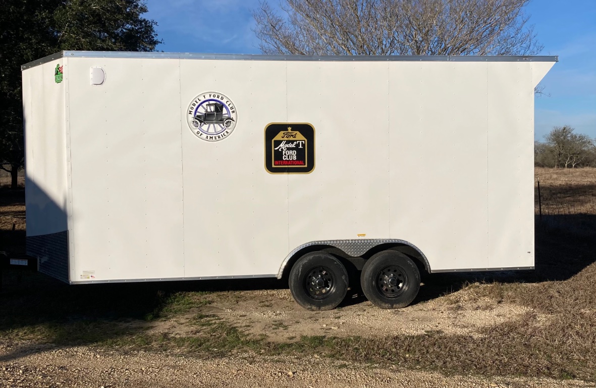

Re: Enclosed Car Trailer Optimal Size
Wow ! That was a ton of advice...The trailer I ordered built up in Hillsboro is 18’ long to accommodate a TT C Cab stakebed. It’s 8.5’ wide and 8’ tall to accommodate the ‘14 runabout w/ top deployed or a Centerdoor. I have 4 D rings on the floor and they immobilize my Ts nicely. Yes, I agree you’ll only need a 16’ trailer to only carry Ts or As. That’s fortunate because, in my research, trailers come in 12,14,16 and 20 foot lengths. I also like Jim’s suggestion of having no roof vents. No worries about tree limbs destroying it. Vents on sides.
- Posts: 3743
- Last Name: Wrenn
George, how do you keep that trailer so clean! Or is the pic when it was brand new? Or maybe you keep it inside a barn. When I bought my second trailer I got the taller one, wider one, and it's 20 feet. At first I wasn't sure if I'd like the 20 foot but now I would say get the extra length and go 20'. It sure is nice for working on the car when it's in there if needed. I keep my '13 in it all winter in the barn with a heater inside, I insulated the ceiling. On low setting it keeps the trailer between 40-48 degrees depending of course on how cold outside it is. Costs about $1.50 a day to heat it.George House wrote: ↑Mon Mar 27, 2023 8:00 amWow ! That was a ton of advice...The trailer I ordered built up in Hillsboro is 18’ long to accommodate a TT C Cab stakebed. It’s 8.5’ wide and 8’ tall to accommodate the ‘14 runabout w/ top deployed or a Centerdoor. I have 4 D rings on the floor and they immobilize my Ts nicely. Yes, I agree you’ll only need a 16’ trailer to only carry Ts or As. That’s fortunate because, in my research, trailers come in 12,14,16 and 20 foot lengths. I also like Jim’s suggestion of having no roof vents. No worries about tree limbs destroying it. Vents on sides.

"Minimum 0.30” aluminum exterior
siding attached at every side
structural member with screws."
This seems like a very thick skin? Maybe 0.030"? Excellent and complete list of specs regardless, jb
Anything to save labor & material on the assembly
line is what trailer manufacturers try to do.
0.30” is stock on most trailers.
You get less “ ripples “ as time passes.
With 16” OC sidewall framing and exterior
aluminum screwed to every sidewall frame
member you have a more stout wall and
a stronger trailer frame.
FJ
FJ

The only thing to add is -
Think about current price & resale value, in case you buy another T. Best to spend the cash then have regrets
Height will also affect your choice . Where are you going to park the trailer when not in use. Garage door height matters

Well when it comes to trailers to haul a T there's not an ordinary house garage door that would allow a trailer anyway. You either keep it outside somewhere or in a barn with at least a 10' tall door. I believe my trailer sits 9.5' off the ground to the roof top. I keep my trailer outside in summer empty and in the barn with the '13 in it and heated in the trailer in the winter.
