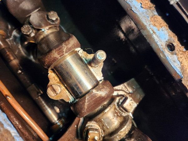

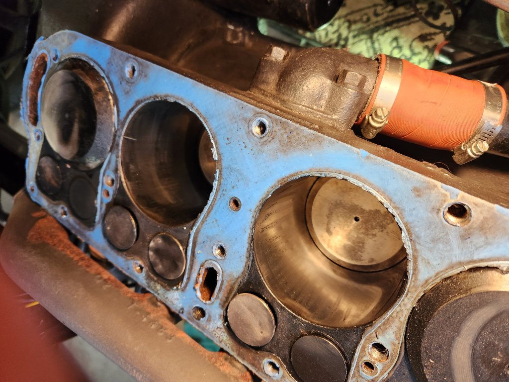

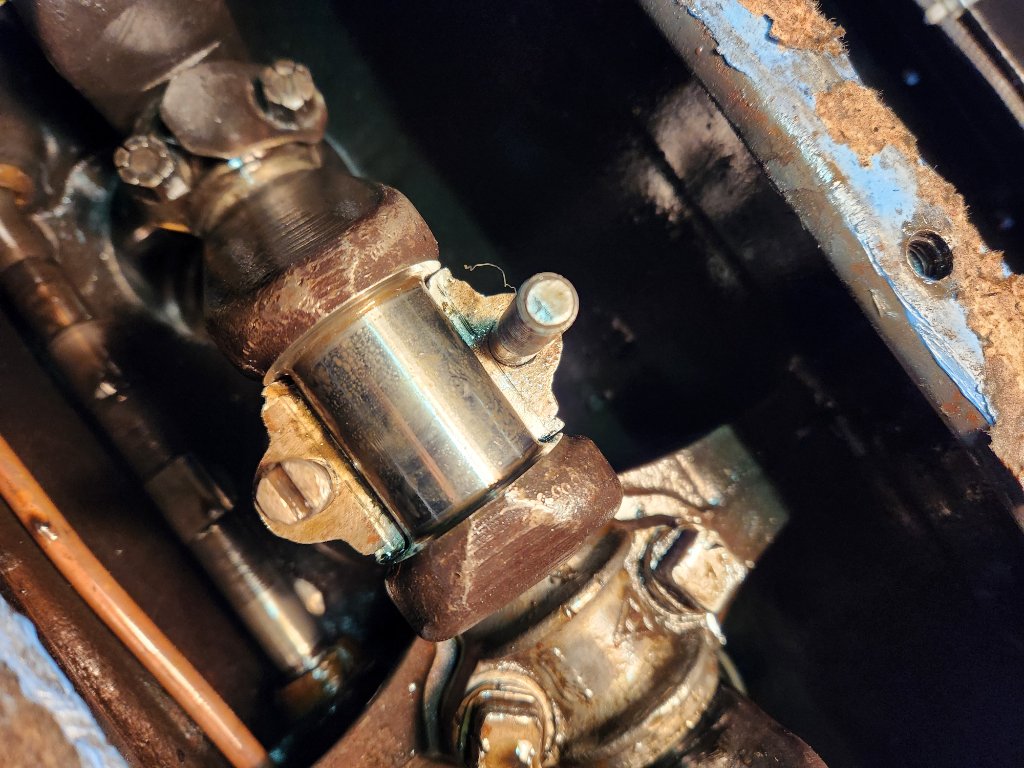

Greetings all -
Here is today's update:
Today I pulled the head, oil pan, valve cover and trans inspection plate. To my total amazement it all looks great as if it had been recently overhauled. The cylinders are Aluminum and the cylinder walls are smooth with no marks whatsoever-
There was no metal at all in the oil or the pan and the inside of the bottom crankcase looks pristine and clean -
The side cam guides, etc are all smooth with no real signs of wear. ( some heavy black carbon on valves.=.. mixture? )
Given it started and ran well (Except for the knocking) and there was no blue smoke at all - I'm going to say the top side and valves appear to all be good- - BUT - I still need to somehow inspect the piston wrist pins - which was suggested as a possibility --- Its not clear how that might cause the knocking that leads to a slow down - without scoring the side walls - but this is uncharted territory and who knows- I'm just not that eager to pull the pistons until I've gone down a few other paths ---
For the bottom end bearings;
No apparent slop in any of the bearings -
For now - I only pulled the number 2 rod bearing - I noted the number 2 rod bearing cap had only partial threads on one bolt and full threads on the other- Reaching over the top - the bolt holding the splash part was twisted and not set properly. ... it was torqued down tightly though-
When I pulled the rod cap - which was babbitted... the crank and babbitt were perfectly smooth with no burns, burrs, or scoring. everything looks almost new -
The front timing gears also look good - no chipped / worn teeth - and as far as I could see at least- the camshaft looked ok
(Hmmm... cam shaft bearings???)
On the transmission top cover removal - nothing looked loose or out of place - as far as I could tell -
so... what's next? flywheel, magneto, transmission?? I'm assuming I need to pull the hogshead to get to that?
I do have a Delco distributor - and I don't know if the flywheel still has the magnets- I'm thinking it might just to keep things in balance when it was overhauled -
other side notes: on the suggestion of a frozen clutch - it was apparently free turning free throughout the test loop - and I'm thinking the clutch wouldn't knock (???)
and last side note:
In my haste to see the rod bearing I didn't notice front vs. back - (Damn me!) There were 3 shims on both sides - and the bearing cap does have a no. 2 stamped on one side. Any other ways of knowing front to back?
Thanks again

If there is NO scoring or aluminum deposited, we rule out seizing pistons. Use a mirror & check em all well. Only takes one piston.
If the wrist pins are too tight, you should see heat discoloration on the wrist pin bosses. Look @ all 8.
When you removed the rod cap, did you move the crank out of the way & check for a free swinging rod?
The knocking increasing & stopping the motor still points to a piston issue to me.

In your second picture, one of the bolts is broken off or sawed off right where the cotter pin goes through. I wonder whether that bolt was hitting something and was sawed or broken off? Another thing to check since you have the head off is whether the piston tops might be hitting the head or the gasket. If the cylinder was bored out over about 60 thousandths, it could hit the head. Some heads are different from others.

hi - sorry for late reply - this is to be a fun car to take the kids and grandkid out - not a show or parade car - still - safety and reliability are the top priorities with cosmetics the least of my worries -Bill Robinson wrote: ↑Mon Mar 27, 2023 8:36 pmMartin- before we go any further, how about posting what you intend to do with the car once it's running good. For example- do you plan on showing the car, making it a fun driver- possibly touring with it, selling it, etc. That might make a difference.

Hi Norm - That is an interesting thought - The piston does seem exceptionally proud of the top of the block surface with the head off- but no signs of any sort of damage to either the pistons or the dead -Norman Kling wrote: ↑Tue Mar 28, 2023 6:03 pmIn your second picture, one of the bolts is broken off or sawed off right where the cotter pin goes through. I wonder whether that bolt was hitting something and was sawed or broken off? Another thing to check since you have the head off is whether the piston tops might be hitting the head or the gasket. If the cylinder was bored out over about 60 thousandths, it could hit the head. Some heads are different from others.
also
no cotter pins at all on any of the nuts -
- Posts: 5246
Re: knocking engine
These pistons dont have bushings. The Gudgeon pin moves in the aluminum casting.ElGranadaT wrote: ↑Tue Mar 28, 2023 5:57 pmspeedytinc wrote: ↑Tue Mar 28, 2023 4:52 pmIf there is NO scoring or aluminum deposited, we rule out seizing pistons. Use a mirror & check em all well. Only takes one piston.

I have to agree with Scott. Not seeing good things. I wouldnt trust anything that was done, transmission included.
This would make me do a complete tear down & rebuild To fix all the seen & to be seen problems. Then you can trust & completely enjoy your T.
May not be a costly parts issue, but more of an undoing of what was done wrong.
Modern chevy rod nuts dont need pinning, they self lock.
Model T pistons, original& replacement do protrude above the deck.

Yes, there's lots to think about here. For starters, when you eventually disassemble it all, take those pieces of sheet metal on the rod cap bolts, that are apparently intended to scoop oil, and throw them in the trash.
Also, if you remove the clamp bolts that hold the wrist pins in place, do NOT do so by simply putting a socket on them and twisting. You'll bend the connecting rod if you do that. With the piston and rod removed as an assembly, slide a steel bar through the hollow wrist pin. When you loosen the clamp bolt, use the steel bar to hold and support the wrist pin/connecting rod. This puts no undue force on the con rod.

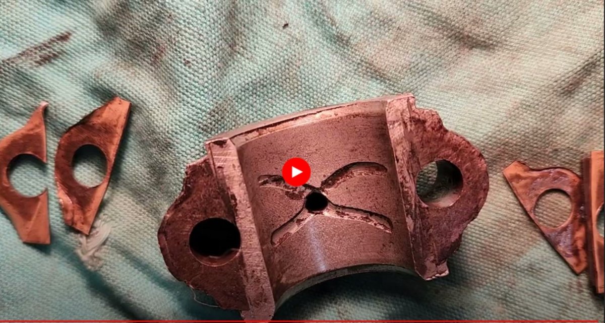

- Posts: 8630
Re: knocking engine
Abnormal side wear on the rod cap and rod babbit shown suggests the rod is already twisted.
- Posts: 4694
Re: knocking engine
Pat has a good eye! This might have happened while tightening the bolt at the wrist pin. Best way to keep it from twisting is to put a rod inside the wrist pin and clamp the rod in a vise. Then tighten the bolt and place the cotter pin. If you clamp the rod in a vise it is easy to twist it while tightening. You will need to find someone with a jig for straightening the rods. The pin must be in exact alignment with the crankshaft bearing.
- Posts: 1967
- Last Name: Tannehill
- Location: Hot Coffee, MS
- Board Member Since: 2002
Re: knocking engine
Looking at the rod cap & the rod still seated on the crank I see no sweeps or the X grove completed nor a radius cut completely or correctly in the cap/rod. Is the #2 cylinder showing some scoring? The other thing that I’m seeing is there’s not much or any clearance between the rod and crank shoulder preventing any side to side float. Bad juju imho.

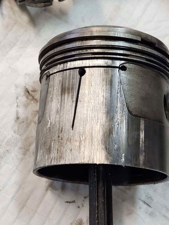

Thank you all again for the great advice.
I think I may have found the culprit - The attached image is of No. 1 piston - Its scored and the bottom of the cylinder is also scored -
the wrist pin slides very easily - with lots of play- No. 2,3,and 4 pistons are not that bad... and those pistons and cylinders have no scoring or discoloration.
Thanks to my local club, I was given a link to a local machinist who has the original Ford tooling and can handle a rework - I'll bring him the

- Posts: 8630
Re: knocking engine
Could be much worse. Pistons are cheap, as things go these days. The blue goop and improper rod bearing fit and compromised rod cap bolt indicate a need for further investigation.
- Posts: 5246
Re: knocking engine
Check that internal oil line. (it looks like a piece of copper tubing in a picture). I wonder whats going on with that.
# 1 rod & piston are the first to fail under a lack of oil.
Part of the why or one bore too tight?

you nailed it - Took it to Dave Rich in Forestville yesterday (excellent T machinist!) - The scupper from the hogs head was clogged with a piece of material from the brakes- and no. 1,3 and 4 wrist pins were loose- No. 2 wrist pin was very tight- The theory has it that Aluminum piston expands the wrist pin hole and the wrist pins begin to knock - I've heard a few people now comment that they had wrist pin failure. Seems the original cast iron pistons were better than the Aluminum -speedytinc wrote: ↑Wed Mar 29, 2023 6:27 pmCheck that internal oil line. (it looks like a piece of copper tubing in a picture). I wonder whats going on with that.
I live in the hills and a friend recommended a Texas T auxiliary oiler to the front of the engine -
I learn something new every day- too bad I'm starting to forget TWO things every day also...
