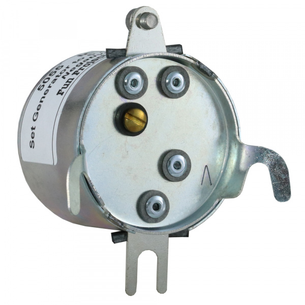

A couple of things. Do you have a known voltage regulator? If you’re unsure Take a picture of the “VR” UPSIDE DOWN & post it here before you start tinkering with it.

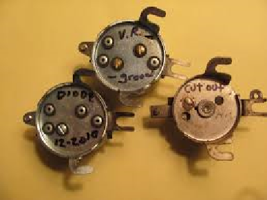

The Fun Projects Voltage regulator con be identified by the two screws & bent arrow tab (see above screw & right of the VR) on the underside. There are many different cut out configurations.
vr cutout.png (94.53 KiB) Viewed 3202 times
This is the Fun Projects cut-out. Only 1 screw and the arrow tab is not bent in
FP cutout.png (339.91 KiB) Viewed 3202 times

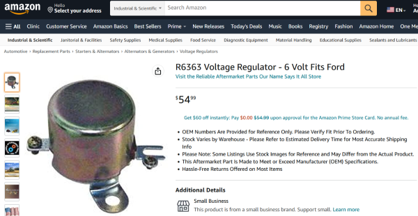

I don’t have the VR yet so I don’t know what the bottom looks like. It should arrive from amazon in the next week. It says R6363 Voltage Regulator - 6 Volt Fits Ford.

A true voltage regulator is a rare commodity today.
I am pretty sure thats not whats coming. It looks like a cheap manual cutout. $54.

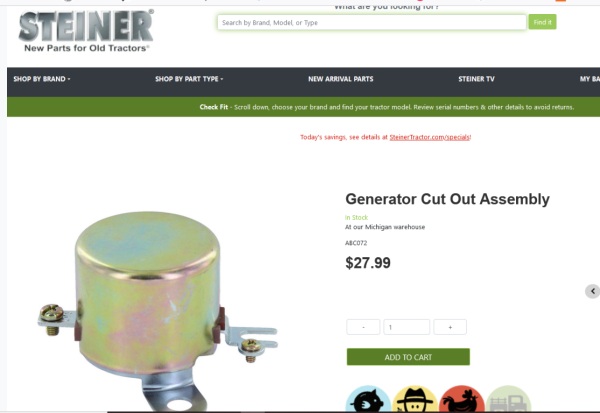

You are better off with a diode cutout than the cheap manual replacement cutouts available.
Here is an available replacement unit. Not correct in appearance, but more reliable than a manual repop.
Ebay #384413305329

Regardless of what it is called, you have purchased a simple cut-out. It's not actually a voltage regulator per-se, and it is unfortunate that the company decided to market it as something that it is not...likely out of pure ignorance rather than malice.

Don't give up yet. It may be for a Model A or Tractor. If so still usable but needs to be hooked up differently.
If it is only a cut-out you may be able to get your money back because it wasn't as described. Not sure what process AMAZON has or how yo paid.
I assume this is where you got it https://www.amazon.com/R6363-Voltage-Re ... B091SNW35C
Post a picture of it anyway and some of the instructions when you get it so we can confirm.
Please Note: Some Listings Use Stock Images for Reference and May Differ from the Actual Product.
This Aftermarket Part Is Made to Meet or Exceed Manufacturer (OEM) Specifications.
Hassle-Free Returns Offered on Most Items
But it does look like you've been duped.

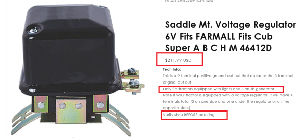

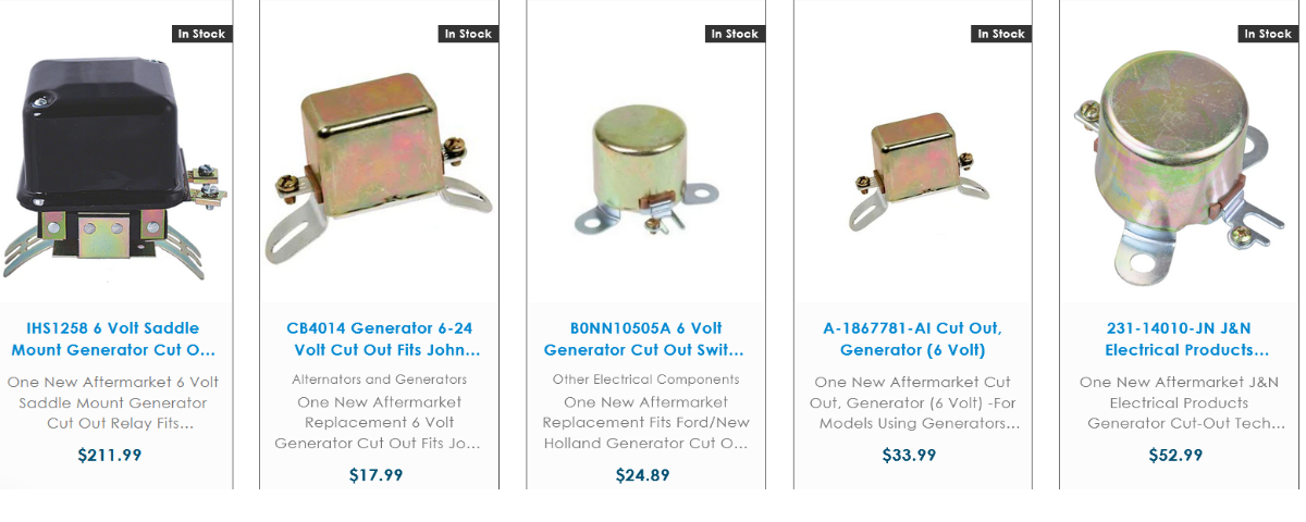

I skipped AMAZON and went to Reliable Aftermarket Parts site directly https://www.reliableaftermarketparts.co ... 0regulator
The do show your item as a cut-out
and interestingly show a VR for a 3 brush generator likely positive ground (case may require + ground)
Posts: 8714
Re: VR on generator
Post by TXGOAT2 » Tue Mar 28, 2023 1:52 pm
Looks like there is some confusion in the descriptions. Any non-electronic, OE type regulator will have more than 2 terminals. Any non-electronic device with only 2 terminals is almost certain to be a simple cut out.
An old style electromechanical regulator would require at least 3 terminals, usually labeled "ARM" (or "GEN") and one marked "FLD", and one marked "BATT".
Posts: 6613
Re: VR on generator
Post by TRDxB2 » Tue Mar 28, 2023 2:12 pm

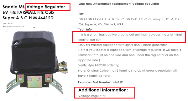

Wow - I went back and click on the image with the multiple items and got a different page saying its a cut-out - and explains the differences. hen ADDITIONAL INFO says Voltage regulator

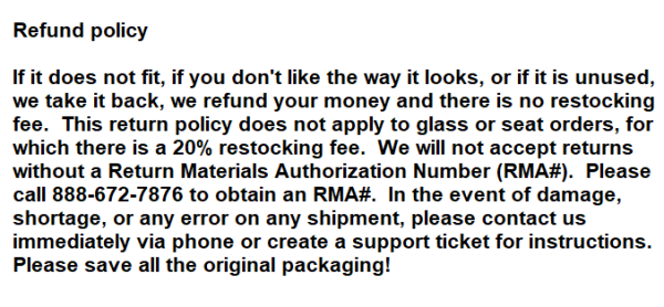

They do have a refund policy https://www.reliableaftermarketparts.co ... und-policy
