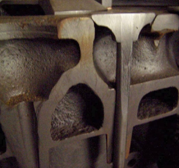

Here is pic of a two-piece valve ground away to show with a cut-a-way engine display. Shows the steel shaft and the cast iron valve head. Likely heat formed together in perhaps an electrical method. Ford did a lot of electrical welding in many processes.

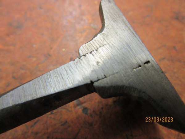

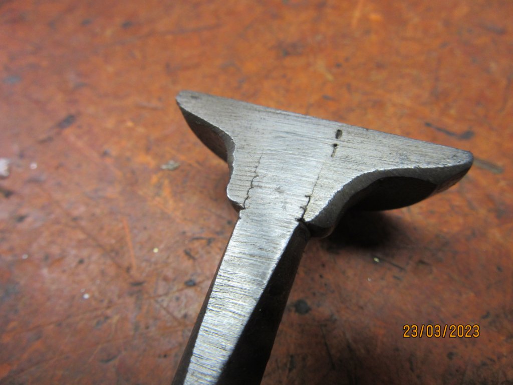

I've cut a valve in half, linished and acid etched it and it looks like the head is poured onto the stem, which has either a thread or series of grooves which deform under the heat of the pour.
Thanks everyone for your help and ideas. There's a lot of great knowledge on this forum.

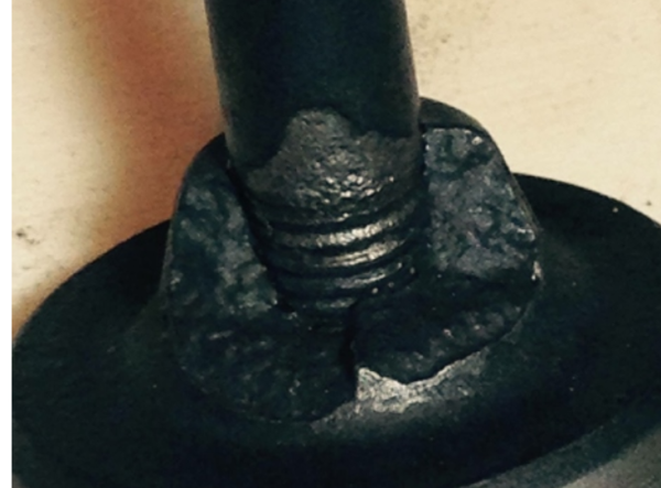

Post by ABoer » Thu Mar 23, 2023 4:47 am
This is what I find :
I don't know or it is a thread like a bolt , or just grooves ?

I broke a two piece valve in half in my car. The two pieces were screwed together

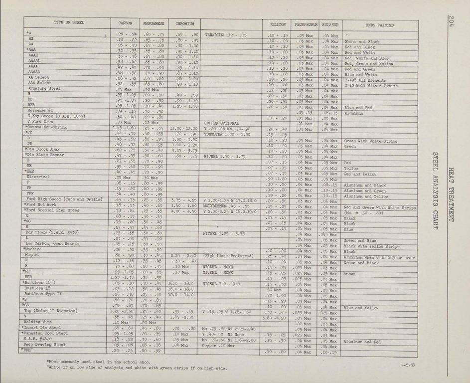

I received valve drawings from the Benson Ford Research Center. These are dated 15th January 1927.
The valve stem is cold drawn steel Type EE and the valve head is Cast Iron Grade B.
Only the stem has rolled grooves, 18 per inch for 5/8". The two items are electric welded together.
The chart is from Shop Theory - Henry Ford Trade School 1943 edition. This book is on archive.org.
