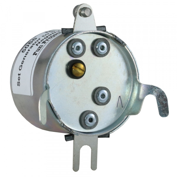

A couple of things. Do you have a known voltage regulator? If you’re unsure Take a picture of the “VR” UPSIDE DOWN & post it here before you start tinkering with it.
Don’t try to flash your generator if you think you have a VR connected to it, it won’t be a good thing for the VR. Pat has a decent idea of using a cutout to set the generator amperage if it’s a working cutout. If you get that done disconnect the battery and then install the VR completely. Now you can connect your battery again.
- Posts: 6613
Re: VR on generator

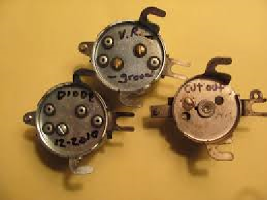

The Fun Projects Voltage regulator con be identified by the two screws & bent arrow tab (see above screw & right of the VR) on the underside. There are many different cut out configurations.
This is the Fun Projects cut-out. Only 1 screw and the arrow tab is not bent in

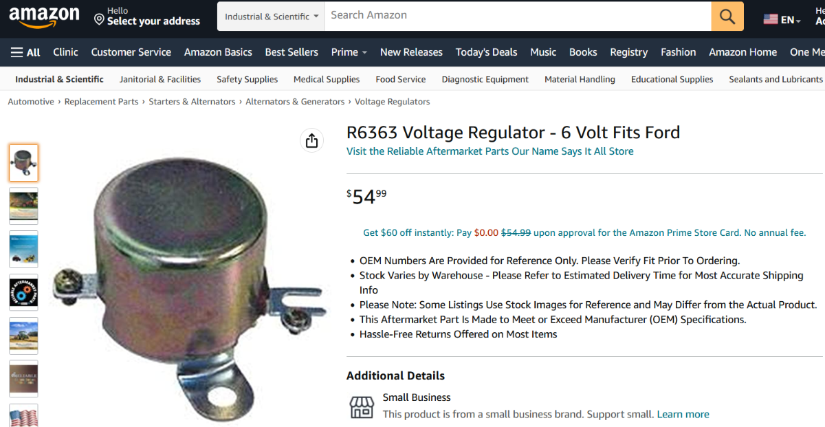

I don’t have the VR yet so I don’t know what the bottom looks like. It should arrive from amazon in the next week. It says R6363 Voltage Regulator - 6 Volt Fits Ford.
- Posts: 5305
Re: VR on generator
A true voltage regulator is a rare commodity today.

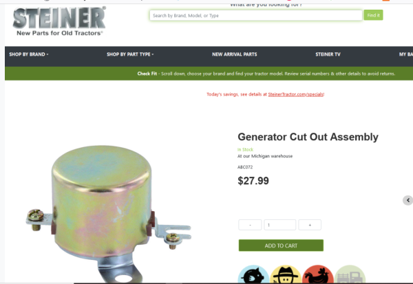

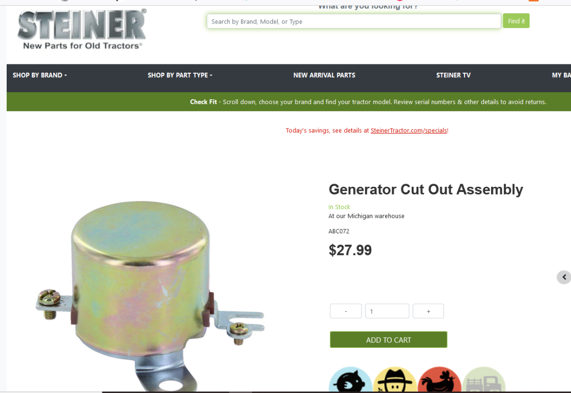

I am pretty sure thats not whats coming. It looks like a cheap manual cutout. $54.
You are better off with a diode cutout than the cheap manual replacement cutouts available.
Here is an available replacement unit. Not correct in appearance, but more reliable than a manual repop.

Regardless of what it is called, you have purchased a simple cut-out. It's not actually a voltage regulator per-se, and it is unfortunate that the company decided to market it as something that it is not...likely out of pure ignorance rather than malice.

Thank you! I guess I’ve been duped! They should not be allowed to advertise “voltage regulator” if it is a cutout. I will buy the ebay version and also set my third brush. Thanks again!
- Posts: 6613
Re: VR on generator
Don't give up yet. It may be for a Model A or Tractor. If so still usable but needs to be hooked up differently.
If it is only a cut-out you may be able to get your money back because it wasn't as described. Not sure what process AMAZON has or how yo paid.

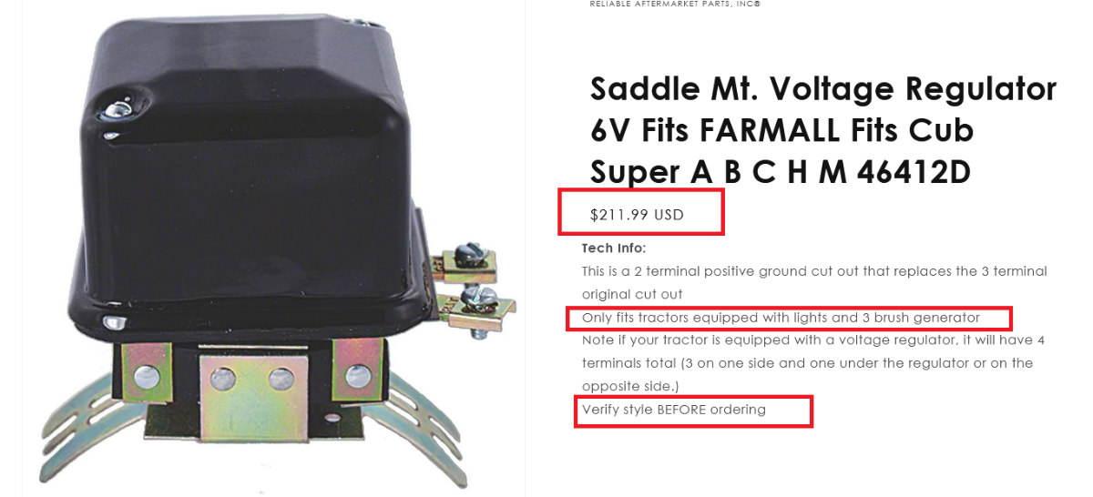

I assume this is where you got it https://www.amazon.com/R6363-Voltage-Re ... B091SNW35C --
Post a picture of it anyway and some of the instructions when you get it so we can confirm.
Please Note: Some Listings Use Stock Images for Reference and May Differ from the Actual Product.
This Aftermarket Part Is Made to Meet or Exceed Manufacturer (OEM) Specifications.
Hassle-Free Returns Offered on Most Items
But it does look like you've been duped.

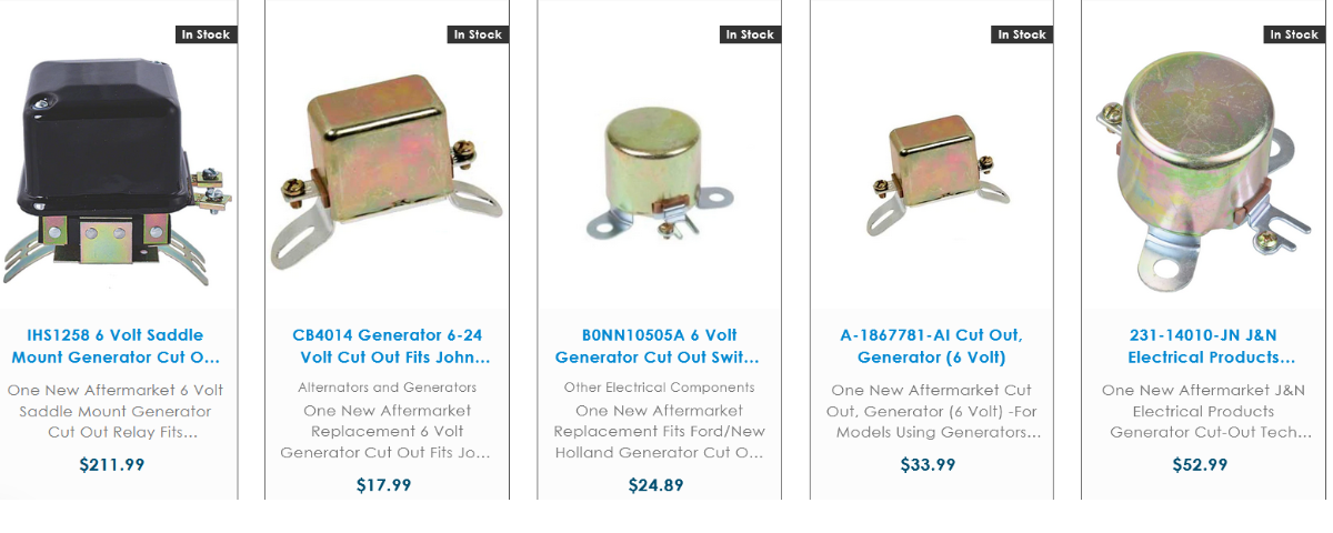

I skipped AMAZON and went to Reliable Aftermarket Parts site directly https://www.reliableaftermarketparts.co ... 0regulator
The do show your item as a cut-out --
and interestingly show a VR for a 3 brush generator likely positive ground (case may require + ground)

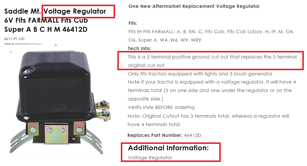

Looks like there is some confusion in the descriptions. Any non-electronic, OE type regulator will have more than 2 terminals. Any non-electronic device with only 2 terminals is almost certain to be a simple cut out.
An old style electromechanical regulator would require at least 3 terminals, usually labeled "ARM" (or "GEN") and one marked "FLD", and one marked "BATT".

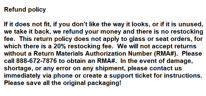

Wow - I went back and click on the image with the multiple items and got a different page saying its a cut-out - and explains the differences. hen ADDITIONAL INFO says Voltage regulator
They do have a refund policy https://www.reliableaftermarketparts.co ... und-policy
