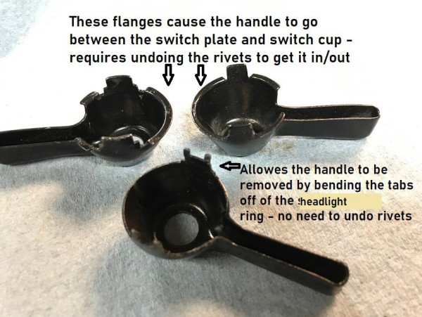

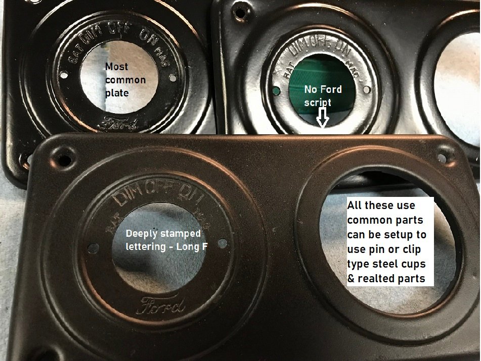

There were several manufactures of the rectangular (1919-25) switches. There are differences that in these that make restoration easy to very difficult. In general, those with just 2 rivets holding the metal cup containing the switch parts to the plate are the easiest & have some parts available for restore (the back plate, T5012, being either the pin or clip type, and the switch tumbler). The internal parts are different thicknesses for the pin & clip types. Replacing/refurbishing the back plate and cleaning up the internal parts are a relatively easy task. Replacing the tumbler or removing the switch handle can be a little difficult to very difficult (requiring removal of the metal cup & replacing the rivets).
Here are some pictures
These are the ease two rivet faceplates - they can have either a pin or clip type back. --

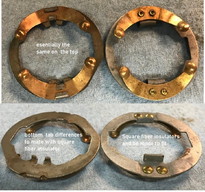

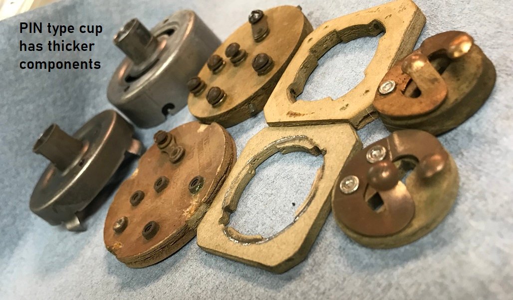

The reference to the back plate being clip or pin & the differences of the internal parts are shown here These parts fit in between the square disk and back plate & there differences relate to the switch handle differences and not pin or clip type. They should match the handle tabs. --

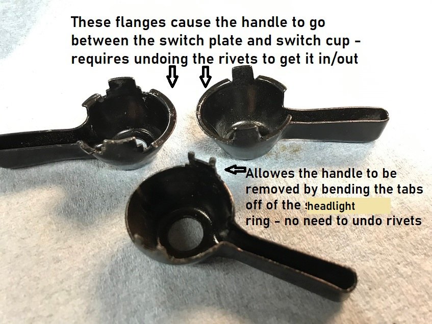

Now the way the handle is attached to the two rotating disks identifies if the rivets need to be removed in order to replace the tumbler. If you see the the handle tabs bent over the large rotating disk, then there is no need to remove the rivets --

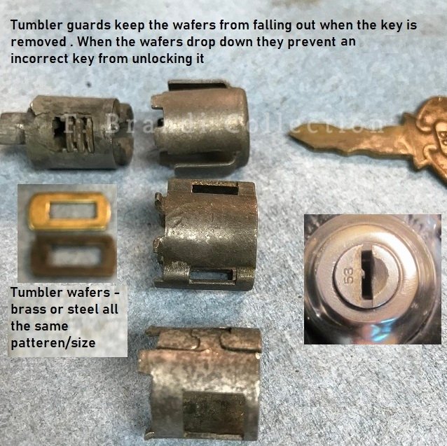

The key ID is as noted above. The original tumbler were made out of pot metal like material and often they crack. It may be the reason why it was replaced. Also these "tumblers" have wafers in them that align with the key cuts. Sometimes these fall out of position & then either any fey will work or no key will work. And yes the repro's are a bit too large and the hump on the end of the tumbler that inserts into the small disk is slight offset & fatter. The oversize issue is a result of wafer groves have a stop fro the extra material to prevent them from falling out the bottom, but not the top if turned upside own.
