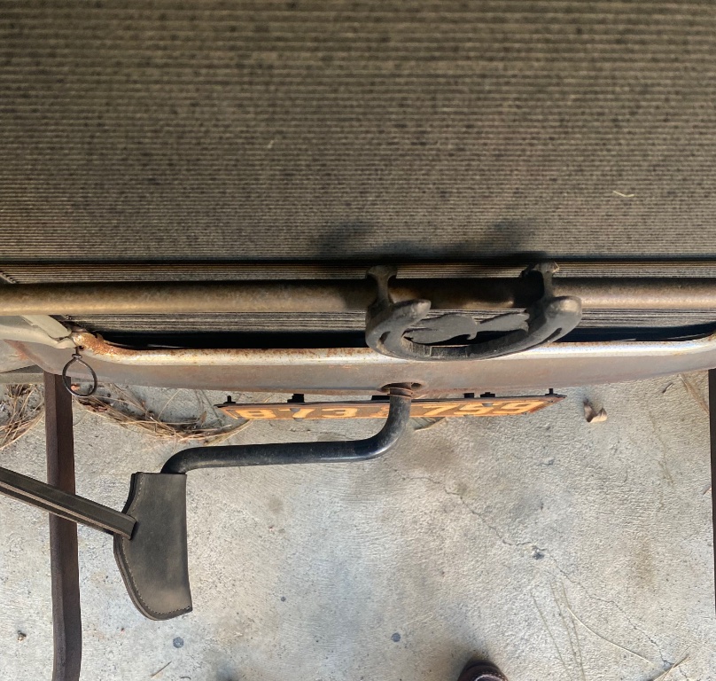

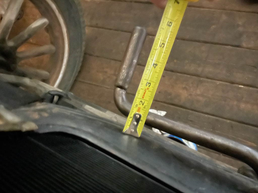

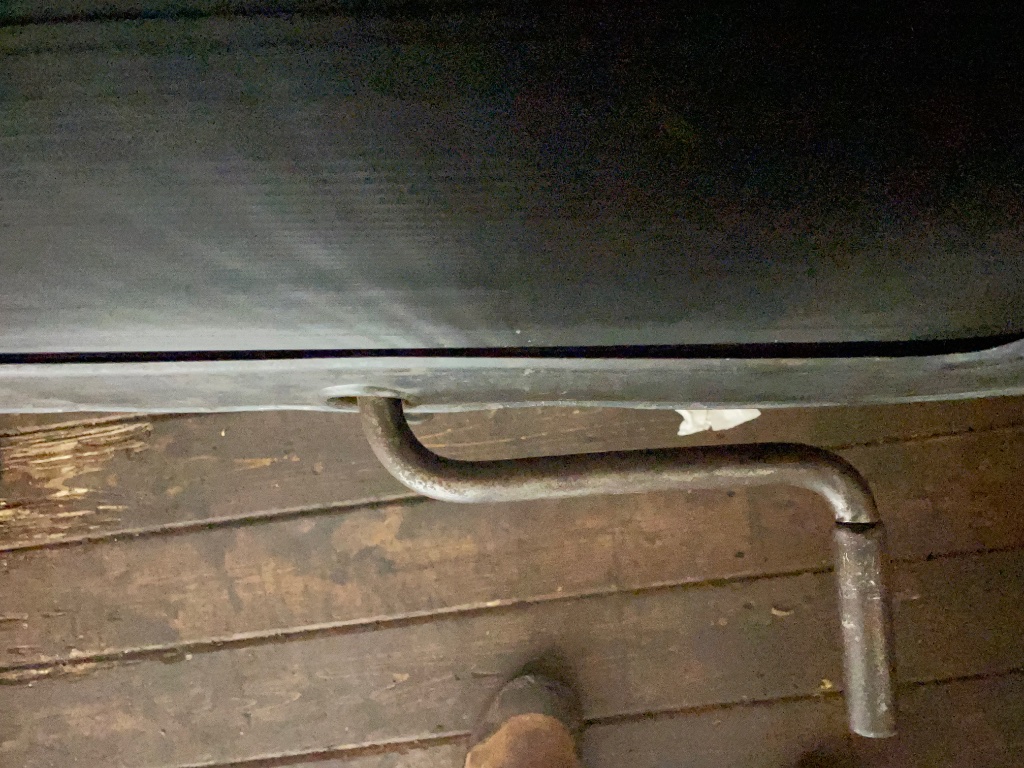

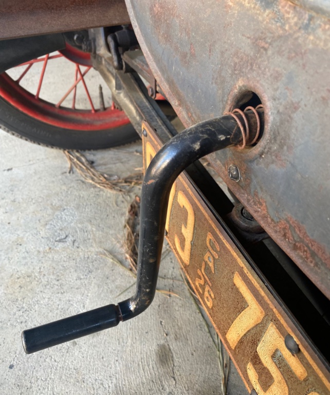

The parts book shows one crank for 09-27. Here are pics of mine on the 26TT. There is about 3/4” of clearance even with my apron bent out a bit and the crank bent in a bit. If you have a torch, heat the bend in the zone 90deg to the engine axis, and with the pinned end in a good vice, bend it out an inch.

Make sure the handle and the end go into the pan are parallel and the arm is 90*
These hang down and get hit often
