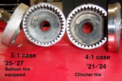

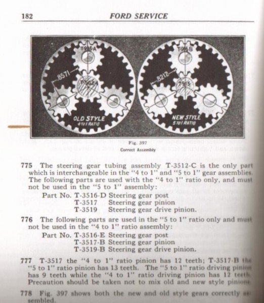

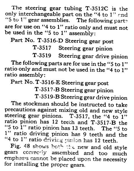

There have been many discussions about the 5:1 fitment. It would be best to provide some pictures (gears, pins, center gear & pinion gear)
Here are some pictures to verify what you have. Just to make sure you have the right parts. All three gears should be the same
Notice the differences in the center to center distances of the outer gear post to the pinon gear post -- --

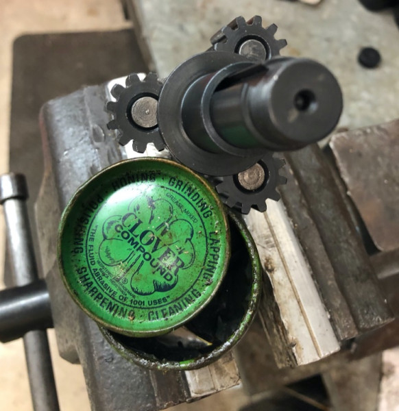

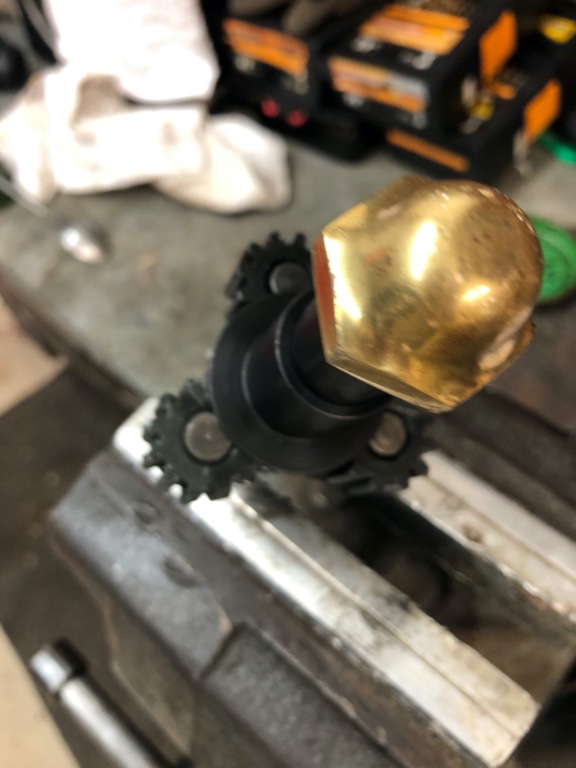

Those new reproduction gears and steering pinion are really nice, but spot on dimension and heat treated. Found that they sometime won't nest without a bit of 'running in', by lapping the gears.
So have used a smear of valve lapping compound, and spun that new steering pinion, with the gears meshed on their pinion posts. That will 'fit' the gears better, note the slight wear off of the heat treated black surface that happens when the gears are lapped.Use steering wheel nut on steering pinion, then a socket wrench and spin the assembly back and forth, clean off the compound completely, then grease 'em and ready to install.

Yep, have had that can from the '60'sJohn kuehn wrote: ↑Sun Apr 02, 2023 9:22 amHi Dan

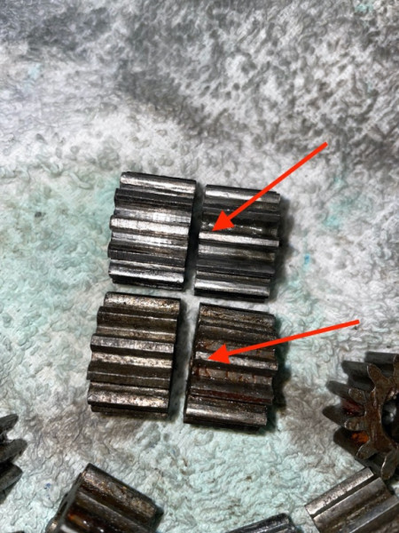

Dan - no the old 3 planetary gears are worn beyond reuse. I did buy a new stock 5:1 and yes mine look like the new stock pictures in this thread. All black coated. Will work them in with lapping ad emory. The old center gear was placed back in the car last night with the new gears - which helped the significant steering play I was having. I will work on the center gear during the week and update by next weekend. THANK YOU SO MUCH!DanTreace wrote: ↑Sun Apr 02, 2023 11:57 am
Should be ok, any fine grade lapping compound is acceptable. Just clean it off good in lacquer thinner or other solvent. That is best to lap and then rotate position of each individual gear and lap some more, that way they fit together when assembly is done in random order.
Using new is best, unless you can find NOS gears, but those are hard to find. Old gears are normally too worn for a good steering result. Sometimes you can re-use if lightly worn, using a new steering post pinion, but best to do the complete job right.

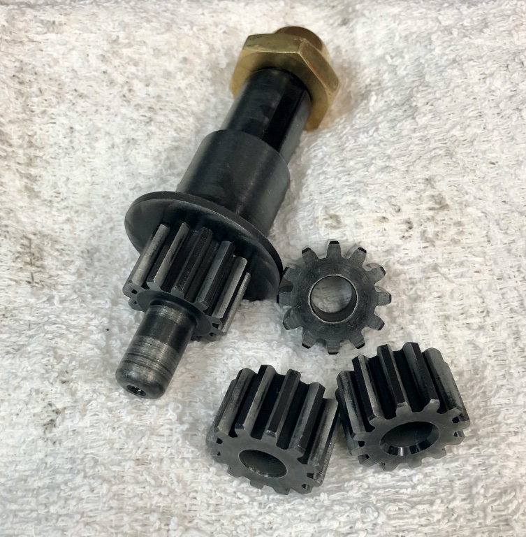

Old center gear 9 prong. New Center gear 9 prong. Old planetary gears 13 prongs, new planetary gears 13 prongs. Now that is if I counted correctly with all the grease in there....but I believe I did.
The new planetary gears are currently in the column with the old Center gear as the new center gear did not fit more than an 1/8 inch in. Therefore, I am assuming that the requirement to emery paper and lapp will work and it is truly the coating or how the unit was cut.

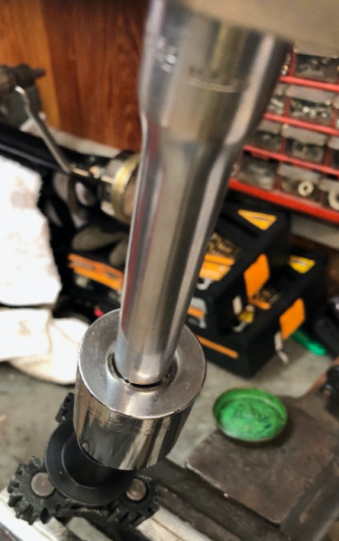

Dan. Can I do this without a vice or must it be in a vice?DanTreace wrote: ↑Sun Apr 02, 2023 9:09 amThose new reproduction gears and steering pinion are really nice, but spot on dimension and heat treated. Found that they sometime won't nest without a bit of 'running in', by lapping the gears.

Dan - yours looks like a 4:1. Correct?DanTreace wrote: ↑Sun Apr 02, 2023 9:09 amThose new reproduction gears and steering pinion are really nice, but spot on dimension and heat treated. Found that they sometime won't nest without a bit of 'running in', by lapping the gears.

Guess you could raise the steering post up out of the column/gear case, put vice grip clamp or fixture to keep it from moving, and then spin the gears with the pinion post…..but seems way too much effort and mess inside the T

Good eyes

Interesting to note is an odd number of teeth in use…sure, it is what works as ratio but at the same time...
Common practice in ‘shaper’ days was a no micrometer approach to manufacture…most especially on odd number of teeth gears.
The practice 100 plus years ago was to have an actual toolmaker produce the master mating gear to the major side of the tolerance and then mount it on a pin set jig with precision centers to the pins. The gear shaper operator would then walk his first of day run ‘in’ until the jig set was his go/no go gauge and what he was shaving slid on full…either with lash feeler or the mother gear made with the lash added…then the shaper operator lock the infeed on the shaping head. This was still common training for apprentice right up until the 60's/70's in short run shops.
Measure Over Wires became the accepted standard for gear manufacture as time went on and for anyone who has ever tried to calculate a MOW for an odd number of teeth pre-computer…that old jig way was many times faster!

WELL HELLO! Tom of the LB Club sand blasted the coating off the pinion and gears and we tested on a new shaft. ALL fit together snug snug snug. I am greasing all up this morning and putting the steering wheel back on so Fingers crossed everything works! THANK YOU ALL AGAIN.
