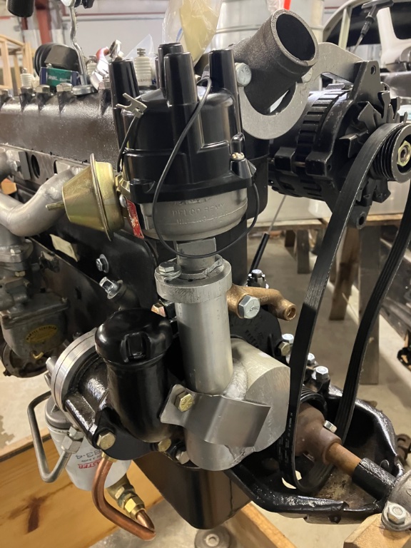

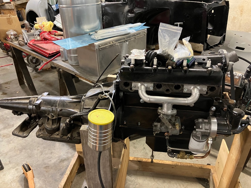

Finally have it clamped on!
A copy of a design of mine from the’80’s.
Borg Warner automatic for my wife’s speedster!

Now that's a first for me, an automatic behind a T engine, nifty setup ! ;)

I’ve probably seen half a dozen of them over the years!

I will be connecting it to the intake manifold.

I haven’t researched that yet. Running a Prus head

My previous one of the identical design has worked well for 40 years. The car is capable of 100 mph and is easy to drive (no spark management required). The 71 car it came from had it connected to the intake manifold.

Nice work Les. What did you source the distributor from? Some of the Model A guys have retrofitted a '70's Honda centrifugal / vacuum advance distributor with excellent results. However, the supply of these distributors seems to be drying up.
