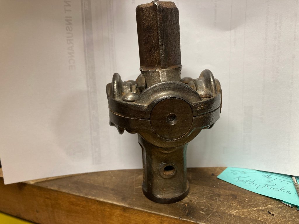

The trans driveshaft size does measure .880" X .882", I have a used U-joint that measures .860" would that be okay to use, the new U-joint I am trying to use measures .878" I could just try and mill a .0015" off each side.

Use the old one if it is servicable. Servicable would be tight rivets, and some play on the wear parts. Post a picture if in doubt.

The old one appears to be very nice, as long as the rivets are tight.

Thats a keeper. Throw away the new one and use the Ford u-joint.
