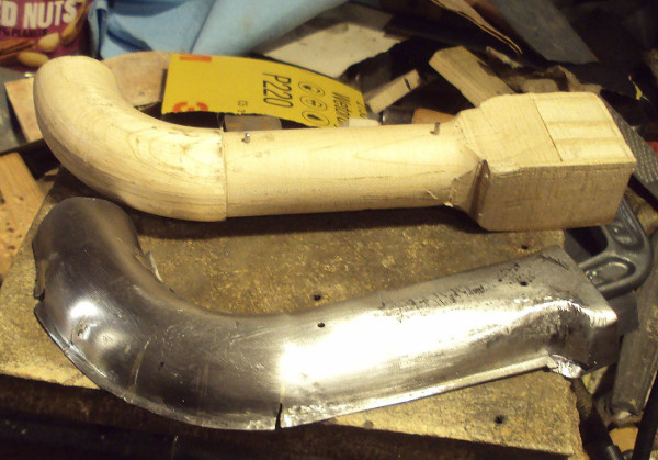

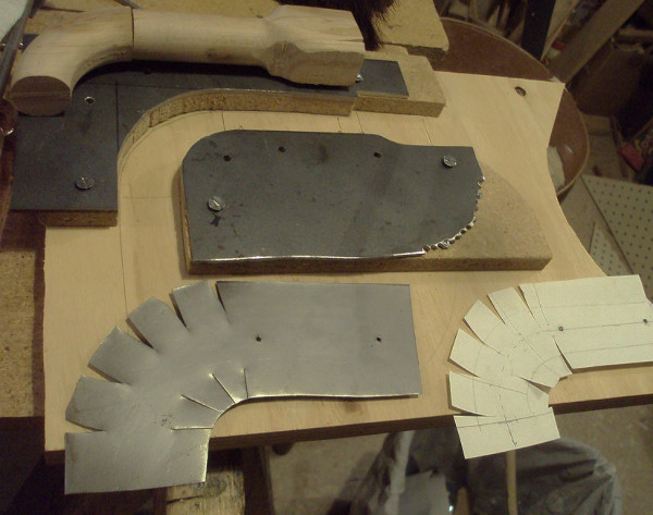

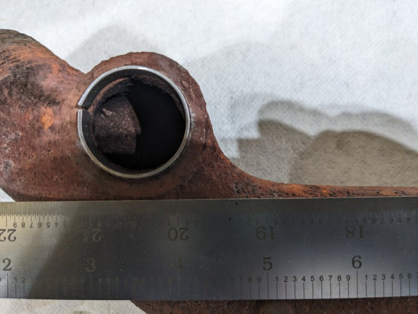

Am I First? I worked some more on the heat pipe fabrication. Here I mentioned getting started:
viewtopic.php?f=2&t=371&p=274121&hilit= ... ng#p273816
It has gotten to be more work than I had hoped. Since I don't have a giant press or steel made specifically for stamping, I have to relieve the sheet where it curves. I cut out shapes to form a trough to press the sheet into. The I used some cardboard to make a template. I used 3 c-clamps to press it. The inside wants to stretch, and the outside wants to compress. I saved the notches from the outside to trim and silver solder to the spaces on the inside. As it turned out, I needed notches for the outside too. I made some folded clips to hold the notches in place. However, the silver solder migrated up and under the clips. I had to grind them away. It did show that the silver solder flows well holds things together. I have at least 24 hours in this so far. A shop charging $50 per hour would have $1200 so far. This is only the inner half, and I want two of them. So the economics of making them is kind of silly. But my time is my own and it is cheap entertainment. Like many things, I don't know if I will continue these until completion. But it is keeping me out of trouble.

Were you intent on fabricating your own Rich ? Nice progress !
Classified ads here most always have worked for me looking for a particular part.
Topic author - Posts: 6895
Re: What have you done to your model T in April?
I'm sure I could buy one. These seamed ones are a little harder to find. I do enjoy making things and I have an original I could use but it's pitted. Filler would work. I'm using later ones that work just fine. I learn so much from trying to fabricate things. It is fun to see how close I can get to the original.
I am just using materials on hand. This just seems to be the thing to do this week.
Thanks for asking.
Thanks for asking.

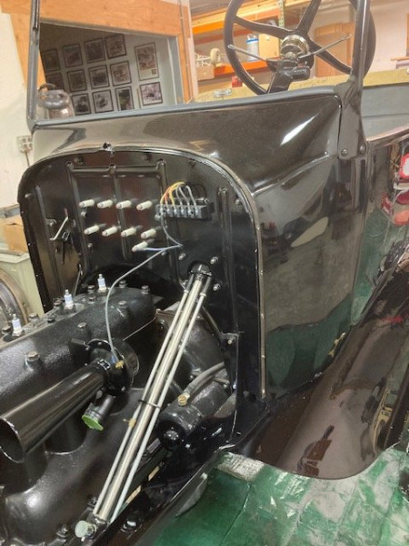

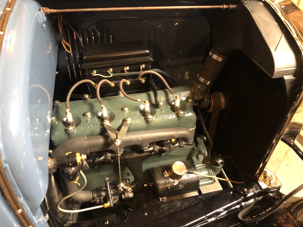

Reinstalling my engine after rebuild. Put in the 4 pan ear bolts, wood blocks, castle nuts, and cotter pins today. This job never gets easier over time. I found I could use the Stevens universal joint aligning plyers to get the verticle bolt into the frame where the starter and bendix cover block access, and used a wooden clothes pin to get the nut started on the horizontal bolt for the same ear. What a job with body and fenders on!
- Posts: 2887
- Last Name: House
Good job Jeff. I use a long 9/16” box end with duct tape on one side to lift that left side vertical bolt into place. More than one way to skin a cat

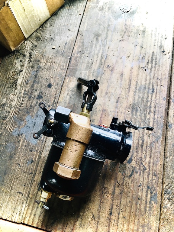

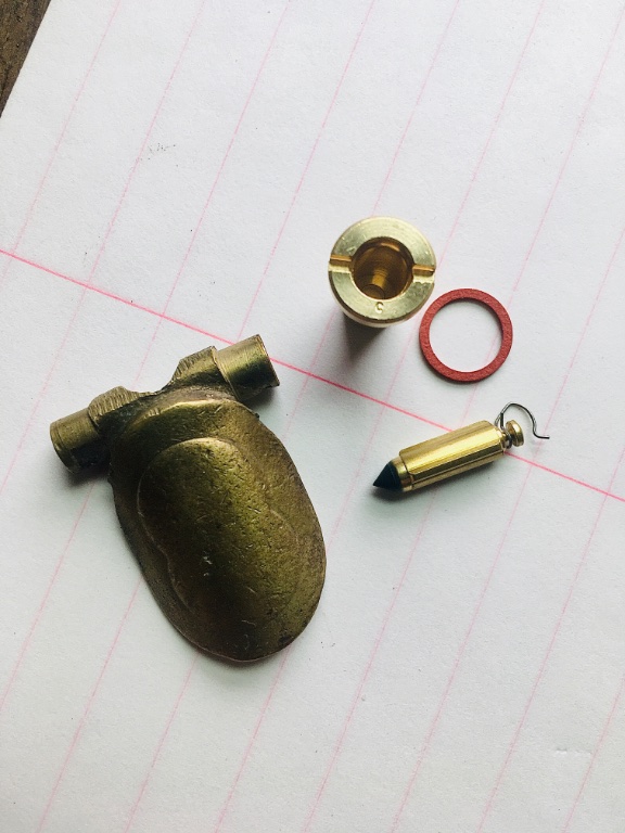

Rebuilding carburetor now, waiting on a few parts.

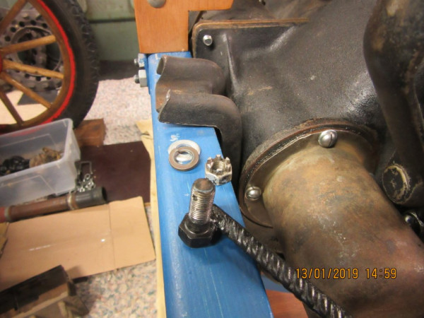

George H.
I weld a piece of metal on the bolts Toon

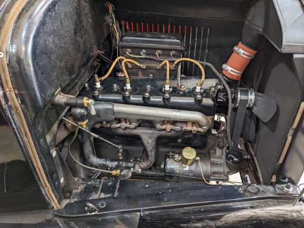

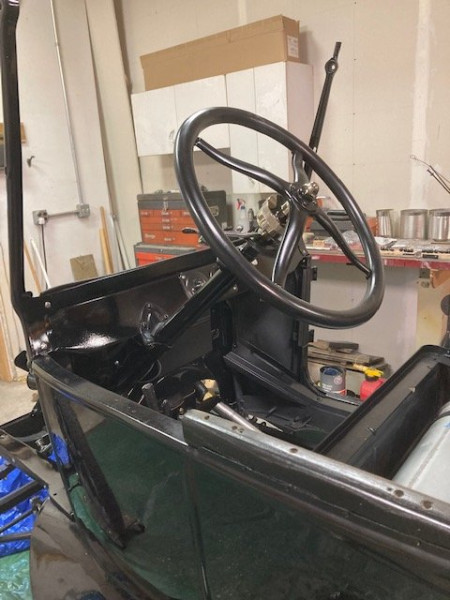

Another step closer to get it running. Installed the radiator and connected the water hoses.

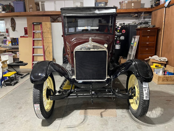

Getting close to first drive, just have to install steering and drag link.

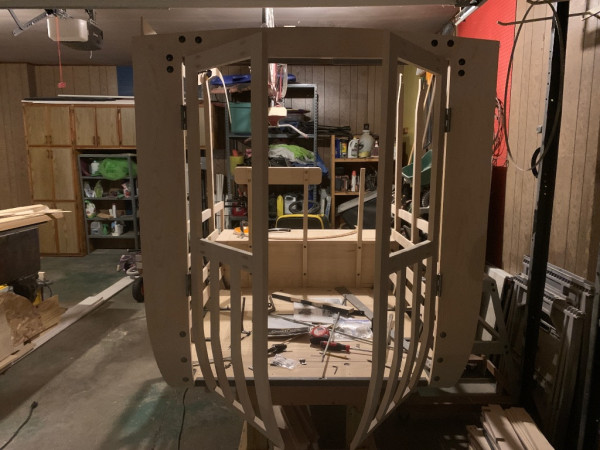

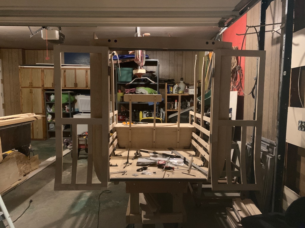

Made rear doors for the Delivery Car

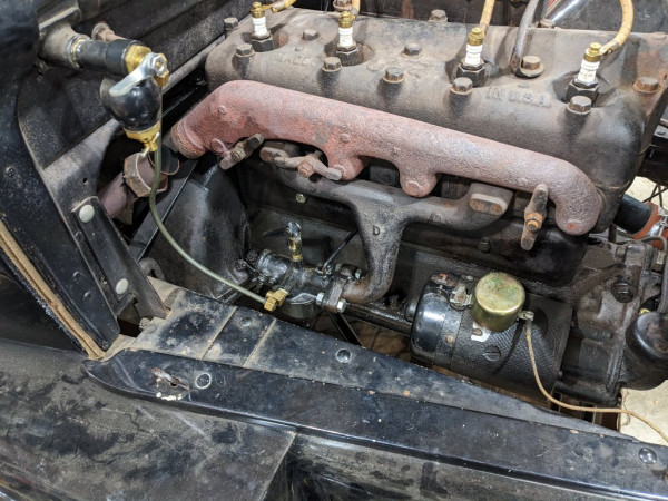

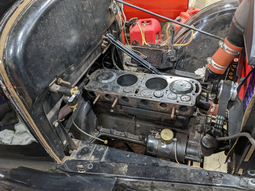

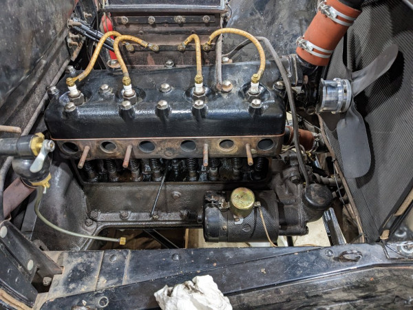

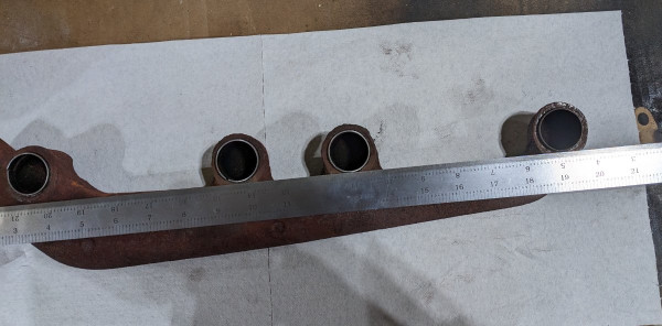

My front 2 sparkplugs were black as can be. The 2 rear were clean. I removed my intake to check for leaks or blockage and discovered that there were no gland rings in the manifolds. My intake was installed with it shifted 3/8” rearward, partially blocking ports. The exhaust manifold is warped badly and could be straightened. But Birdhaven has them in stock and I get next day delivery. I took the opportunity to replace the cracked head that was on my car with one that shows little use.
I cleaned everything and took a lot of measurements. The good news is there are no cracks, cylinders are bored .025” over and look good. (I have good compression and do not suspect worn rings.) The bad news is plentiful. I have 2-piece valves with worn guides and stems. Their replacement will be a project for next fall. I measured total valve lift using a dial indicator. Lift ranged from .170” to .189”. Yeah, that’s what I said too. Valve lash was up to .045”.
I decided to try peening the worst offending valve stem to see if I could lengthen it. I managed to add .008” after about 20 minutes of careful pounding. I guess it would take an hour to bring the lash to within reason. I did not proceed further since valves will get replaced. I put a brass spacer between the lifter and valve stem to measure cam lobe lift. The cam lifted .215” pointing to .035” of lobe wear. That needs to be replaced too. At this point, I just want to get the car running well enough to putter around this summer.

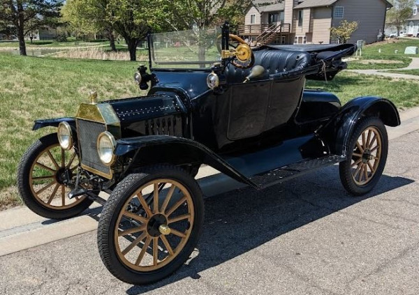

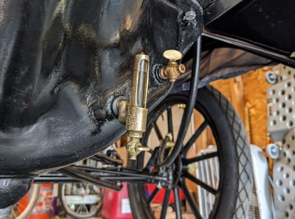

Yesterday was the 3rd anniversary of finishing the restoration of our 1915 runabout, so I had to take out for a drive to celebrate. It was windy even by Kansas standards, so I drove with the top down.
I also finished refurbishing an original aftermarket oil sight gauge that I picked up recently for $5 at an estate sale. I put a new O-ring in it as well as a 1/2" diameter plexiglass tube to replace the missing original glass gauge and installed it on our 11T. It has a decent size vent hole at the top to prevent an air lock, plus a little petcock on the bottom to drain out excess oil and also is a good indicator if it is air locked.

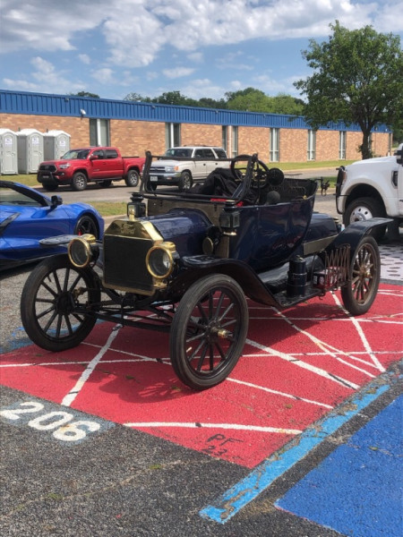

I went to the car show at the Brownsboro high school. I started it countless times to show people it’s not difficult to start with a hand crank. One woman wanted a video and I told her ok but it’ll probably never start if you do that, but it did. Kids all got to honk the horn and I took a crankshaft with rods, flywheel and field coil and disassembled transmission parts and laid them out by the car so I had a visual reference for the people who wanted to know how the 3 pedals and magneto-coils work. Then I went to get some groceries and home.

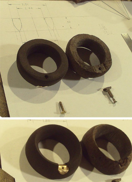

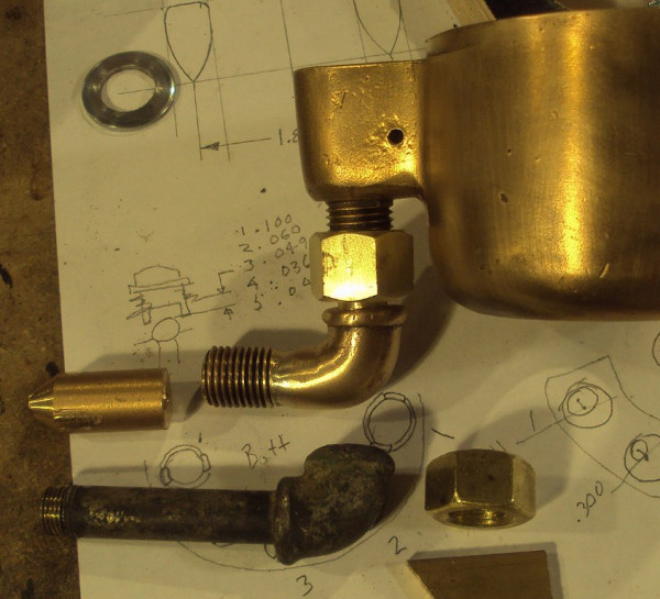

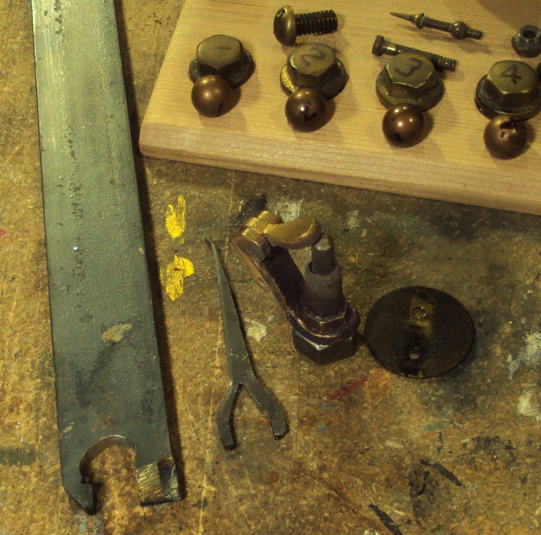

Yesterday I made wrenches to remove the tickler on my 5-ball Kingston. The lever mechanism makes reaching the hex a challenge and can't be moved until the assembly is loosened. I will make a better wrench for this before installing.

Just finished the carb rebuild and hooked up the fuel line. Installed a new muffler and exhaust pipe. New radiator hoses and fan belt. Hope to get it started soon.

I finished reassembling intake and exhaust systems, which had been installed without gland rings to properly locate them. Both manifolds had been shifted rearward with the intake 3/8” off. Wow, what a difference! My test run was on my long uphill driveway. I had been able to get into high going up but never accelerated even at full throttle. This time, it accelerated so much that I had to throttle down since I was going about 25 mph! I’m excited by the increase in torque. I drove through some nearby hills, some of which always needed low and now she just putters up hills with ease. It was a fun drive. Now I need to shift the muffler forward a bit. The new exhaust manifold position pulled the pipe partially out of the muffler and is really loud now. Maybe I will just leave that alone for now and annoy the neighbors.

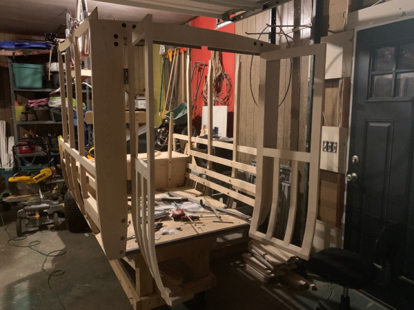

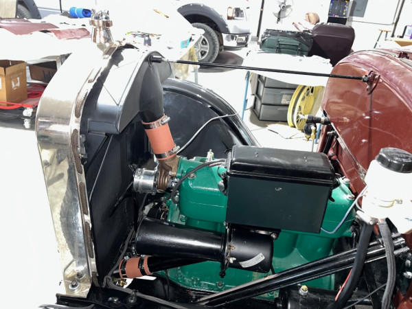

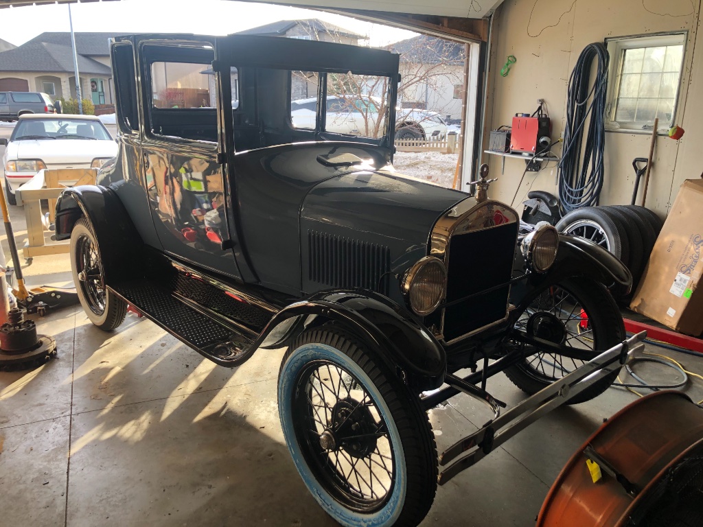

Installed the steering column and steering wheel in my 25 project today. Starting to look like a car now. There is a good section in the Encyclopedia about spark and throttle rod painting and whether or not to paint the lower part of the column beneath the hood if you are detail oriented. Says the rods should be painted and the column left alone. Looks like I am partly breaking from tradition.

I fired up my 1912 engine that the previous owner had rebuilt. He had passed away and I wound up, ultimately, with the car. He was very fastidious in his restoration. The engine had not been started since rebuild so it took some muscle to crank it, but it fired up using a 6V battery and ran nicely on battery.
However, the car would die when switched to magneto. I went through all the various checks, and that included pulling the magneto post off the hogs head where debris can collect and cause problems. As I lifted the magneto post off, a philips head screw dropped out of the post spring. Apparently, it had somehow gotten dropped in the crankcase somewhere along the way. I am thinking this is the root cause of my magneto not working-not a good thing to have hardware rattling around loose in the crankcase. So....an engine pull is in my near future. Very near, as I want to get this car back together.
The moral to this story is to heed the admonition in the Ford Service Manual, and I loosely quote: "EXCERCISE EXTREME CAUTION TO PREVENT DROPPING OBJECTS INTO THE TRANSMISSION." Another moral is to follow my buddy's advice, which was to "pull the engine and check it out before you start it." Maybe I would have noticed this screw, maybe not. But probably would have. Oh well, one step forward and one and a half steps back. Some days are just like that.

Fiddling with the Kingston L-4. Cleaned it up inside and out fixing what needed fixed. Found the missing parts in the classifieds! Even a nice accessory fuel filter! Found what I call a “tongue flapper” on the Tbay appears to be NOS. And to wake it up added a Conger full float valve! Can’t wait for the day to bolt it on a start her up for the first time.

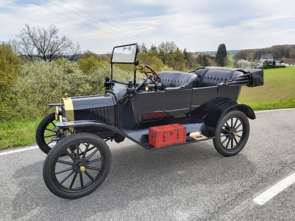

My wife and I took a drive this afternoon in our 11 touring. While waiting for some traffic before turning right, here comes a 1929 Model A pickup truck passing us by. What are the odds. We followed him for about a mile before we parted ways.

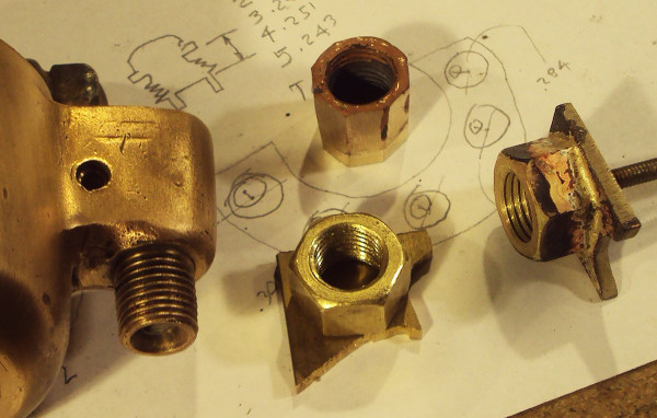

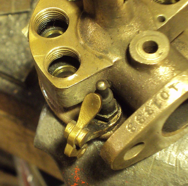

I made the gas line fittings for my 5-ball. The street elbow was round stock threaded into an elbow and soldered in place with the pipe nut threads machined. Then filed to shape.
The coupling nut was made from a 1/2" brass nut. The threads on the carburetor bowl are about .526 dia 18 tpi. A 1/4" NPT (18) tap was threaded all the way through the nut from one side and then the other. This made a nice fit. Then a brass plate was soldered onto the end and cut and filed to match the hex. The adapter inside the coupling nut was machined from some brass bar. Things don't always go as planned. The first nut I made turned out to be an 8 sided hex. Upper center in second photo. I did learn what I needed to know by making it.
I was pleased that this was accomplished by tools and stock I had on hand. I imagine those fittings are pretty hard to come by. Perhaps someone is making them.Rich
