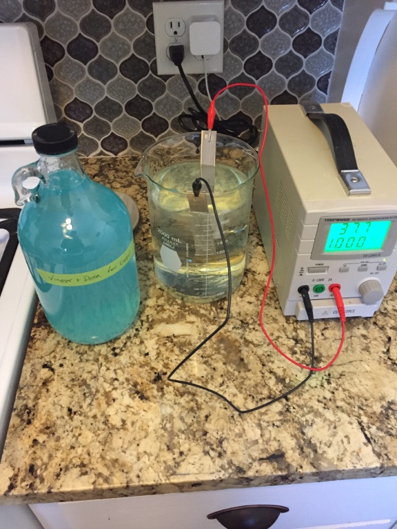

Kevin Pharis
- Posts: 1656
- First Name: Kevin
- Last Name: Pharis
- Location: Sacramento CA
Re: Do it yourself plate of small items. Recommendations
I’ve set up for small scale copper and nickel using vinegar. This works for hardware sized parts, stronger acids are said to work better on larger parts…
