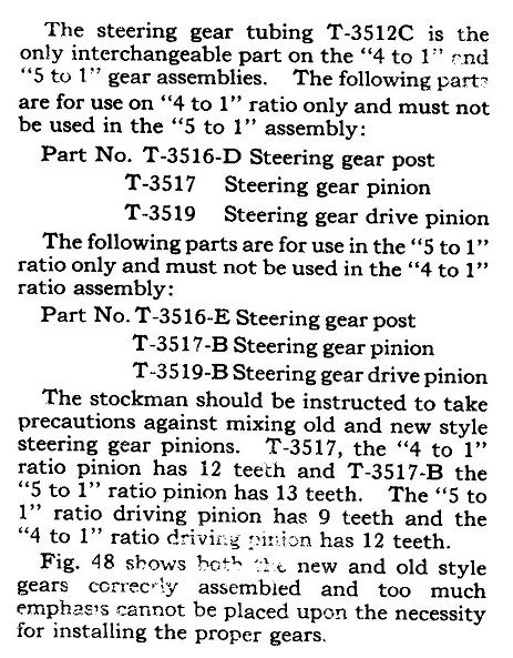

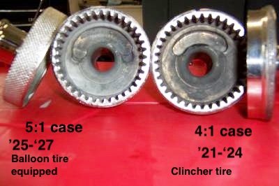

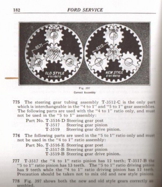

There have been many discussions about the 5:1 fitment. It would be best to provide some pictures (gears, pins, center gear & pinion gear)
Here are some pictures to verify what you have. Just to make sure you have the right parts. All three gears should be the same
Notice the differences in the center to center distances of the outer gear post to the pinon gear post
late and early case with groove .jpg (28.88 KiB) Viewed 5257 times

The 27 coupe should have already had 5:1 gears, so mis-fit is not due to a mis-match of parts. Cleaning up the planetary gears, swapping them on the pins, cleaning up the centre gear and shift, may all help to achieve an acceptable running fit.

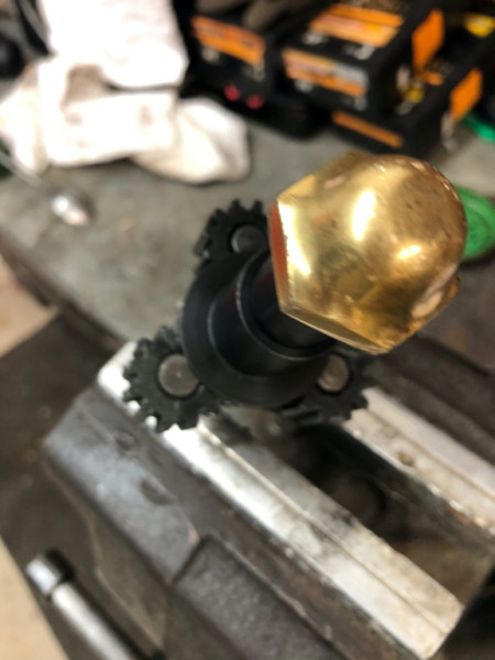

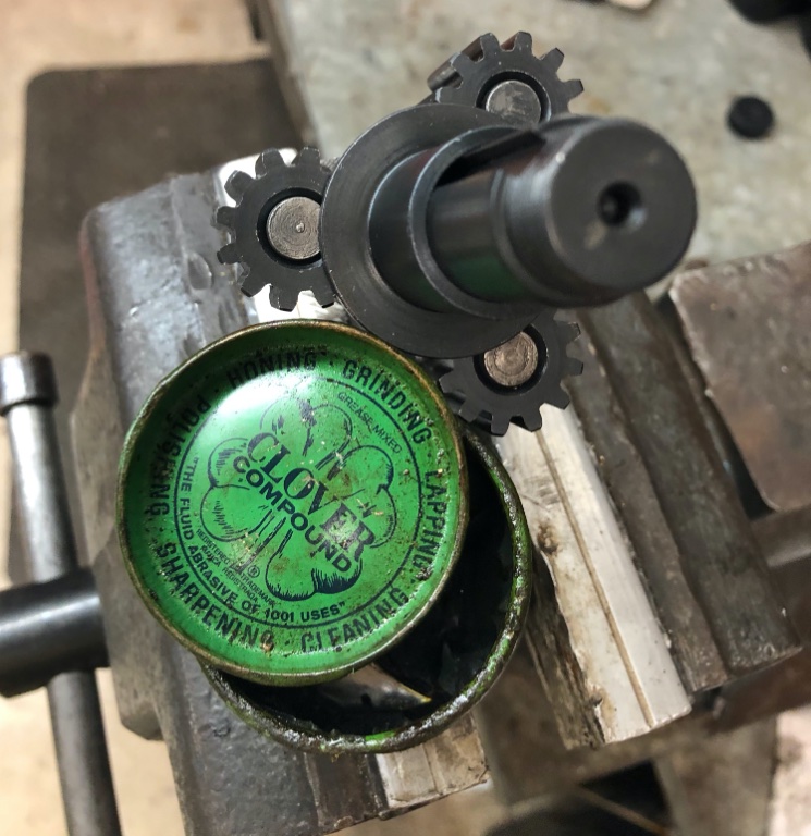

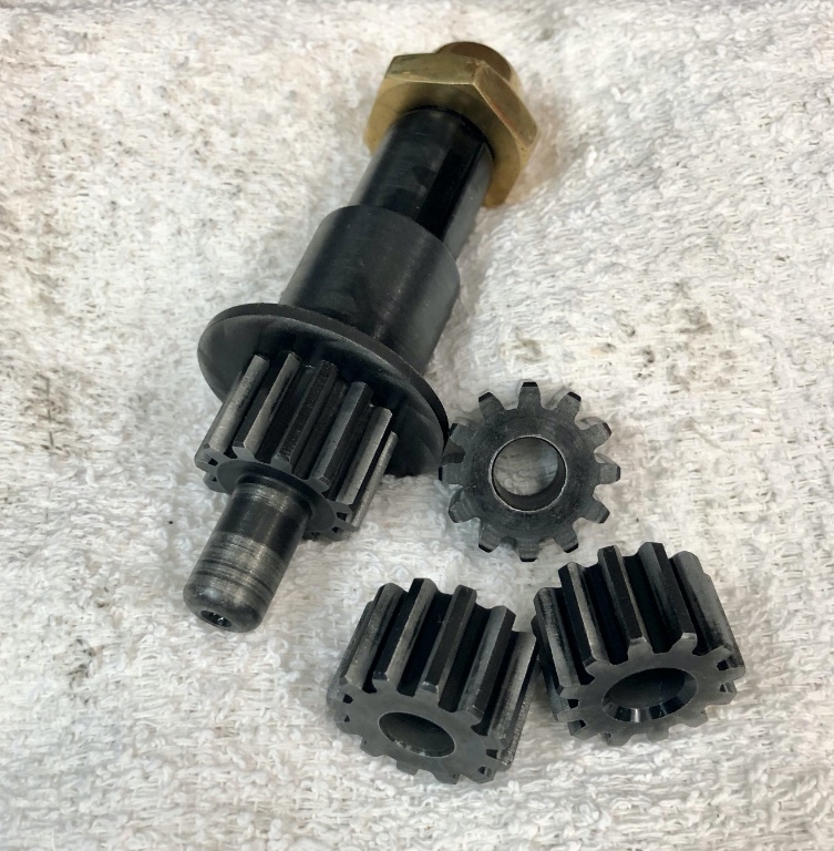

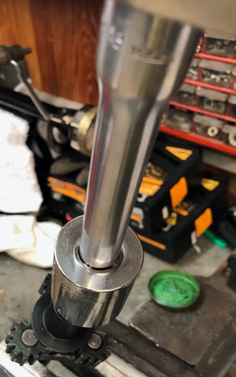

Those new reproduction gears and steering pinion are really nice, but spot on dimension and heat treated. Found that they sometime won't nest without a bit of 'running in', by lapping the gears.
So have used a smear of valve lapping compound, and spun that new steering pinion, with the gears meshed on their pinion posts. That will 'fit' the gears better, note the slight wear off of the heat treated black surface that happens when the gears are lapped.Use steering wheel nut on steering pinion, then a socket wrench and spin the assembly back and forth, clean off the compound completely, then grease 'em and ready to install.

Hi Dan
I’ve looked for Clover lapping compound in this area and the auto parts stores don’t seem to have it anymore. Maybe I didn’t look close enough. It was pretty common to find but seemingly not now in the last few years.
I have a can of it like you have but I’ve about used it up. Bet you have had that can a while.
Thanks!

John kuehn wrote:
Sun Apr 02, 2023 9:22 am
Hi Dan
Thanks!
Yep, have had that can from the '60's :lol: You can still find partial used original green metal cans of it on eBay, about $25!
Or buy the new white can, the brand is now owned by Locktite.

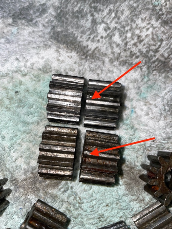

Should be ok, any fine grade lapping compound is acceptable. Just clean it off good in lacquer thinner or other solvent. That is best to lap and then rotate position of each individual gear and lap some more, that way they fit together when assembly is done in random order.
Using new is best, unless you can find NOS gears, but those are hard to find. Old gears are normally too worn for a good steering result. Sometimes you can re-use if lightly worn, using a new steering post pinion, but best to do the complete job right.
Frank - thank you. Agreed there is no chance on the 4:1. I will work with the proper unit and adjust accordingly! Appreciate all advice!!!!
Dan - no the old 3 planetary gears are worn beyond reuse. I did buy a new stock 5:1 and yes mine look like the new stock pictures in this thread. All black coated. Will work them in with lapping ad emory. The old center gear was placed back in the car last night with the new gears - which helped the significant steering play I was having. I will work on the center gear during the week and update by next weekend. THANK YOU SO MUCH!

Using Clover compound on a case is fraught with trouble. Clover silicon carbide will embed into the bronze and provide a scouring action for many many moons long after the excess has been cleaned out.
A far safer choice in the case is Timesaver's (Green) Fine or Medium compound which will not embed and will continue to break down as it is used - it will cut for awhile and start to polish as it breaks down: https://ws2coating.com/timesaver-lapping-compounds/

Old center gear 9 prong. New Center gear 9 prong. Old planetary gears 13 prongs, new planetary gears 13 prongs. Now that is if I counted correctly with all the grease in there....but I believe I did.
The new planetary gears are currently in the column with the old Center gear as the new center gear did not fit more than an 1/8 inch in. Therefore, I am assuming that the requirement to emery paper and lapp will work and it is truly the coating or how the unit was cut.

DanTreace wrote:
Sun Apr 02, 2023 9:09 am
Dan. Can I do this without a vice or must it be in a vice?
Dan - yours looks like a 4:1. Correct?

Scott_Conger wrote:
Sun Apr 02, 2023 4:09 pm

lirogo27 wrote:
Sun Apr 02, 2023 7:10 pm
Guess you could raise the steering post up out of the column/gear case, put vice grip clamp or fixture to keep it from moving, and then spin the gears with the pinion post…..but seems way too much effort and mess inside the T

lirogo27 wrote:
Sun Apr 02, 2023 8:53 pm
Good eyes ;) Yes, that was a new set of 4:1 gears for a ‘24 which uses 31” clincher tires.
