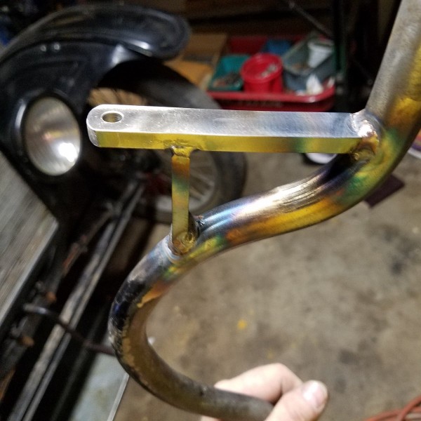

If the geometry is visualy that far wrong you spot it on install
Heres my left hand shift put the front pivot same location as stock center shift L&R except 4" closer
