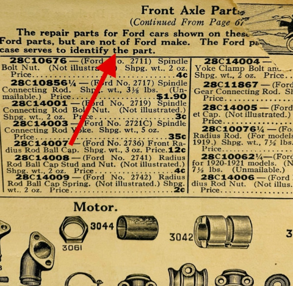

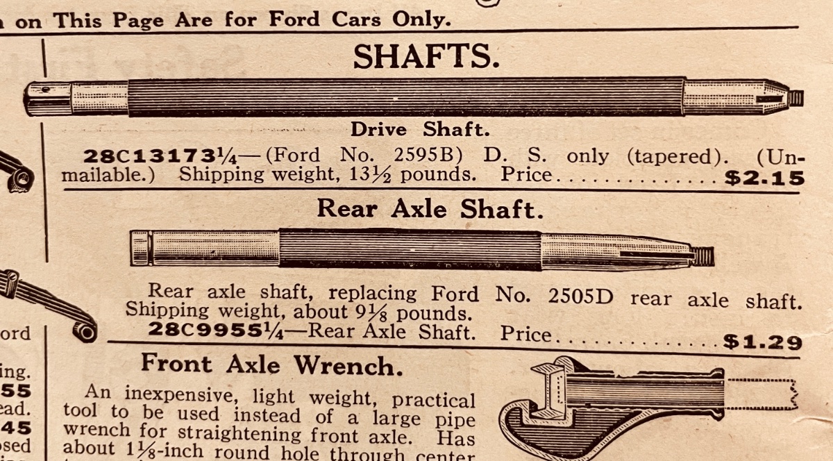

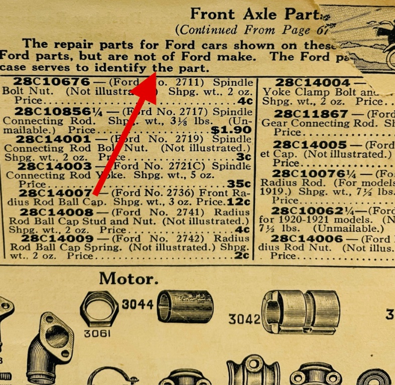

Spurious Parts :shock:
Posts: 4489
Re: Driveshaft question
Post by Jerry VanOoteghem » Tue Apr 18, 2023 11:55 am
DanTreace wrote:
Tue Apr 18, 2023 11:52 am
... Of dubious quality! ;)
