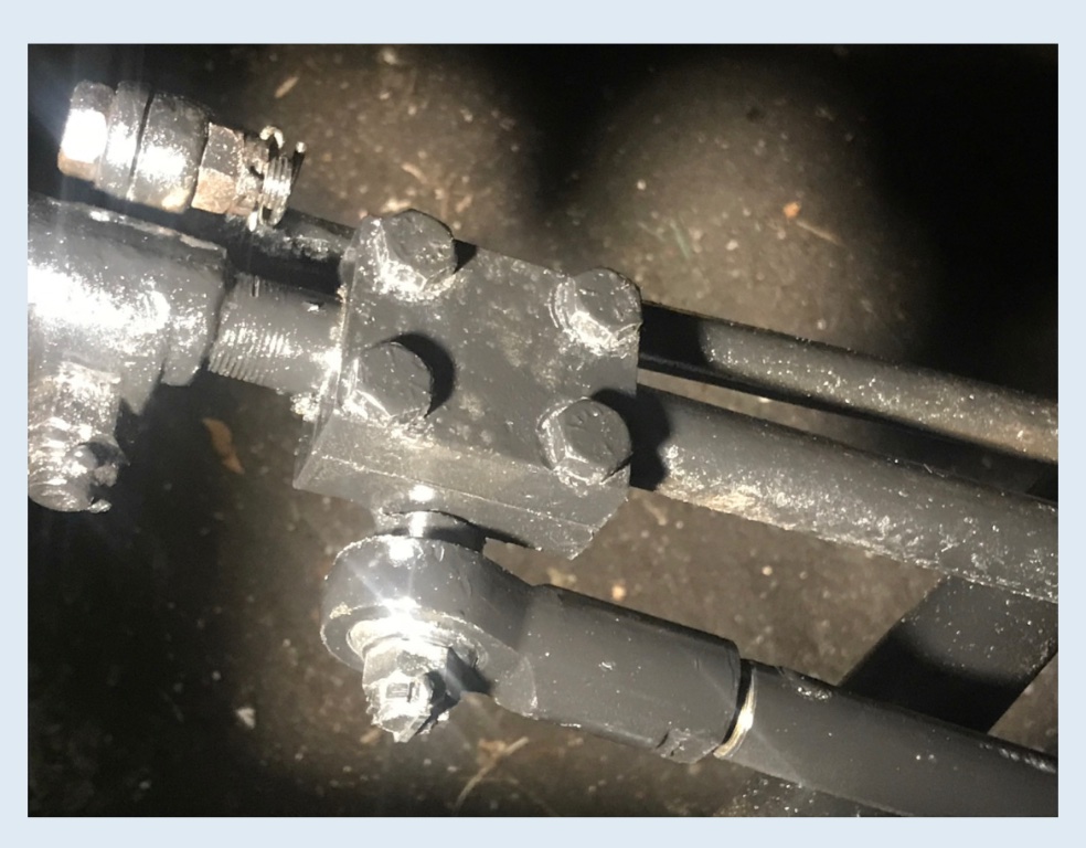

This is a project I've been thinking about for a while.
Allot of the roads where I live are pretty rough so I decided to install one of the steering dampener cylinders on my roadster. It worked well but soon began to leak and whenever I went over a bump the metal tube dust shield on the cylinder would make a crashing or ringing sound... I don't need any more weird sounds to worry about. So I had this old Houdaille type shock kicking around that still works just fine. I made a connecting rod and a clamp to connect it to the tie rod, welded up a bracket to mount the shock to the side of the frame. Someone already tried to tell me "That's just a band aid for bad bushings or misalignment"... Nope my bushings and alignment are just fine, this wouldn't help bad bushings, the only way it can work is if everything else is in good order, if there's any looseness in the system you'll still feel it at the wheel. One reason I know that is because while installing this I found the arm on my Left spindle had worked loose which is why I thought the other cylinder had completely failed, there was no dampening effect. I cleaned tightened and re cottered the spindle arm. Now, no clanging sounds and I can mostly let the wheel go on a straight drive and it almost drives it's self. I'm probably going to make one change by extending the connecting rod to reach all the way over to the passenger side near the clevis so the weight of the clamp isn't vibrating and working up and down near the middle. Actually looking at it again I'm probably going to delete the clamp and make a slightly longer ball joint bolt... whatever it's called... Bolt the stabilizer rod on the opposite side of the clevis where the steering rod connects.

The tie rod clamp I made is far superior to the U- bolt clamp that comes with the cylinder you can buy. I made it with 2 pieces of 1/2" steel plate with a 5/8" hole drilled between them on my lathe. 4 5/16-24 bolts holding it together and the pin that connects to the 1/2" swivel joint welded to one side but stepped to bring it closer to center. It can be clamped good and tight but will never deform the tube of the tie rod. I know plenty of people who have the U- bolt clamps on their tie rods, never heard of any of them breaking a tie-rod. This is also an adjustable shock and I have it turned down petty low... It doesn't need a super powerful resistance to do it's job. It's not creating any more stress to the system than I would be if I were constantly adjusting against road conditions.Scott_Conger wrote: ↑Sat Apr 15, 2023 9:37 pmand when it breaks the tie-rod, it WILL drive itselfI can mostly let the wheel go on a straight drive and it almost drives it's self.
seen it twice and don't need to see it a third time
my motto is "when you need to be creative, do it on things that aren't apt to kill you"
"when you need to be creative, do it on things that aren't apt to kill you" If the Right Brothers had that philosophy, we wouldn't know their names today.

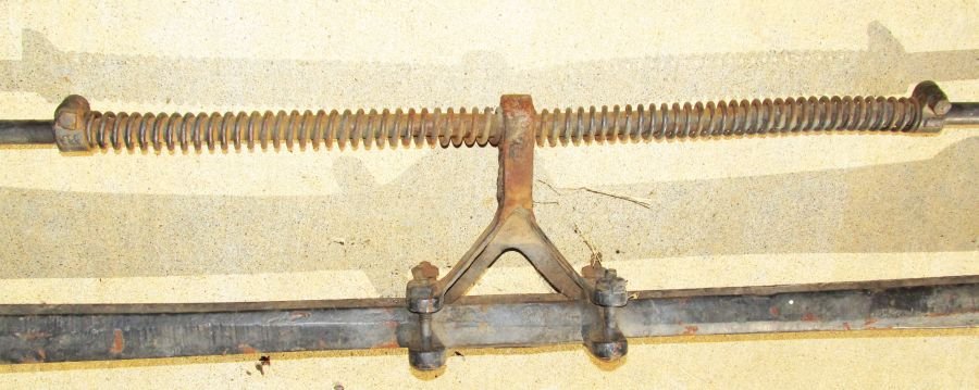

- Posts: 6587
Re: MySteering Dampener Ider
The steering dampener (hydraulic steering stabilizer) in the recent posting is not a screen door stabilizer. It is one designed for the intended use, was used on a VW and other cars as well --speedytinc wrote: ↑Sat Apr 15, 2023 8:58 pmThere was a recent posting where the use of one of those screen door stabilizers.
What I learned was the extra strain on the tie rod has caused potentially catastrophic front end component failures.
I would think this snubber contraption could create similar failures.
You may have thrown a match into a can of gasoline with this post. We shall see.
another period correct option - will return the wheel to the neutral position - spring dependent

"The idea to connect the steering dampener as far to the right is a good idea with the dampener mounted to the frame"...
I believe you'd want to make the link between the Houdaille and the drag link as close to the same length as possible, and have them run at as close to the same angle as possible. I'd think also that you'd want to adjust the Houdaille to a fairly low damping rate to keep a good steering feel and avoid too much torque on the frame rail.

Yes, I have moved the clamp and made a longer rod to reach over to the clevis, I intend to eliminate the clamp and make a new ball joint for the steering rod with longer shoulder and threads so I can attach to the front of the clevis at the same point as the steering rod. I have the shock set pretty soft, it doesn't need much.TXGOAT2 wrote: ↑Sun Apr 16, 2023 4:58 pm"The idea to connect the steering dampener as far to the right is a good idea with the dampener mounted to the frame"...

Re: My Steering Dampener Idea
I have moved the tie rod clamp to about 2" from the clevis on the passenger side, I intend to eliminate the clamp when I have time to make a new ball joint for the steering rod with longer shoulder and threads so I can connect to the exact point as the steering rod but on the front of the clevis. Any suspension height difference is moving 90* to an aprox 4' long control rod with ball joint swivels at either end... No different than the original steering rod, so no likelihood of "self steering"TXGOAT2 wrote: ↑Sun Apr 16, 2023 11:57 amThe point has been made repeatedly that a Model T in good condition does not need a steering damper, and is better off without one. It's a valid, proven point. Your car; your choice, but consider that any steering damper will add unsprung weight and will add friction to the system. Under some conditions, it will re-direct normal road forces in ways the steering system and its parts is not designed for. It adds potential failure points to a critical system.
Adding a steering damper that is mounted between the frame and the tie rod might not be a good idea. I'd think it would cause the car to self steer as the axle assembly went through its normal and considerable range of motion relative to the frame as the car went over road irregularities
This is the image of Tony’s modification, it does appear to be a substantial mount & nicely done. That said my concerns are not with the workmanship but rather the long term experience within the club of these devices.

I'd put a 1/8" radius at each end of the block where it contacts the tie rod/drag link and chamfer all square corners.
