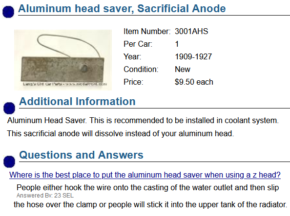

- Posts: 6609
Re: Aluminum Z Head Corrosion
Anode Insurance $10 plus Shipping
- Attachments
- anode.png (76.68 KiB) Viewed 3282 times

Who offers the one shown above for $9.50?

LANG's, SNYDER's, and CHAFFIN'S, all carry the anode.
